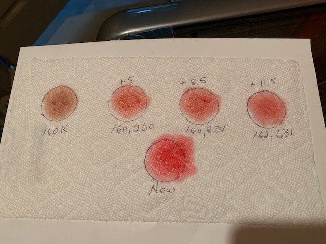

    Bought my 2013 new and never touched the tranny until 160K. Dropped the pan, cleaned magnets & replaced strainer. Did 2 more drain & fills. (see progression in pic)
    I do have the factory tow package and tow a boat quite a bit. Tranny still performs great and just hit 203K.
