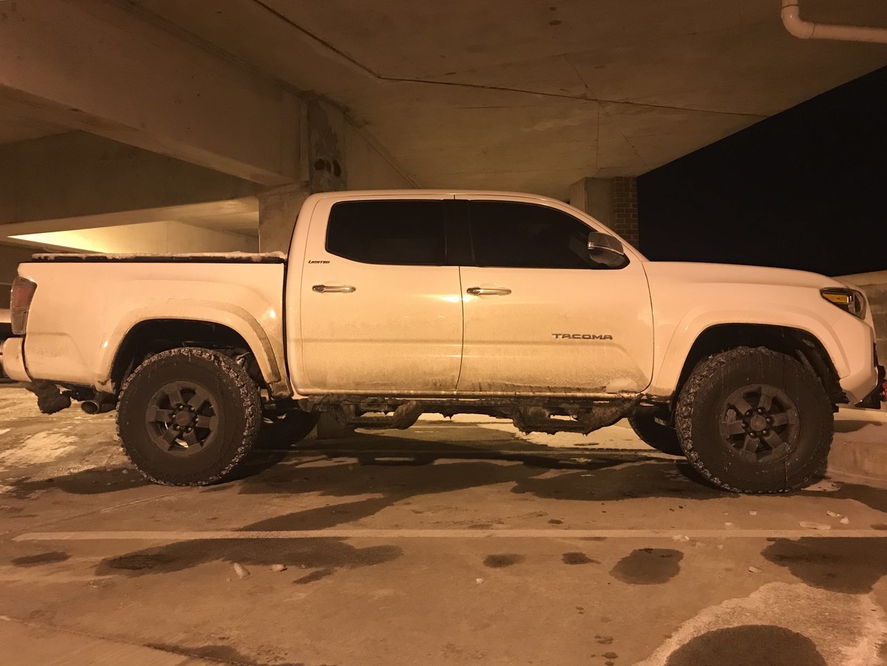

    A picture is worth a thousand.....

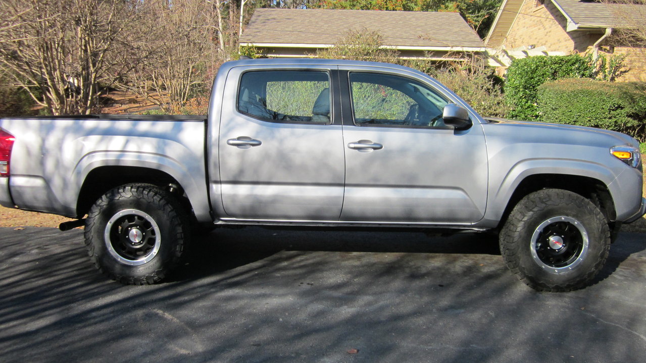

    I chose not to lift because of potential warranty issues. I went with 265/75/16 BFG K02's and gained an additional 1 inch ground clearance with no rubbing or modifying the fenders.New tires 006.jpg
