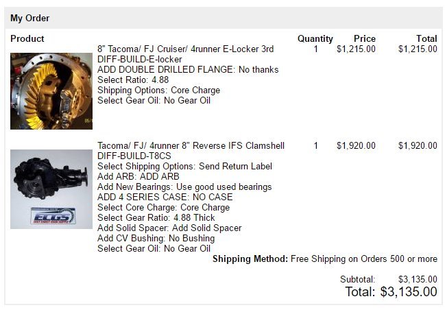

    Below is my invoice. I did get the free compressor from them and will get a $950 reimbursement when I return my cores.
    So I will have spent $2185 without labor as I am doing it myself, with help from the local TW guys ;)
