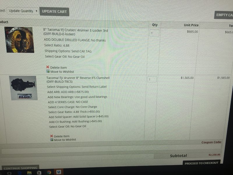

    That's the same setup I have in my cart but with core charges, oil and new bearings.
