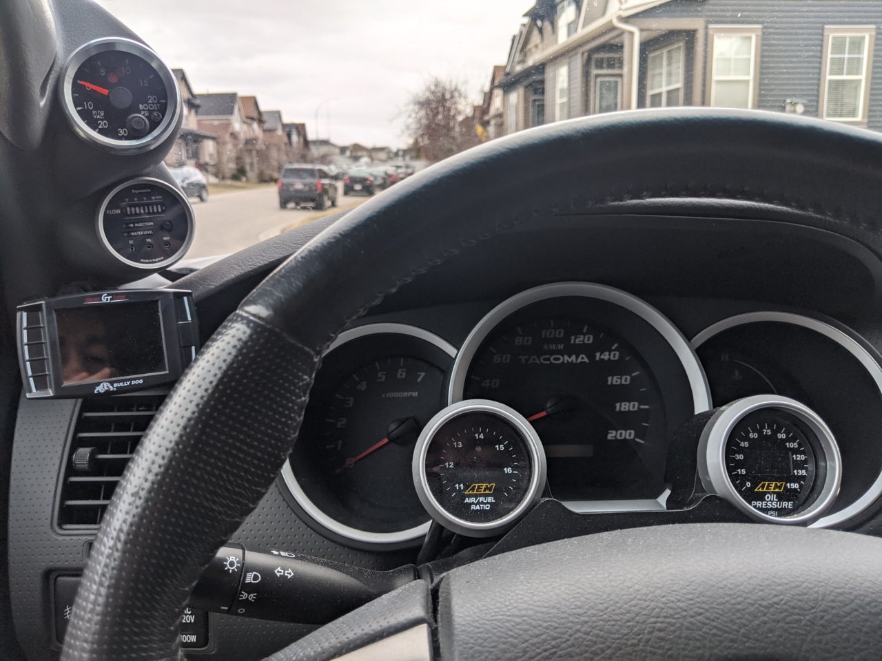

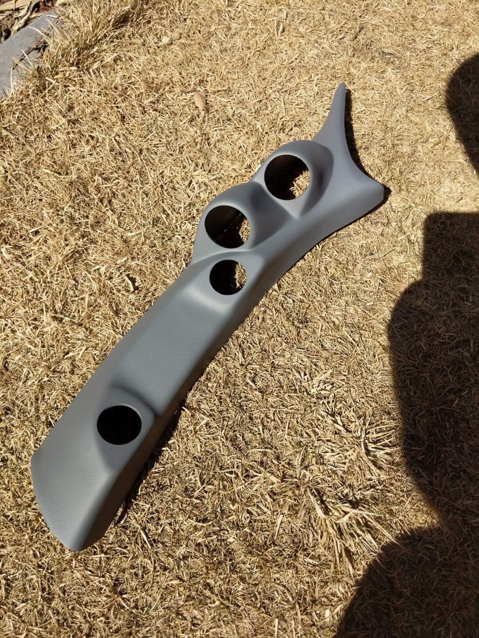

    Just got this and I finally ordered a boost gauge so I'm excited to get that and the Aquamist gauge in the pillar. Have a studded ball clamp for the bullydog gauge that I'll probably run off the pillar as well.
    It'll be really nice to clean up a bunch of the existing wiring and the gauges as well.

    For good luck I've now got this guy looking over me. Praise peeping tom jeebus

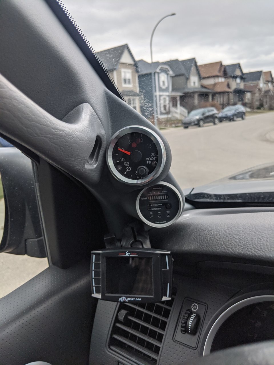

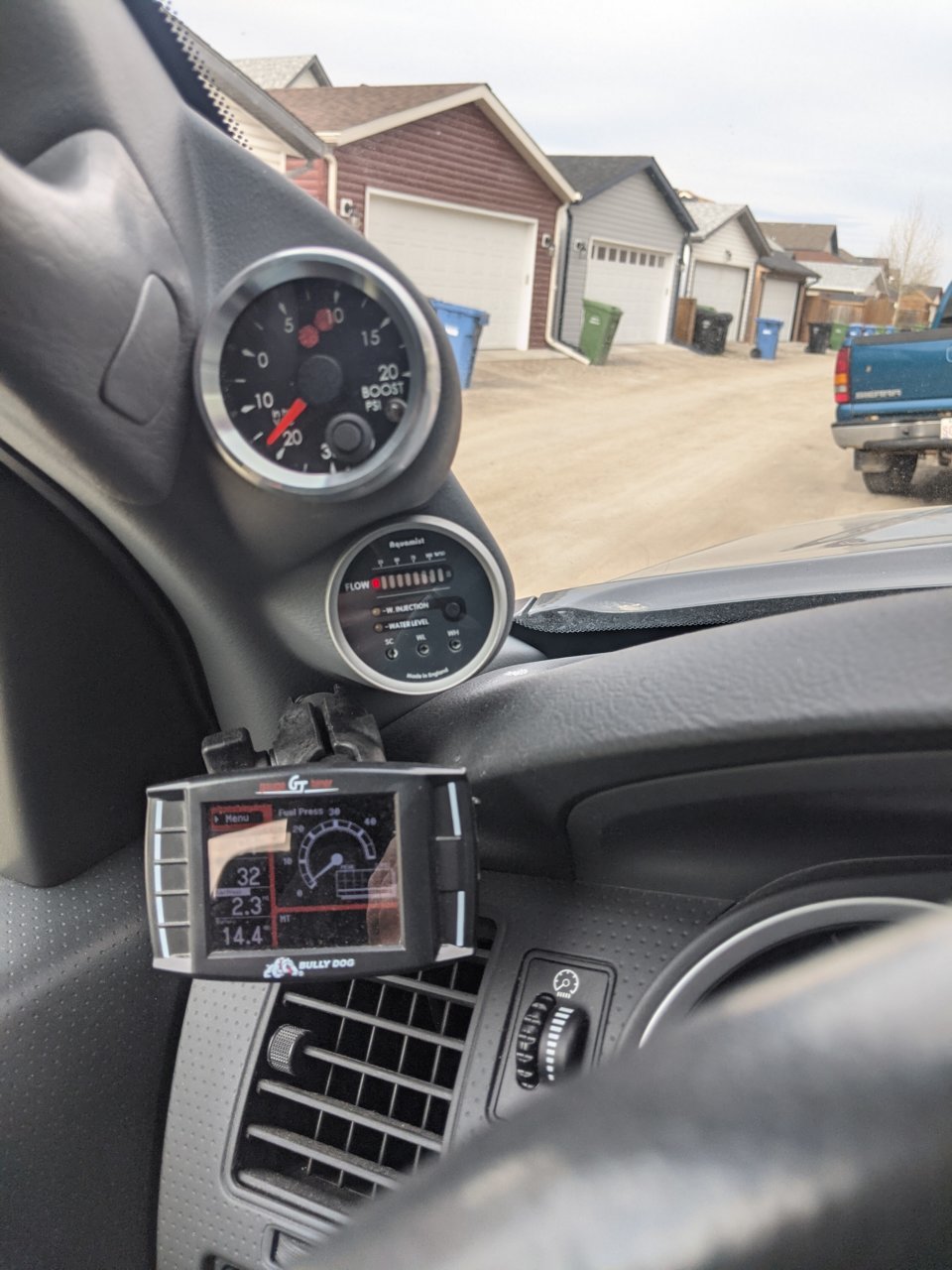

    Also been working on wiring, got my lotek pillar cleanly in place with the Aquamist and bulleydog gauges. The new boost gauge is waiting to be wired and I'm planning out the new wiring to replace at least three (out of five) fuse taps going to the cab fuse panel.

    Non operational boost gauge. Was going to wait until finished for the big pic but it may be some time yet until I can get the dash apart and running wires.

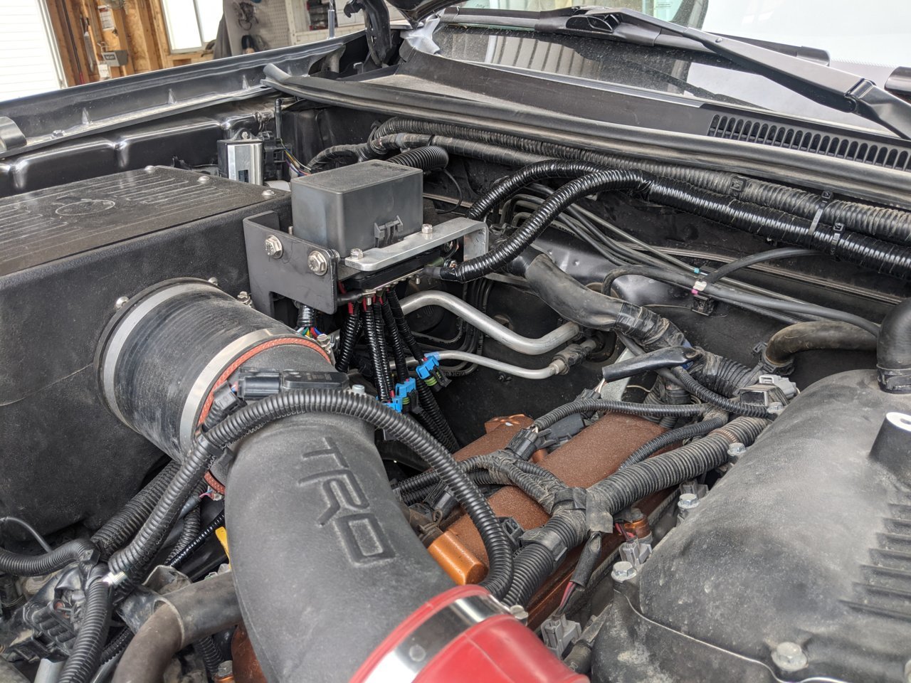

    Mostly finished the Bussman install. Have three gauges (afr, oil pressure and boost) powered from it and an ignition controlled relay to run the newly installed ZZP high output intercooler pump. So happy that it's wired better than the janky efi circuit setup. Still have some zip ties to fasten under dash wiring but the in cab fuse panel is way cleaner now.
    Bussman Xtmr relay/fuse box with 5 relays and 5 fused outputs

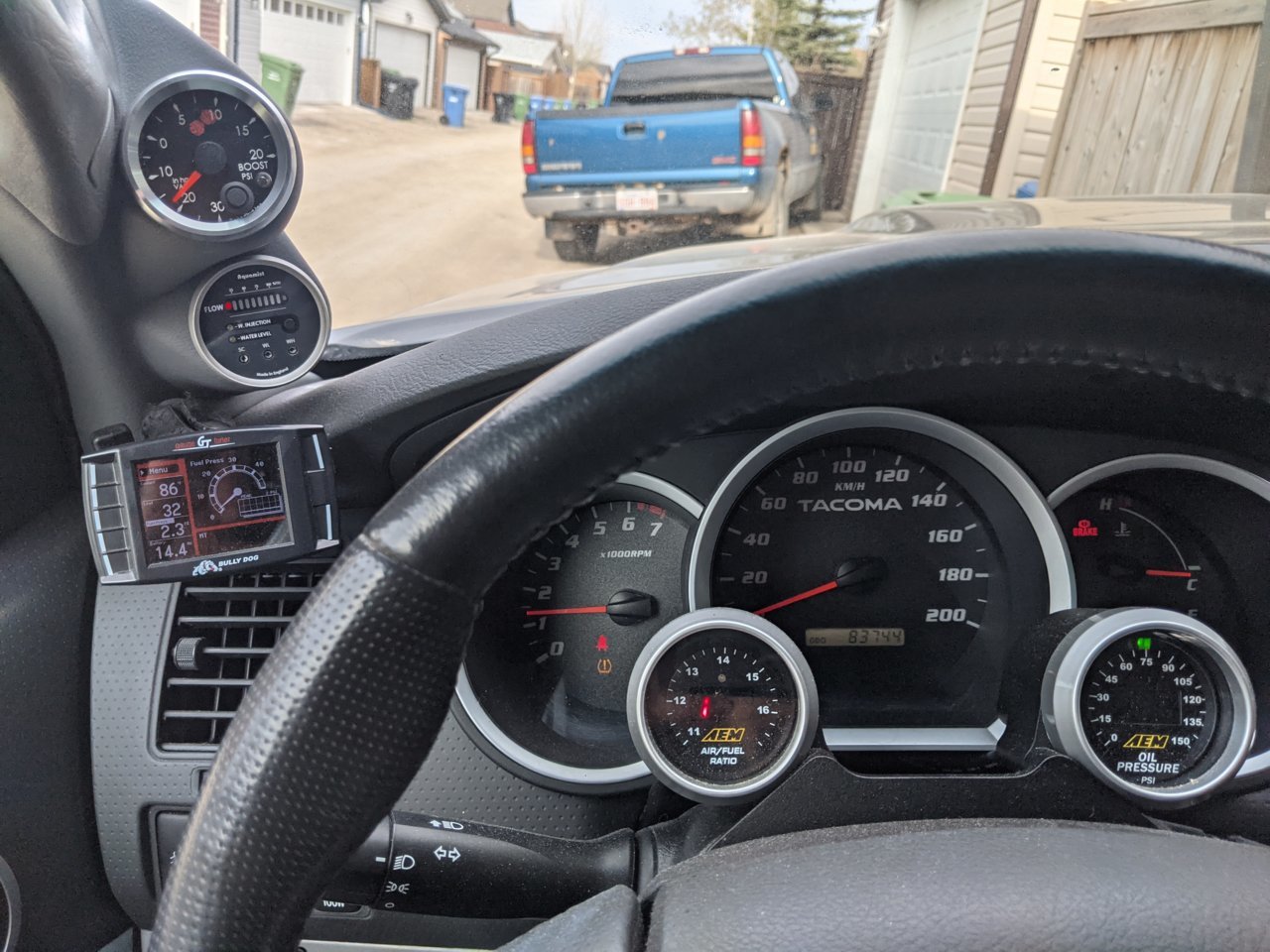

    Better pics of gauges (now working!) and lotek pillar
