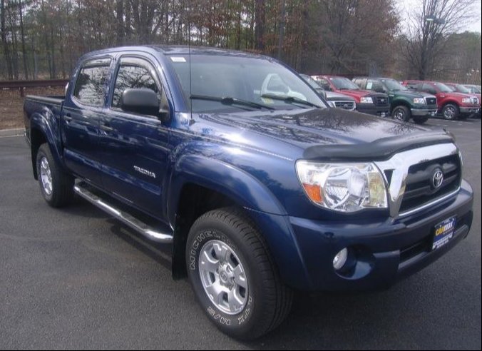

    Purchased in 2010 with 43,000 miles
    Original 2010 photos from CarMax

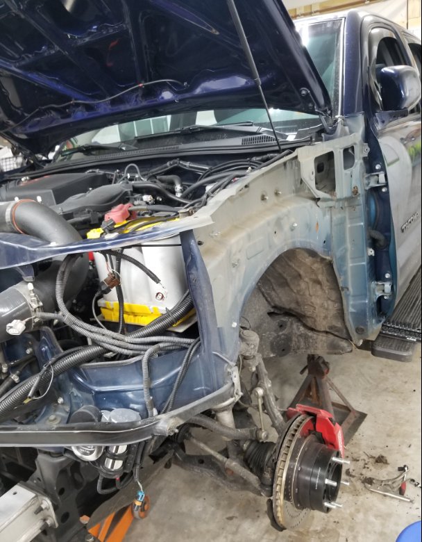

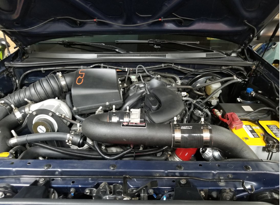

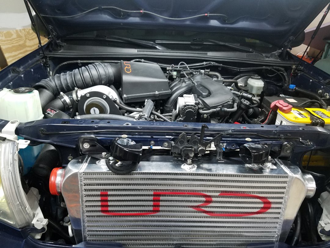

    My build started way back in 2015 with adding a URD TRUE COLD AIR INTAKE and a MAF Sensor Calibrator. While window shopping on URD's website I ran across the Rotrix Supercharger.

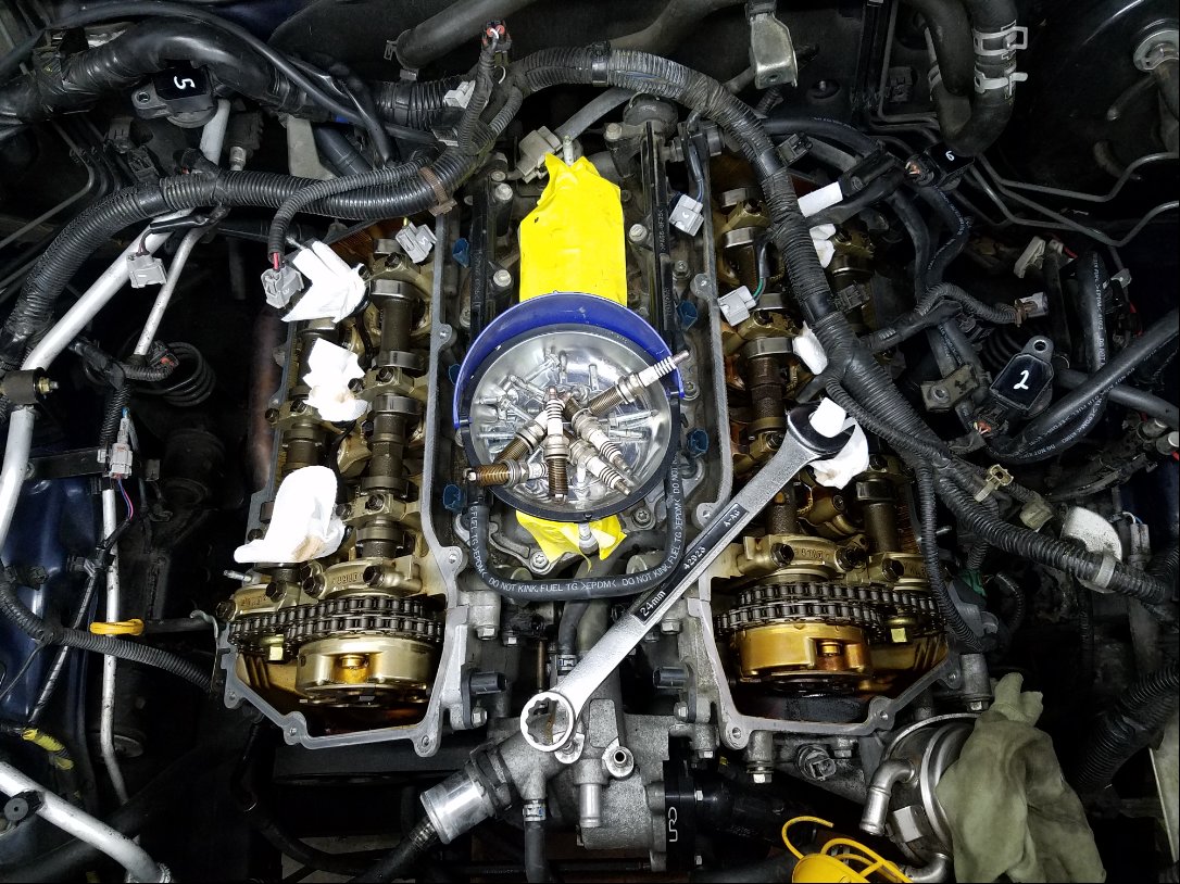

    Top of the 1GR-FE torn down
    Supercharge almost installed
    Finally Finished

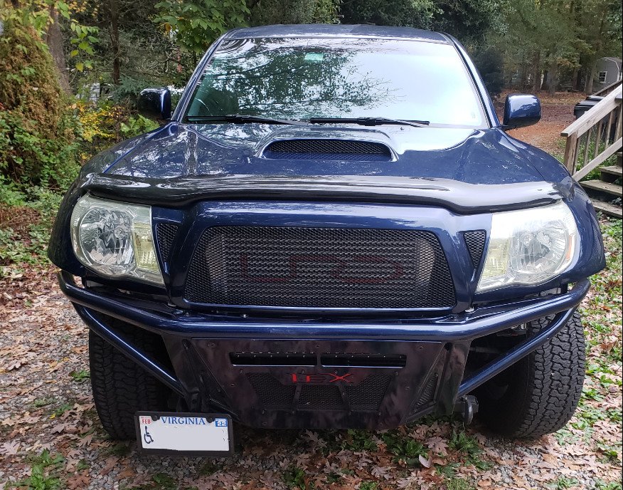

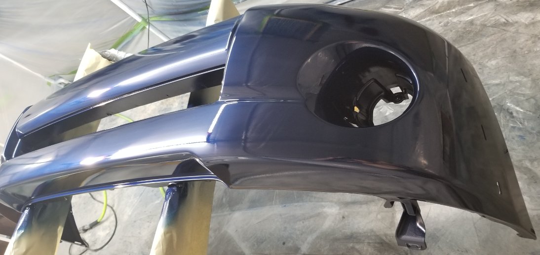

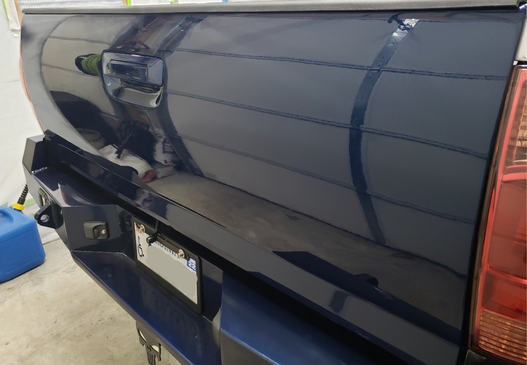

    From this front view of the intercooler behind the Grillcraft it's hard not to notice the beat up the front bumper cover… I knew I had to learn how to paint…

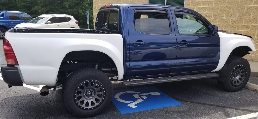

    At some point I managed to jack-knife a utility trailer into the rear fender. OEM replacements were way too expensive… So what do you do…Install fiberglass … it's a lot cheaper than OEM and it looks easy to install…yeah it was anything but easy!

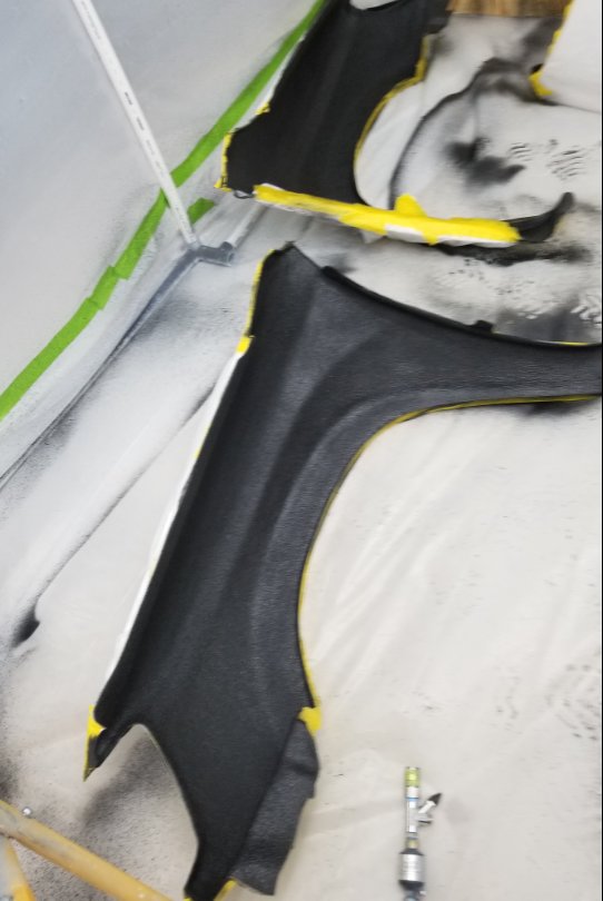

    Painting Raptor bed-liner on the back of the glass to stiffen and support the shape

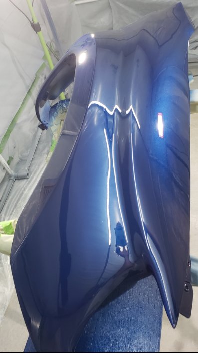

    Getting ready to fit the front fenders… between both sides I had the front fenders on/off the truck while trying to get the apex and headlight buckets fitted at least 30 times!

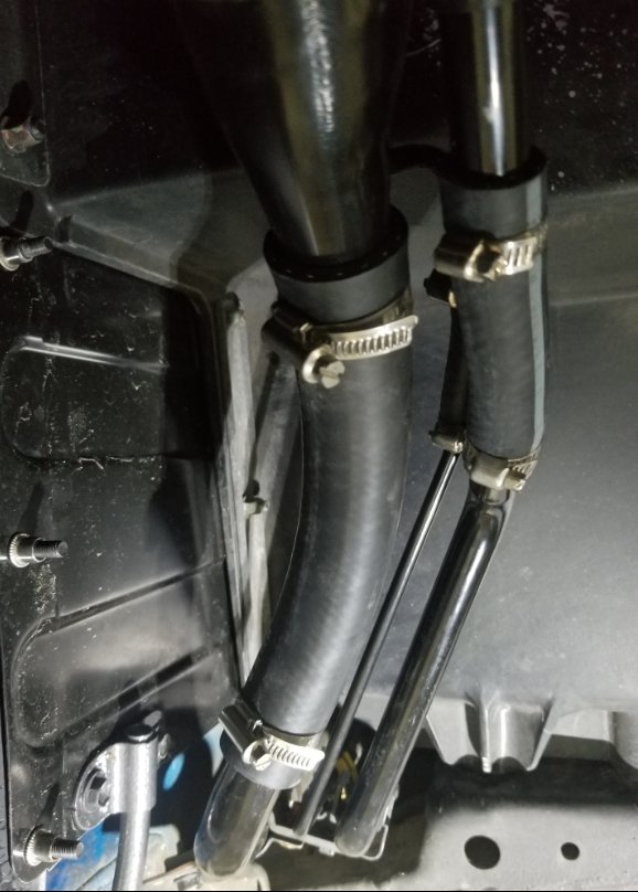

    The gas filler lines had to be extended
    I drove it around Richmond for 6 plus months before deciding to take on the job of painting

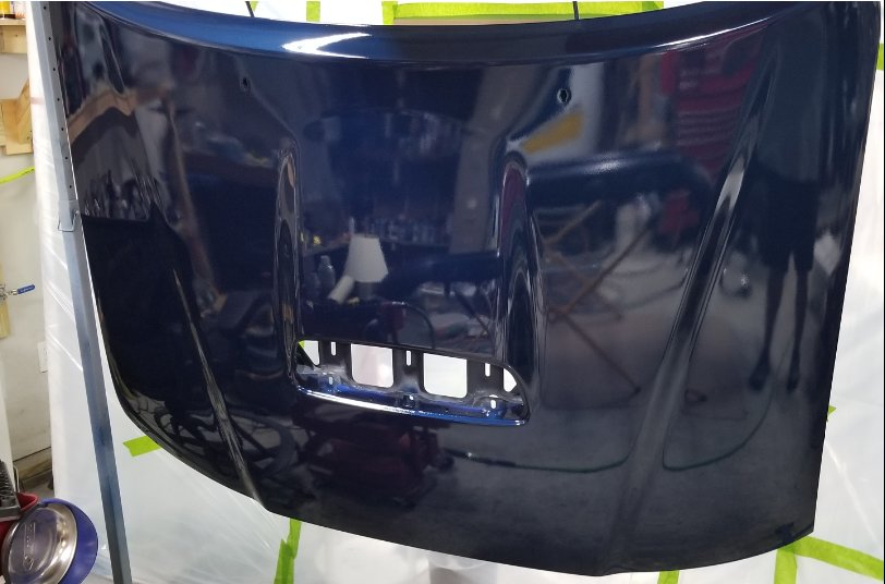

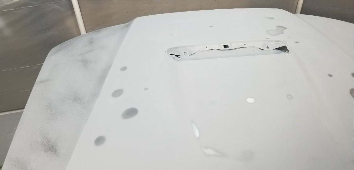

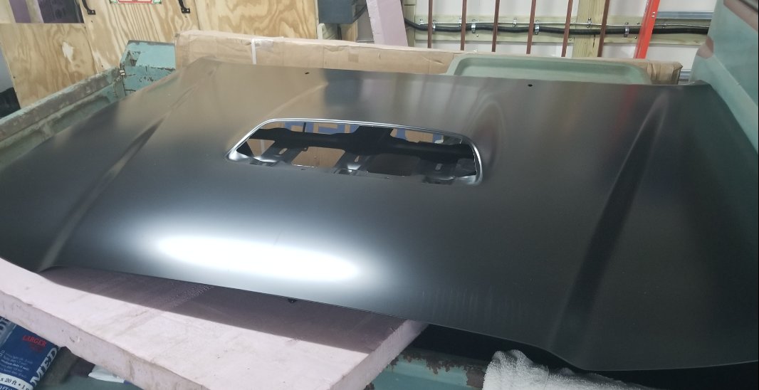

    Also the truck did not come with a hood scoop…
    As shipped but needed a good block sanding with high build and guide coat.
    Simply amazed at how many spots needed building from a CAPA hood
    Finally painted
    Front fender

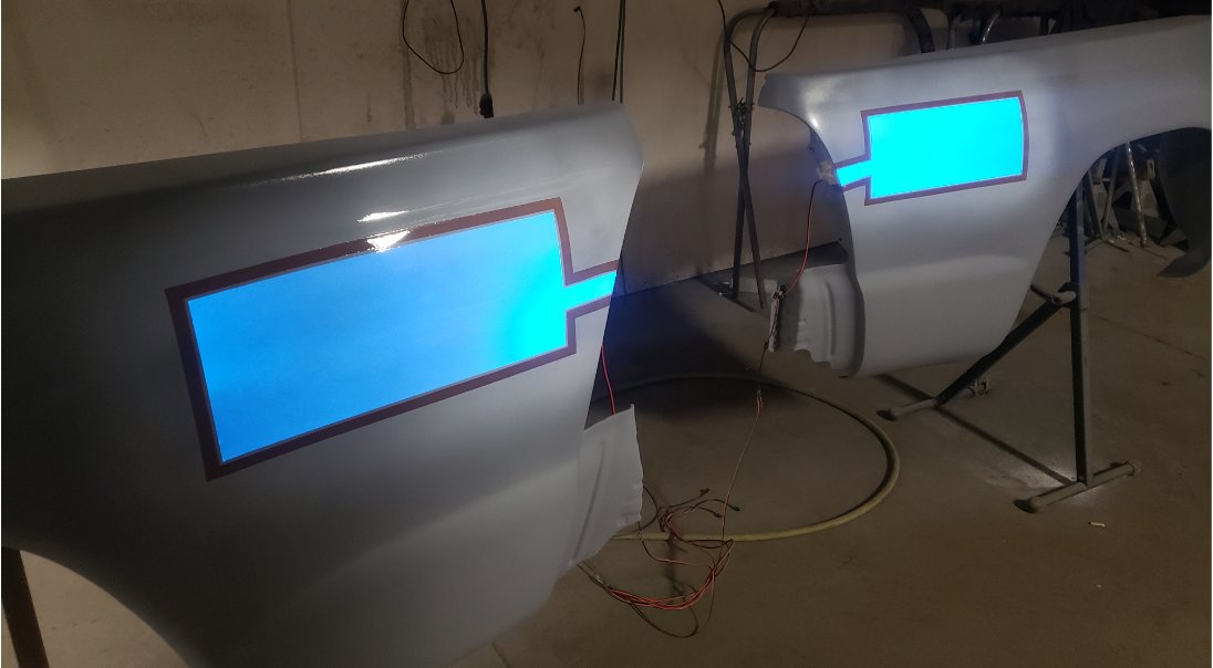

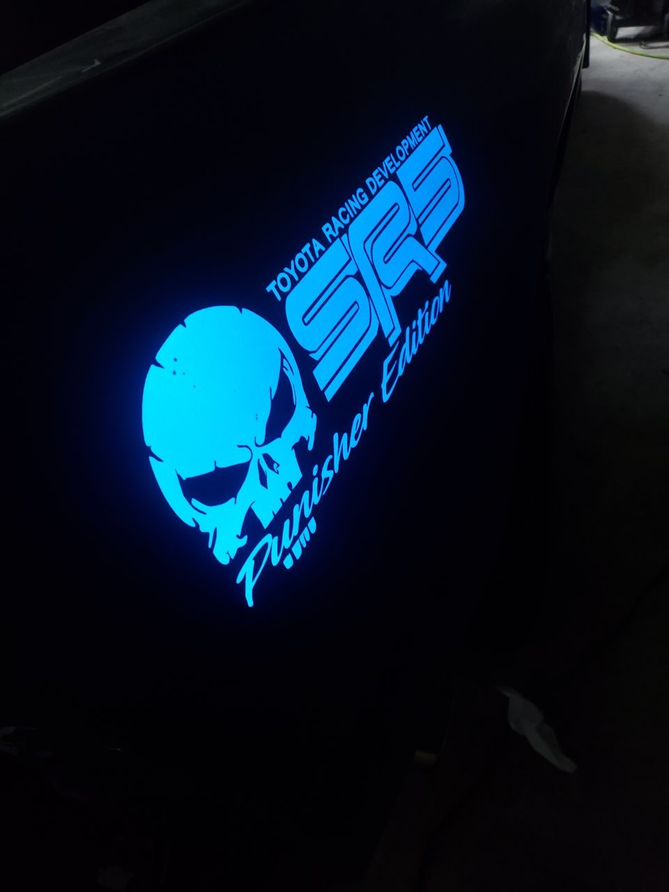

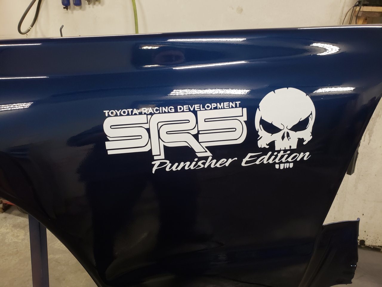

    It was time to take on the fiberglass fenders. I wanted to add some flair to the truck so I drove to Ohio and learned how to paint Lumilor
    Painting Lumilor was painful as fitting the fiberglass
    Part 2 Lumilor and more!

    Part 2 Lumilor

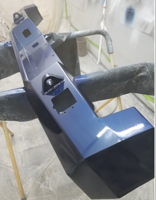

    eBay bumper nothing special but turned out nice after sandblasting and painting

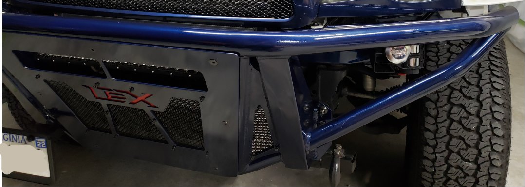

    A nice Lex Front bumper, some painting required

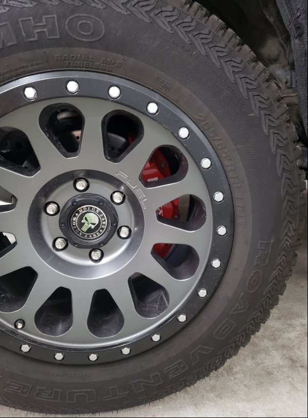

    Now the stock tires were looking right small under those large fiberglass fenders so what to do…
    18" Fuel Rims and softer Kumho tires and StopTech brakes

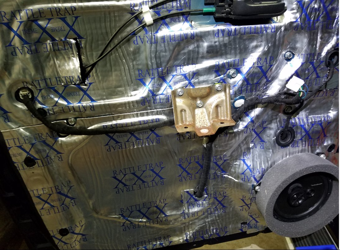

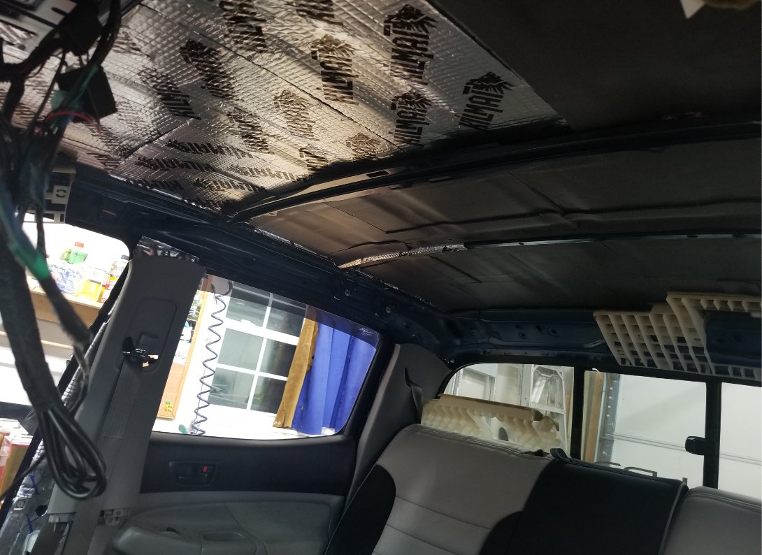

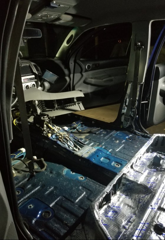

    The truck was louder after I had installed the URD Mark 2 Competition Y-Pipe and the URD Stainless 3" Mark3 Exhaust, I needed to do some work on the interior.
    Added RattleTrap, new carpet and a stereo.
    Getting ready to install the carpet and more RattleTrap
    Ran out of Rattletrap. This is Kilmat but I prefer the Rattletrap

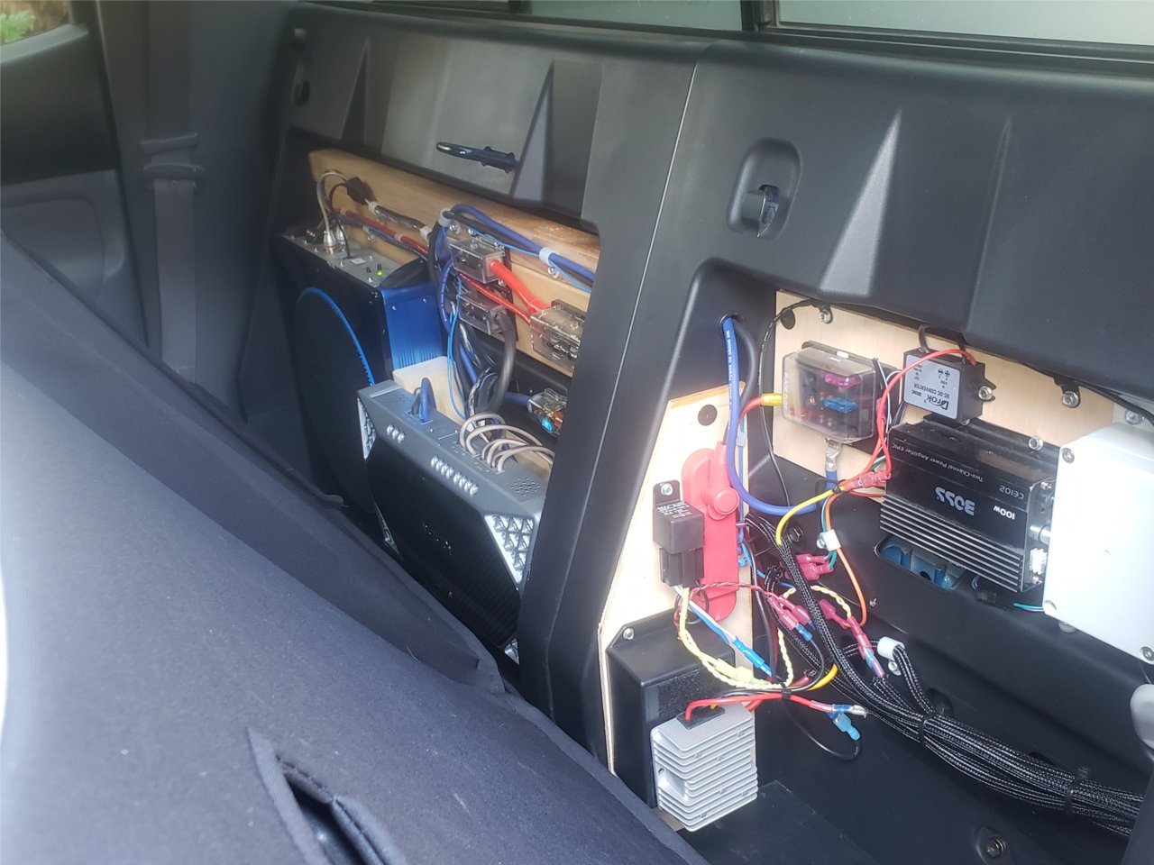

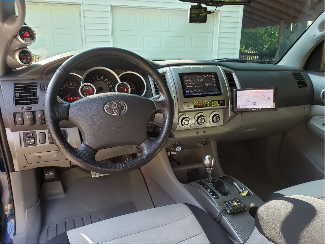

    Part 3 - Radio and Interior

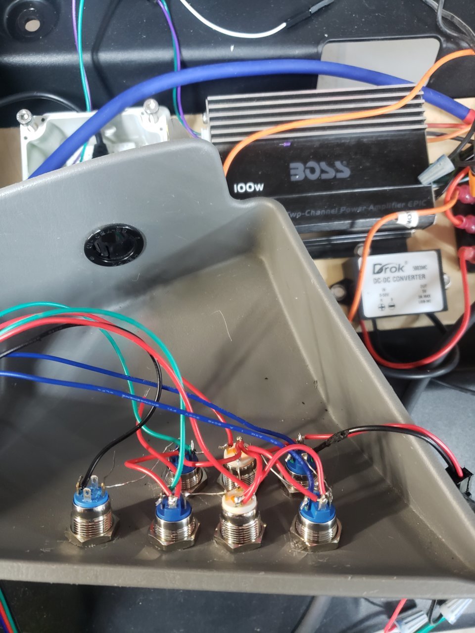

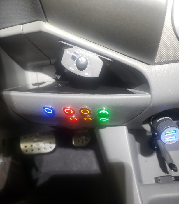

    I made a control panel for the Adafruit
    Lighted and installed Adafruit control

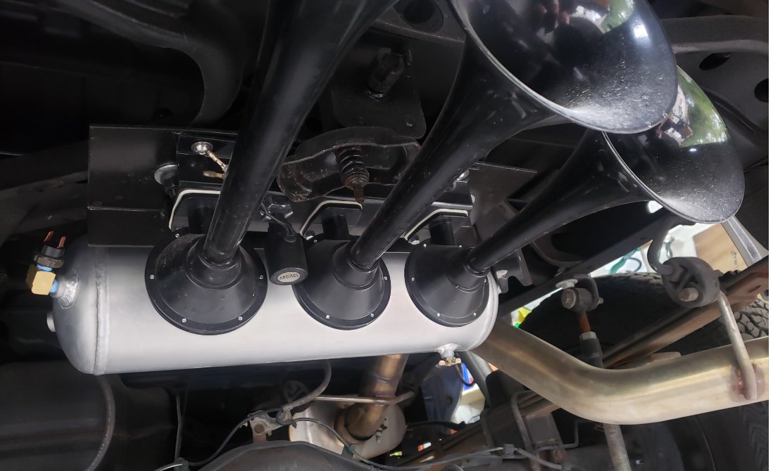

    While these horns were fun, just not loud enough…SO…
    Air-horns mounted in the spare tire well
    Dash with a few extras

    What fiberglass bedsides did you go with? Have you noticed any issues driving around town or on the trails with the wider body?

    Hi Jojee117, I used Advanced Fiberglass Concepts
    AFC 94
    2005-2015 - Toyota Tacoma Fenders - 4" Flare 3" Rise
    AFC 97
    2005-2015 - Toyota Tacoma Bedsides - 4.5" Flare 3" Rise - Mini Bed
    No problems with driving on or off road. I do get a few compliments on the wide-body. The only issue I had was dealing with small squeaks as the fiberglass settled. So far fixing these little noises has not been difficult except for finding them. If you DIY the glass, you will become an expert on fit an finish, as this was a challenge, at least for me to align/fit especially the headlights and taillights, and the apex on the front fenders.
