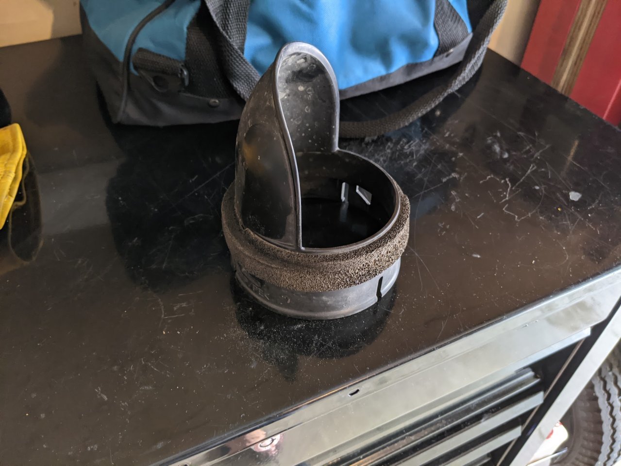

    I think their some small goodness about the Intake Accelerator? A certain bit of smoothness and pull on the bottom end? No additional sound that I could discern over the HPS intake tube. I am sticking with the paper filter.
    This is the Stock part:
    I will have to take another quick look, but I believe that slot closest to the camera is on the top.

    Oh, it's just that part in the fender. Any negatives to losing the deflector thingy?

    Yes. Just pull the bottom of the box (three screws), pull the existing part off, pre-place the new part through the hole with some folding, slip the box bottom over it, and done.
    There is going to be a slightly better chance of water intrusion when fording overly deep stuff. That said, I have heard from folks that deep creeks around here are a bad idea as the super fine glacial till can push past seals?

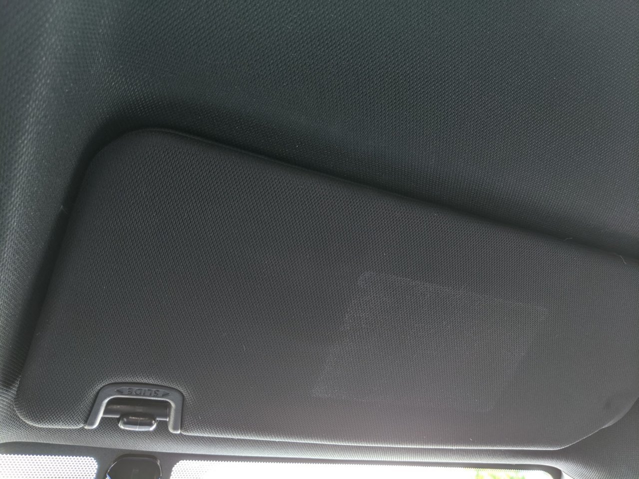

    I finally remembered to get direct pics of the visor sticker removal.
    I started out with removing them using 91% ISA and a Qtip and then cleaning up the residue with GooGone and GoofOff. GoofOff does not harm the visors. It took a few applications. Later, I got a little steamer, which is way easier. I also recommend taking the visors out for the work. So much easier. Just go very slow with the steamer for the best results.
    The remaining residue is hardly noticeable and is zero distraction when driving, unlike the stickers.

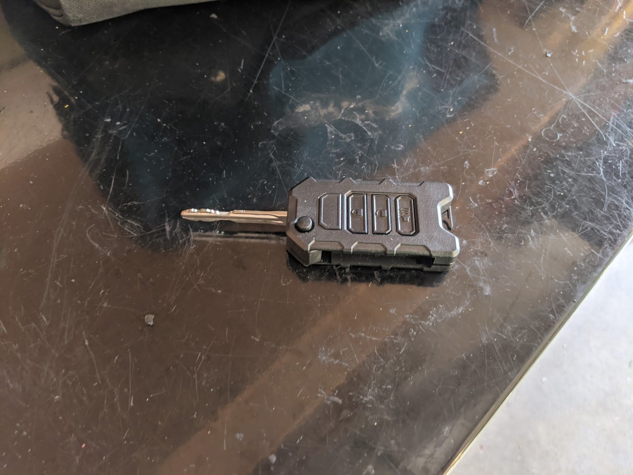

    @MESO Flip Fob.

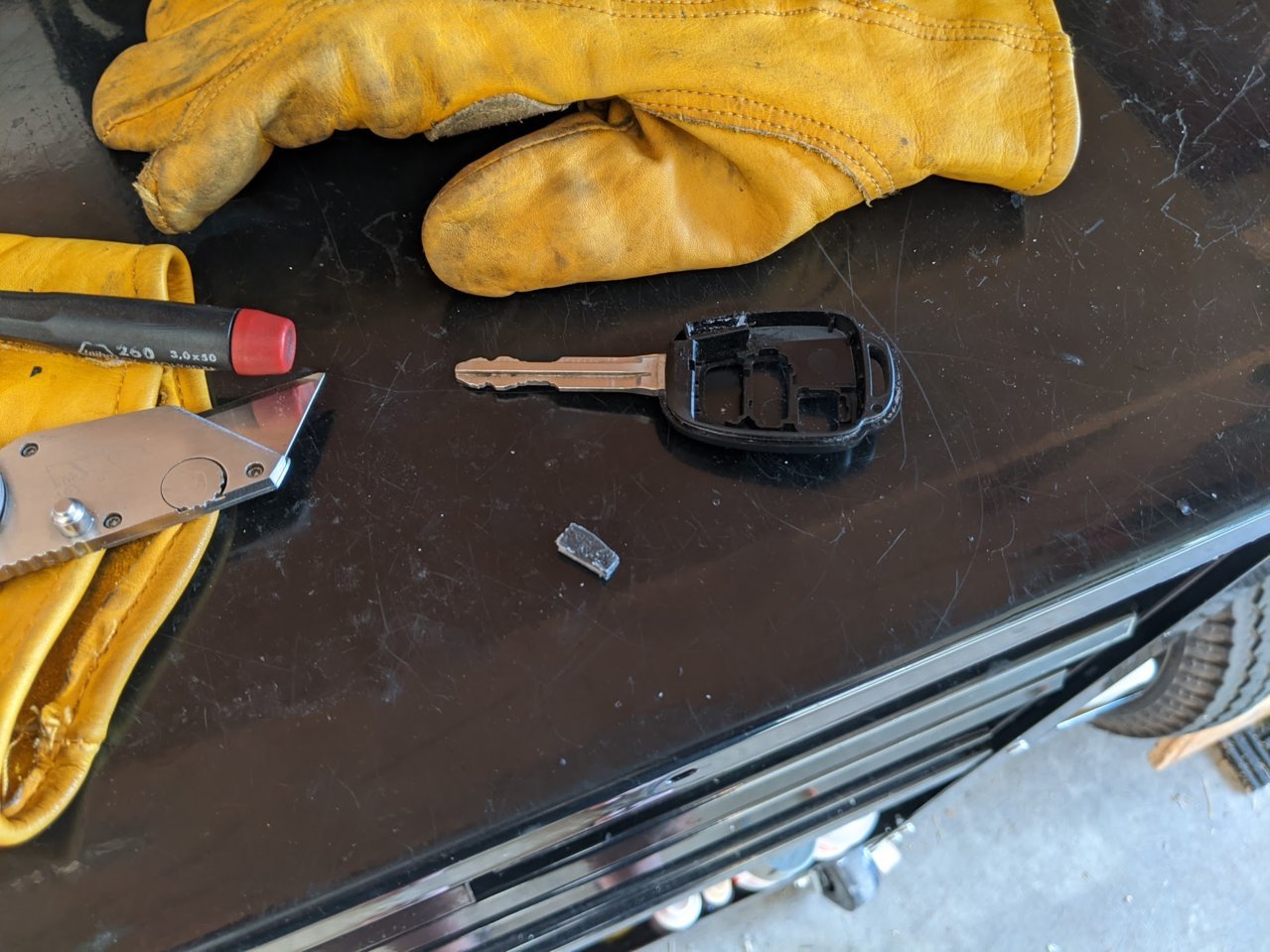

    More pics later. But, here is the transponder extraction without destroying the key shell. The shell is made from PC+ABS with 20% glass reinforcement. So, it has a heat deflection temperature of over 300F. They only real heat worry was the transponder itself which worked great after removal.
    I used a heat gun to warm it up a bit. Cut the narrow, fob side of the slot off. Exposed the chip to the bottom of the slot. Used a large flat blade screwdriver to break the glue seal across the slot. Then, hit it with more heat and pry the chip up and out.
    It is in there with something gooeyer than CA.
    Since this doesn't kill the shell, it is reversible when these keys arrive.
    Key cut for cheap. The Flip Fob works very nicely. I'm very happy with it.

    I have a problem. Should I seek clinical help?
    A bit of careful acetone.
