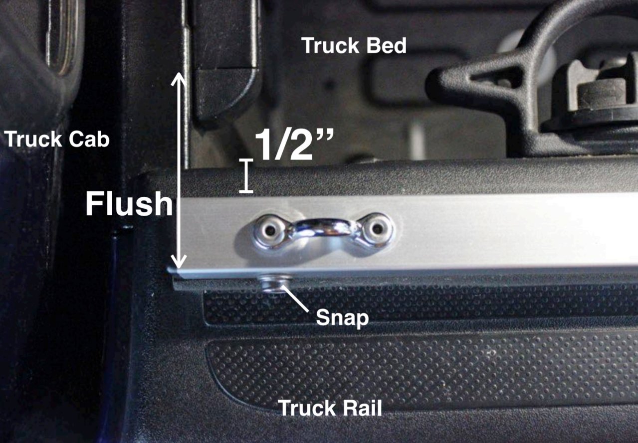

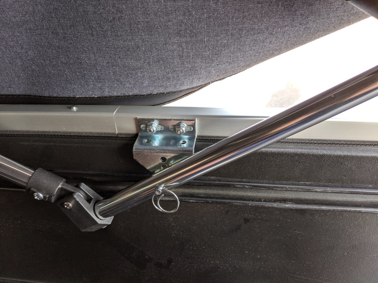

    Softopper Stuff
    I recommend pulling the rails, protecting the paint, and sealing. I had some wear spots from my tonneau and jumping over the side.
    I'll get some better shots in the morning.
    A couple installation things. The alignment pic they show for the rails is a 2nd Gen. Sight to the bed itself, not the header rail. Interestingly, the screw-in snaps went in the header rail. I was expecting them to go into the composite bed itself. That was a pleasant surprise.
    The Softopper is much nicer than expected and works great on a quick highway run.
    Alright. Here are the pics that I promised.
    Doing the tuck:
    I over exposed these to get an alignment view of the rails:
    This is just a great amount of space:
    Snap locations for me:
    I dropped the tension a notch:
    Front corner:
    Gap at the cab:
    Front - rear tension adjustments and such:
    I'm an idiot. The buckles at REI were damn close. The Softopper male end fit the female side nicely, but the REI male end was a scosche too wide. Trimming it would not have worked since it would weaken the clasp. But on the idiot side, the ROK strap buckle does work with a tiny mod.
    I'm solid now!
