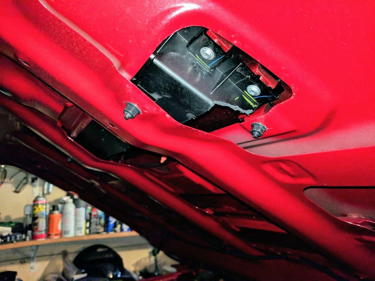

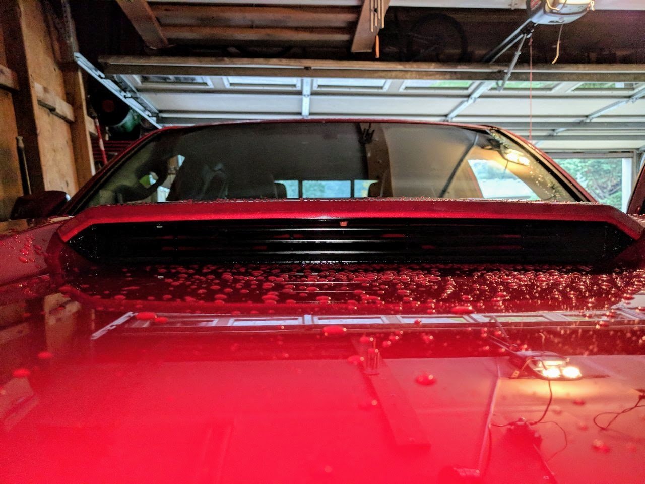

    1. what does the functional hood skewp mod do / look like from front and underneath?
    2. what is the override cable?
    any more plans or just cosmetic?

    1. I quickly got tired of slush and car wash soap coming out of the Skewp and splashing the windshield right in my line of sight. So, I cut off the back of the unpainted section. It has been great since.
    The orange clip was not noticeable, but I did eventually painted it black.

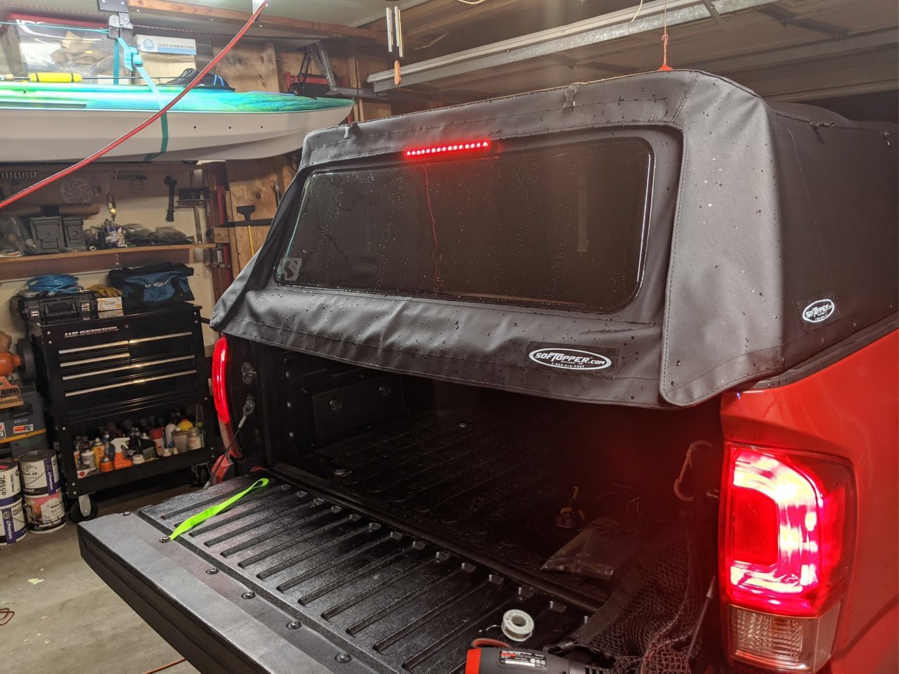

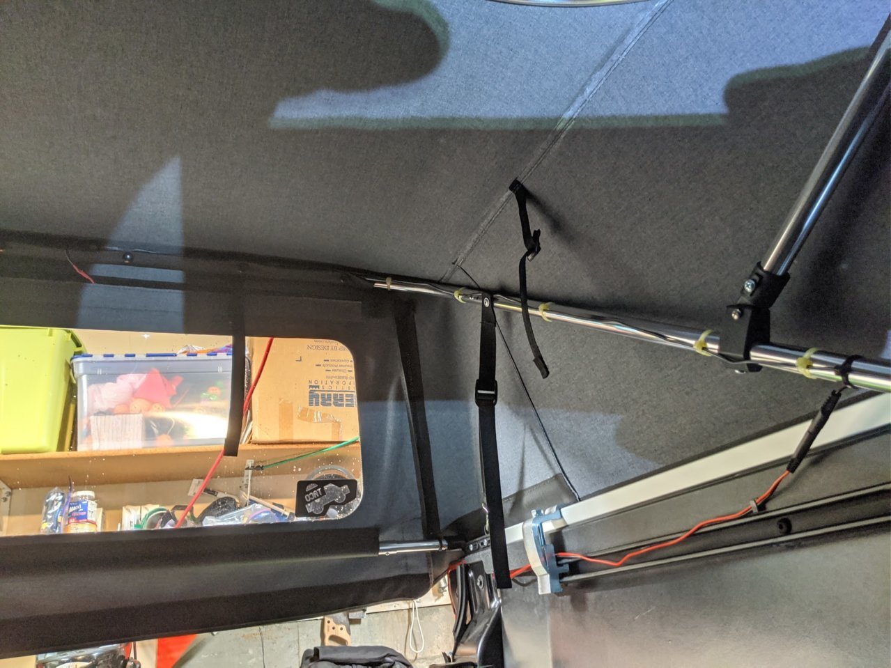

    Softopper 3rd Brake Light Mod:
    Using:
    12V LED Strip:
    https://www.amazon.com/gp/product/B00MNCASKK/ref=ppx_yo_dt_b_asin_title_o02_s00?ie=UTF8&psc=1
    2in Wide One Wrap:
    https://www.amazon.com/gp/product/B00I0TTVVC/ref=ppx_yo_dt_b_asin_title_o01_s00?ie=UTF8&psc=1
    1in would be sufficient to hold this puppy in place.
    I had some SAE connectors lying around, so it was no big deal. I tapped the left brake light and routed it through a small gap between the bed and rail.
    7r41lbr34k3r and NoOne like this.

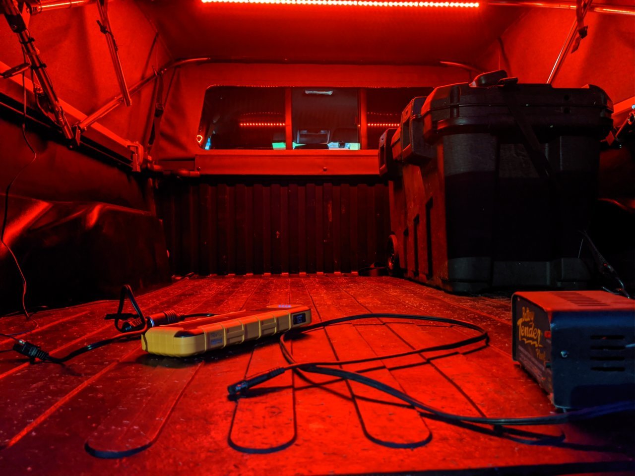

    Mood lighting :rofl: with LED strip leftovers:
    Powered when needed with my jump pack.

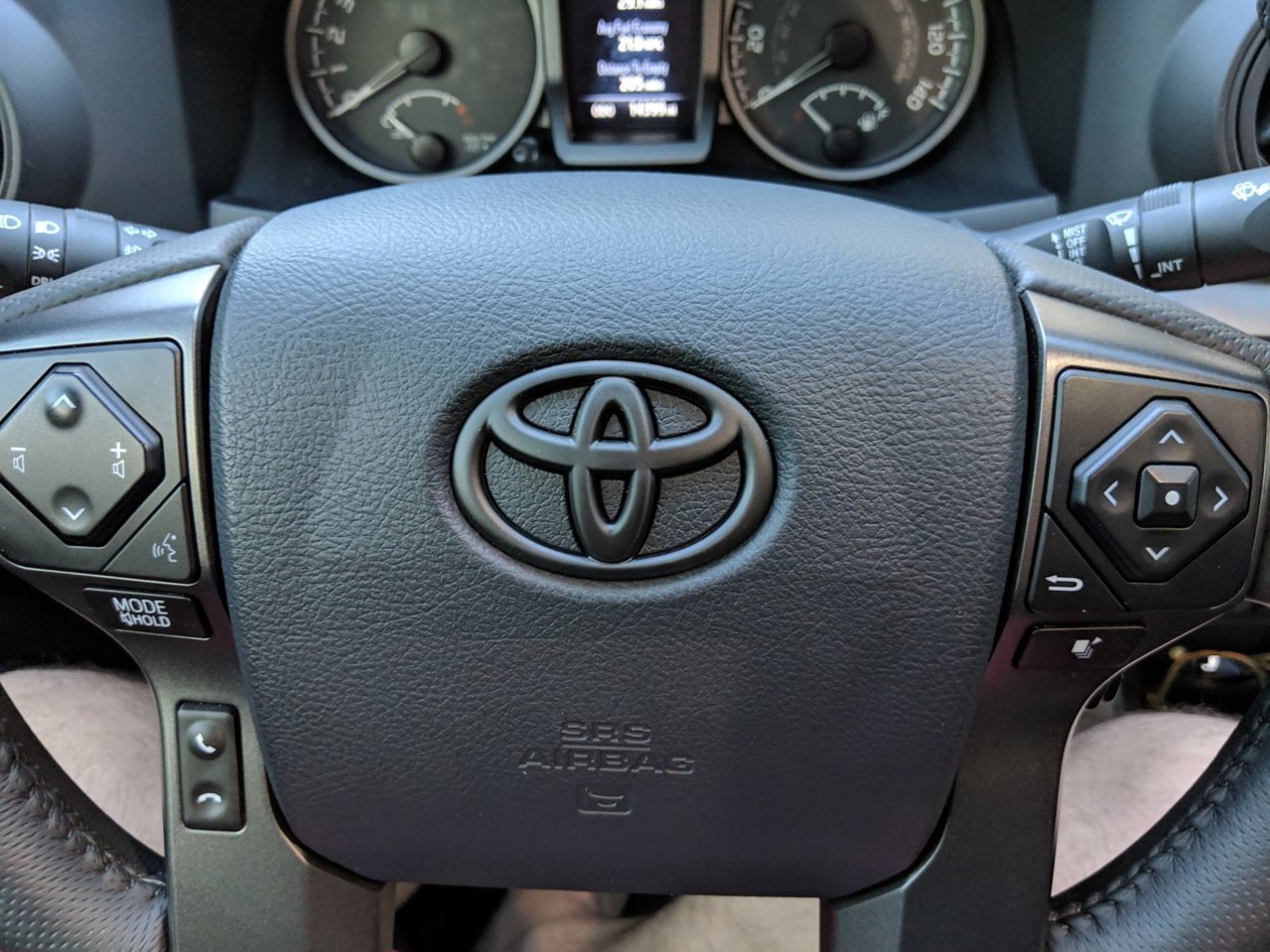

    One of my favorite mods because it is seen every day, yet blends into the background unlike the shitty chrome:
