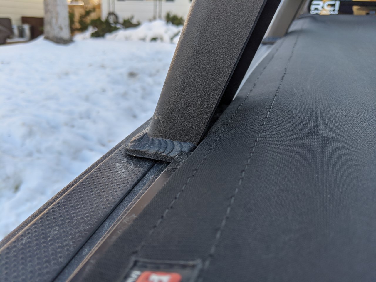

    I cut into the tonneau cover rails to allow for the additional "width" of the RCI bed rack supports. This allowed the rails to still be the normal/intended width. As far as too tight where it closes do you mean the cover is too taught and you cant get it to "lock" down?

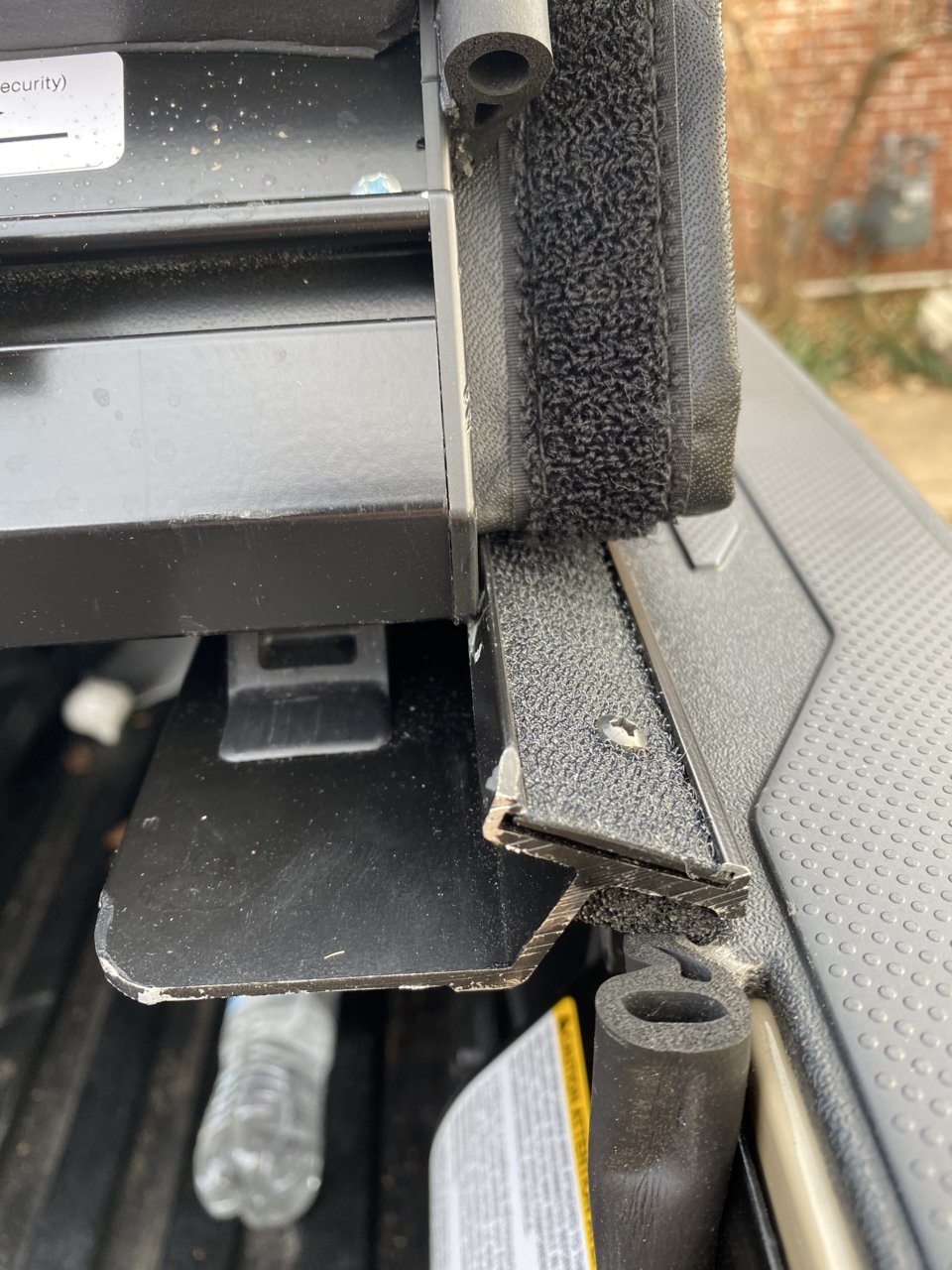

    057DB67C-2C6C-40E6-AA3D-E40EA8B4EEF6.jpg2837A29A-96AC-4BB0-AA12-C83D03099B85.jpg C0771102-E297-4678-BE9F-3C322852516F.jpg4B0A69BD-F453-437B-B155-ED20DE18F475.jpg Here are some pics. It’s definitely not wide enough as you can see from the loss of paint where the end closes and also the cover is not taught, which causes water to pool.

    I don’t plan on sealing it, more for keeping things out of sight then to keep things dry. If anything some silicone around the cuts and that should do pretty good. What helped was getting a 5.5 foot rack for my short bed Tacoma so I only have 4 cuts in the rails instead of 6.

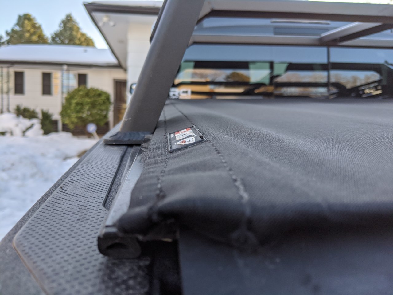

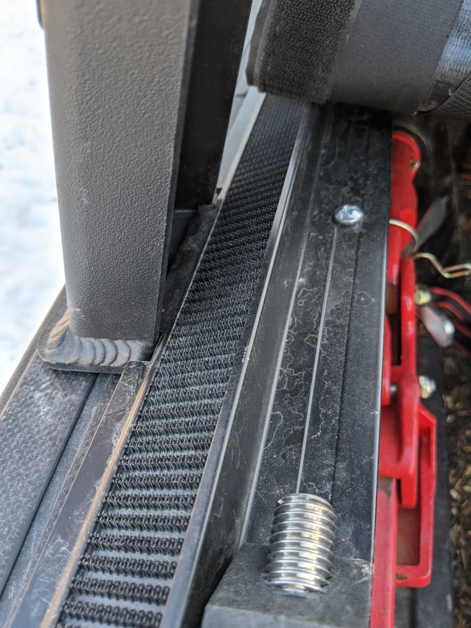

    Here a couple shots of the cover/rail/rack. At the tail end of the rail I also cut off the vertical part to allow the rail to go closer to the bedside. That's what the last picture is of.IMG_20191203_082123.jpg IMG_20191203_082126.jpg

    Thanks for the photos. I am going to take it all apart and try again. It works as it is but I want better than “just works”. Thanks again.

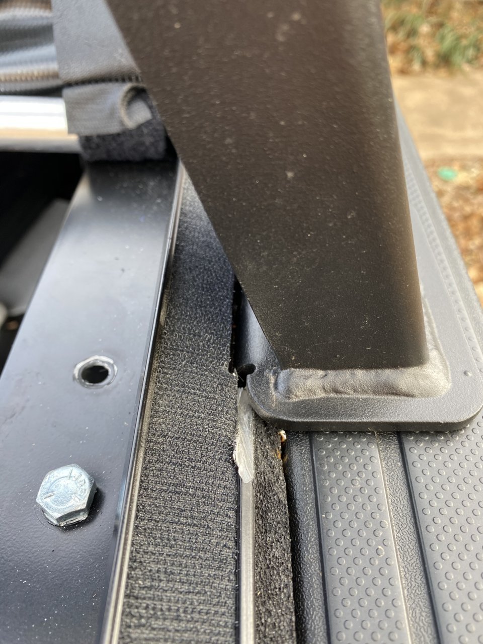

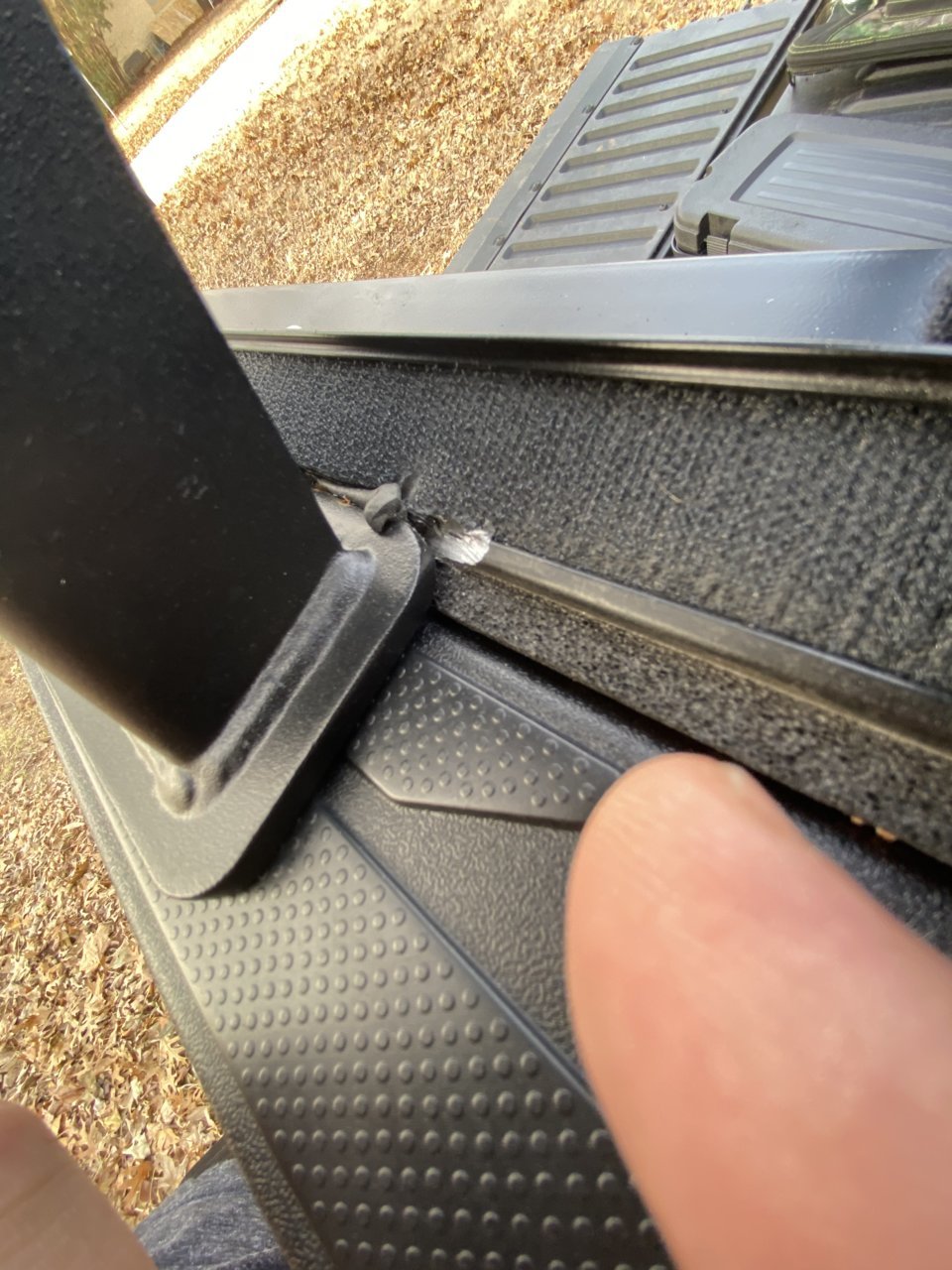

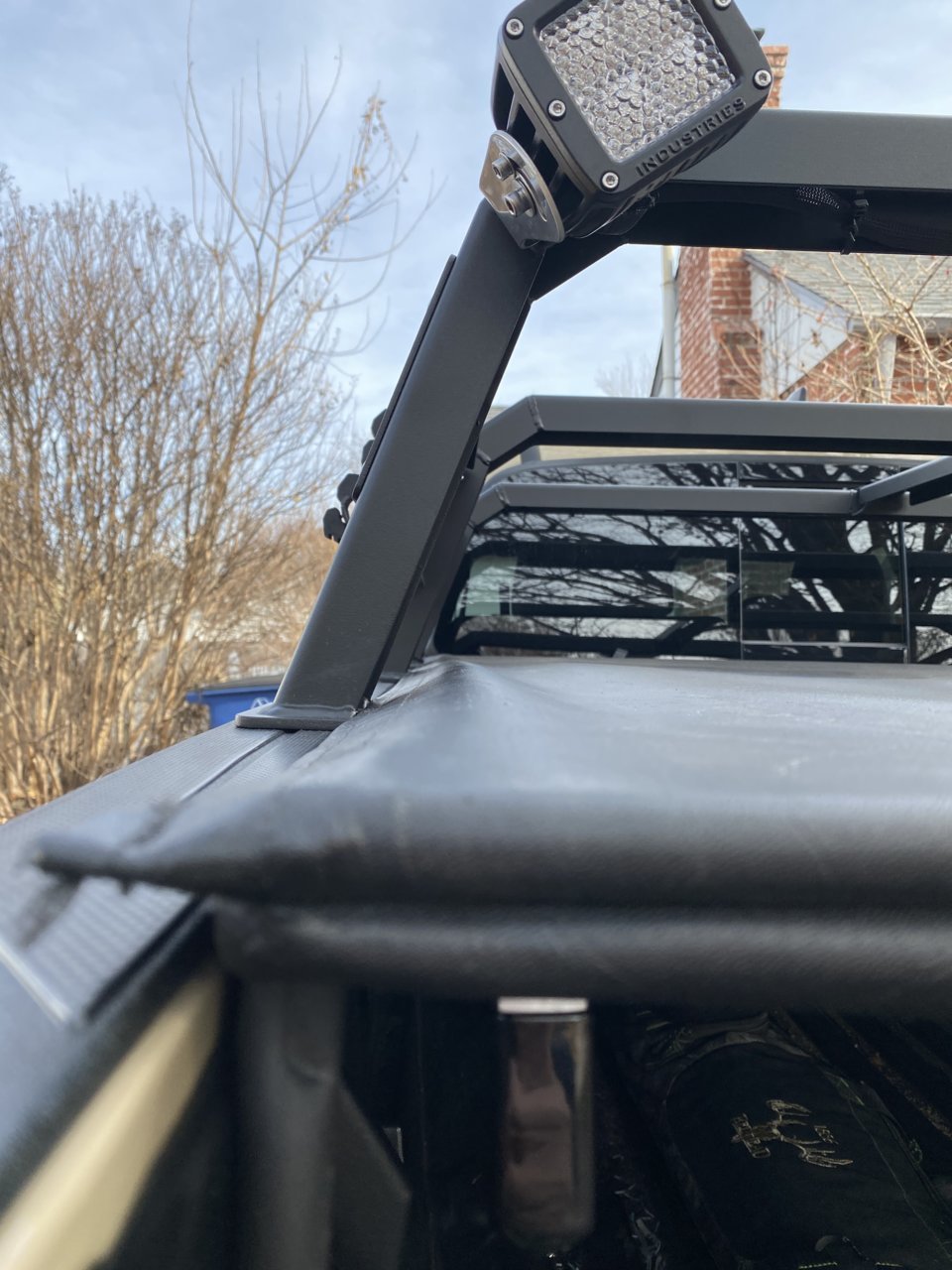

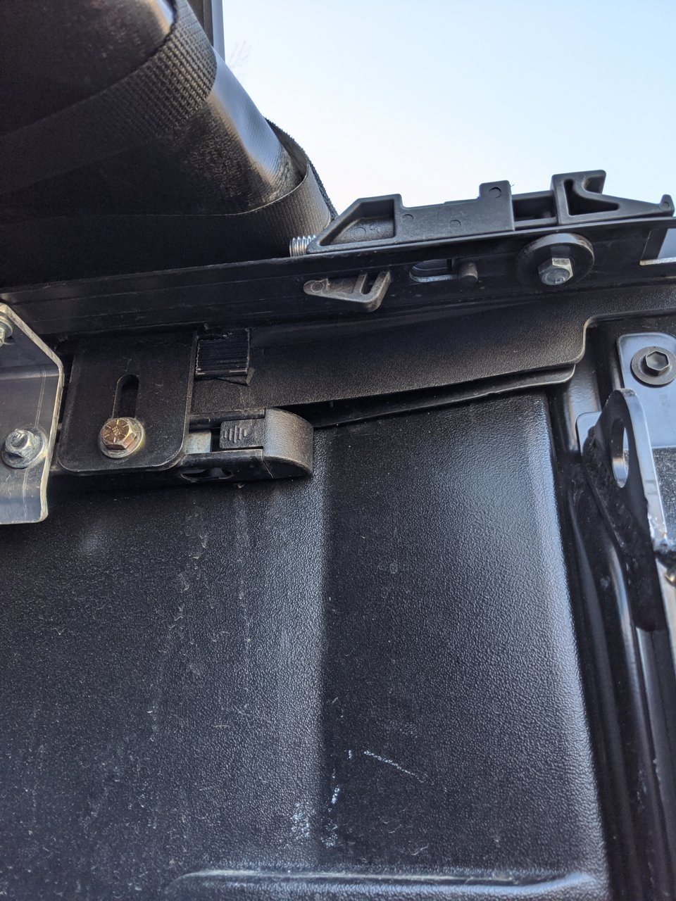

    [​IMG] [​IMG] [​IMG] [​IMG]
    Sorry for the delay. You can see it lays flat, the edges only slightly come up around the rack, but there's no buckling of the cover itself. See the last picture to see how tight it really is, it's that far off, I have to push the rail upwards while I have the other side in to get it to lock into place, but it's perfectly functional. As a previous poster mentioned, it is worth noting I cut slightly into the velcro in some places, or at least the lip that holds the velcro. Hope you get yours working, it's definitely nice to have.

    Thank you for the pictures. Yours looks similar to the amount of cutting that I did. I see that your rails are slipping downward causing the figment issue. I had this problem until I unscrewed everything and put a lot of pressure upward when retightening. I also gave it a few wacks with a mallet and I am able to latch it without too much trouble. It’s still a tight fit but it goes in. I’m surprised how flat yours is laying down compared to mine when mine latches easier. Perhaps I bent the rails in the process when trying to adjust. I may just live with it but I have a feeling my OCD will make me take it all apart when I can find the time.

    Haha ya, I get that for sure. There was definitely an amount of 'letting go' I had to do, but seeing the end product and the cover appearing quite flat, I got over it. I think when the cover is actually latched in those rails don't angle down quite as much. Yesterday was the first time I unrolled it to mount my tent that I just finished, I was surprised that it unrolled/rolled back into place quite well (at an angle, of course, to work around the bed rack). I was also pleasantly surprised to see it still fitting taught after days of heavy snow sitting on the cover.
