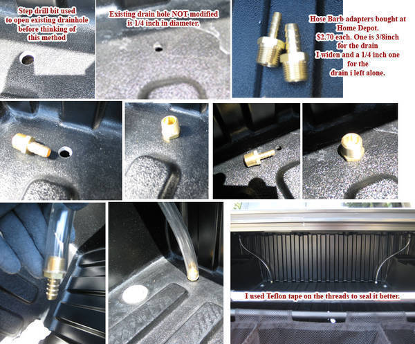

    I read the tonneau threads when researching to buy one. i read how some hated that they would have to widen their bed drain holes to fit the the huge tubes that come with the tonneau. well as i was widening one of my drain holes i realized that home depot sells hose adapters. i went to home depot and found hose barb adapters. i bought one 1/4inch to fit the factory size drain hole and one 3/8inch for the drain hole i widen.
    Also on another note, regarding the hose clamp mod for the tailgate: i read that even though its a great mod some were still worried someone could just use a screwdriver to take it off...so some were thinking of either putting a weld over the slot or shaving off the slot so you could use a screwdriver. Well Prestone makes these hose clamps that use a plastic triangle key that is removable. so once you tighten and remove the key there is no slot to use a screw driver.
    Just thought this might help some people out there.:D

    Well if they are smart enough to carry a screwdriver. I'm sure that they would also have a pair of pliers and can spin that clamp right off.
    Point is, if they want it, they will get it no matter what we do.
    BTW, I don't have a tonneau as yet, why is this necessary, the drain kits?

    The hose clamp mod is worth it...Because if you make it harder for them- They might not get yours!!
    Drain kits depend on the type of tonneau- a hard roll up type cover has a box where the cover can go and that can fill with water if not drained. A soft roll up type cover or folding cover prolly won't need a drain kit. And I'm not sure about hard tonneaus...but i don't think they'd need one.

    Good post man.
