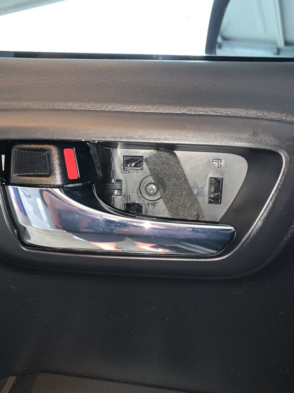

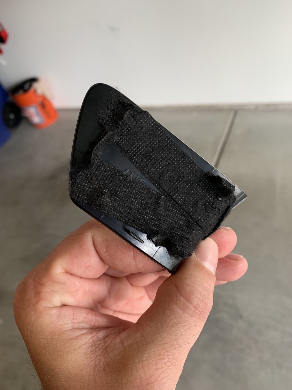

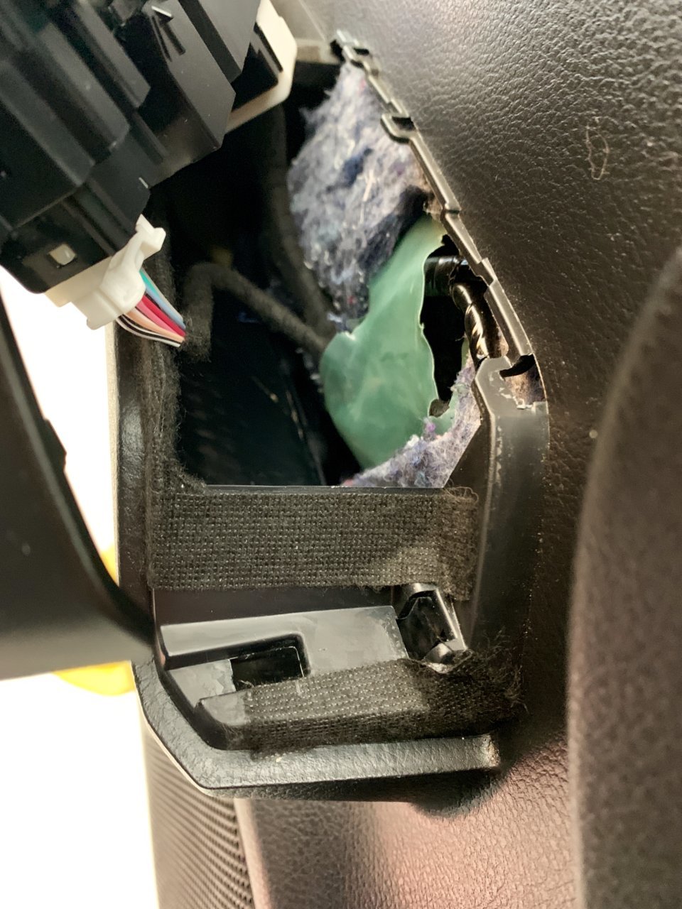

    Also have the JBL system and found the rattles annoying as hell. So, I applied sound deadener to almost all exposed sheet metal behind each door and behind the sub enclosure. But - still had a rattle in the doors.
    The little plastic piece of the door that covers the screw behind the latch rattled like crazy. I popped that off and stuck some cloth tape (like tessa tape) to the back of the plastic piece and to the door panel. NO MORE RATTLES

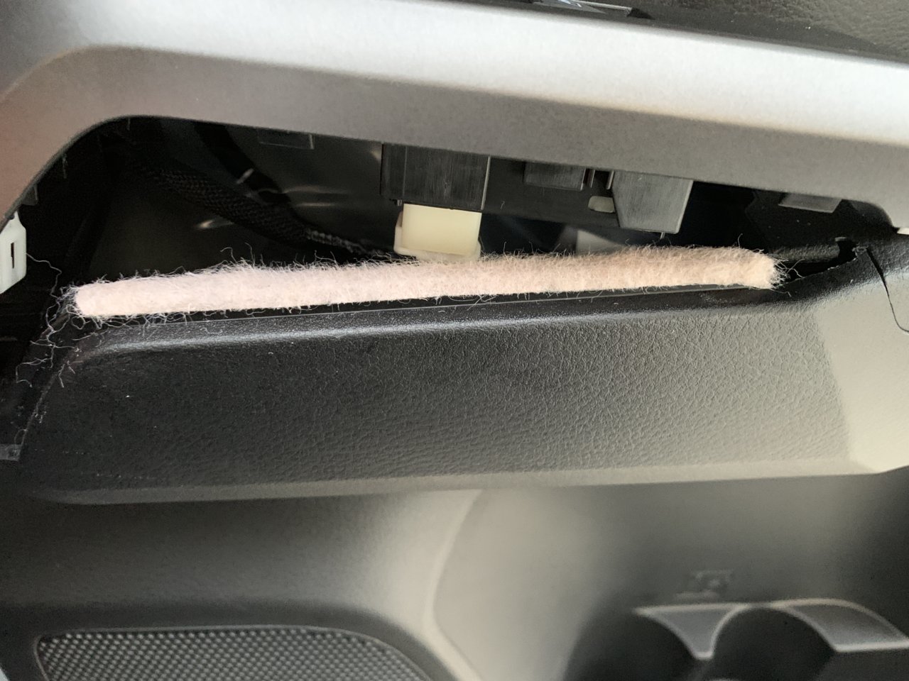

    I had to do the same thing right after I bought the truck. Also used felt tape on the switch panels.

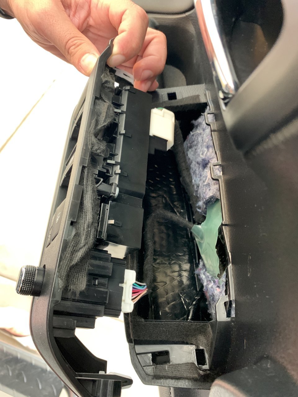

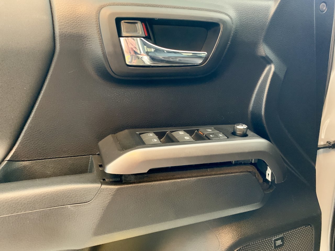

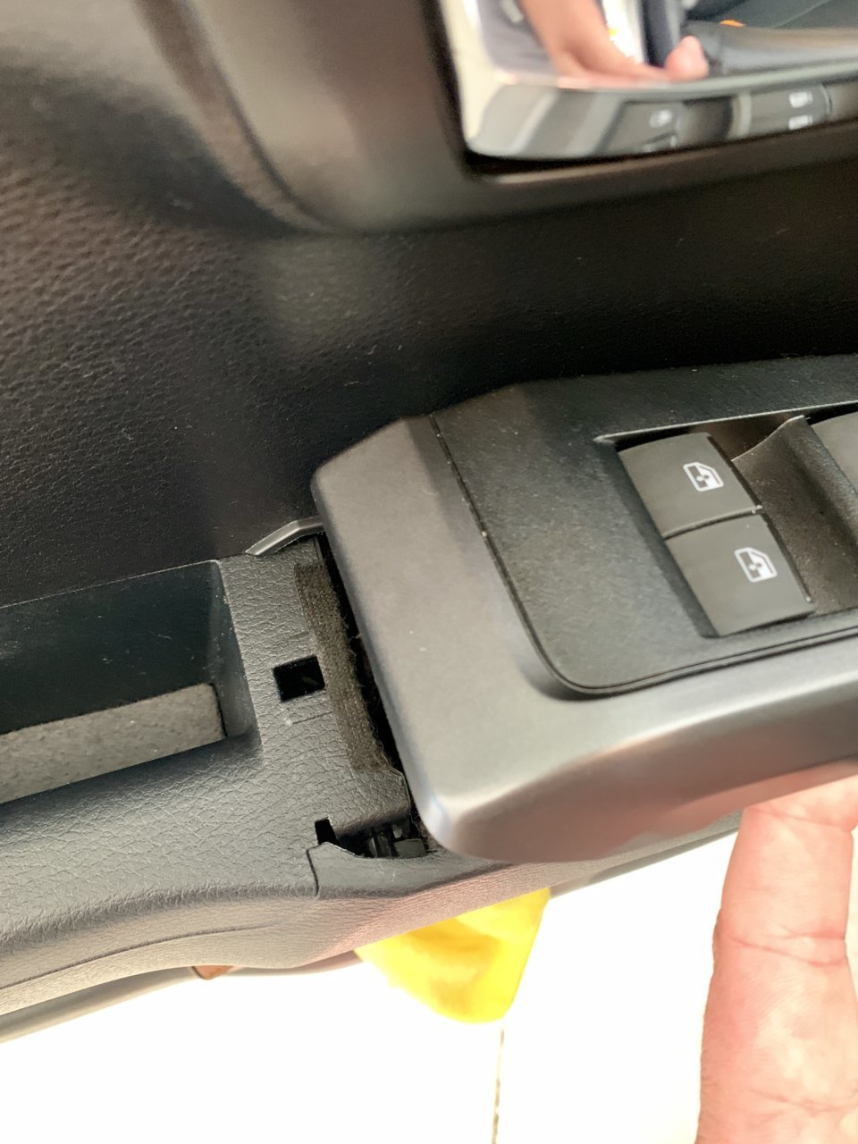

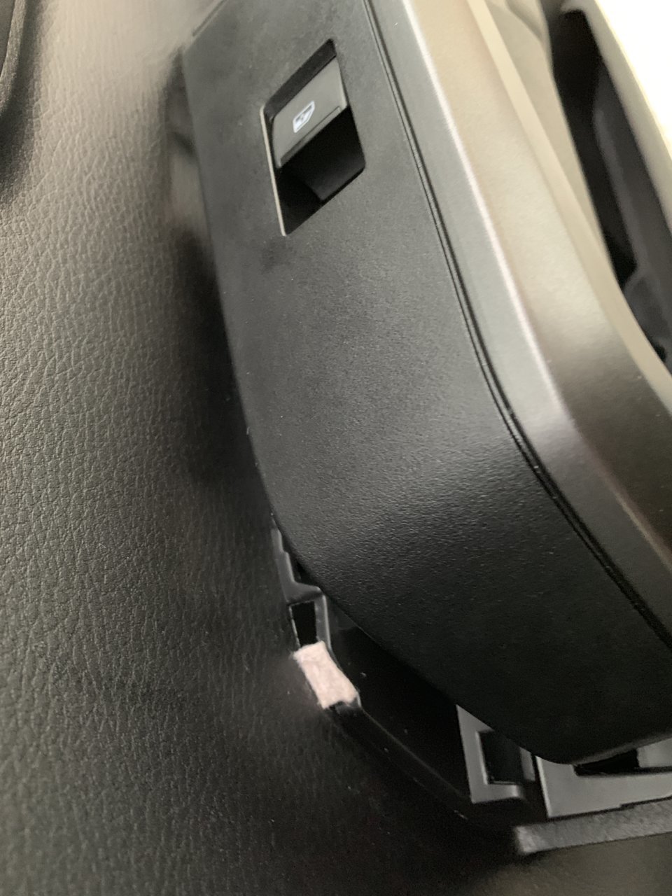

    The panel for the window switches will pop up and out without taking the whole door off. You can pop it up with some panel pullers or similar. Just work it slowly a little from each side. There are some wiring harness connected to it but there's enough space to get in there and put fabric tape along all the points that touch. IE: along the four sides where the window switches panel sits.
    Honestly, it takes $10 and 10 minutes of effort to pop these two pieces out and tape up the areas that are prone to rattle/vibrate. If $10 and 10minutes sounds like too much, might have to just deal with the rattle.
    Also notice the black noico sound deadener there in the last pic. That's well worth the effort too. makes stock speakers/amp sound a heck of a lot better and quieter road noise.
