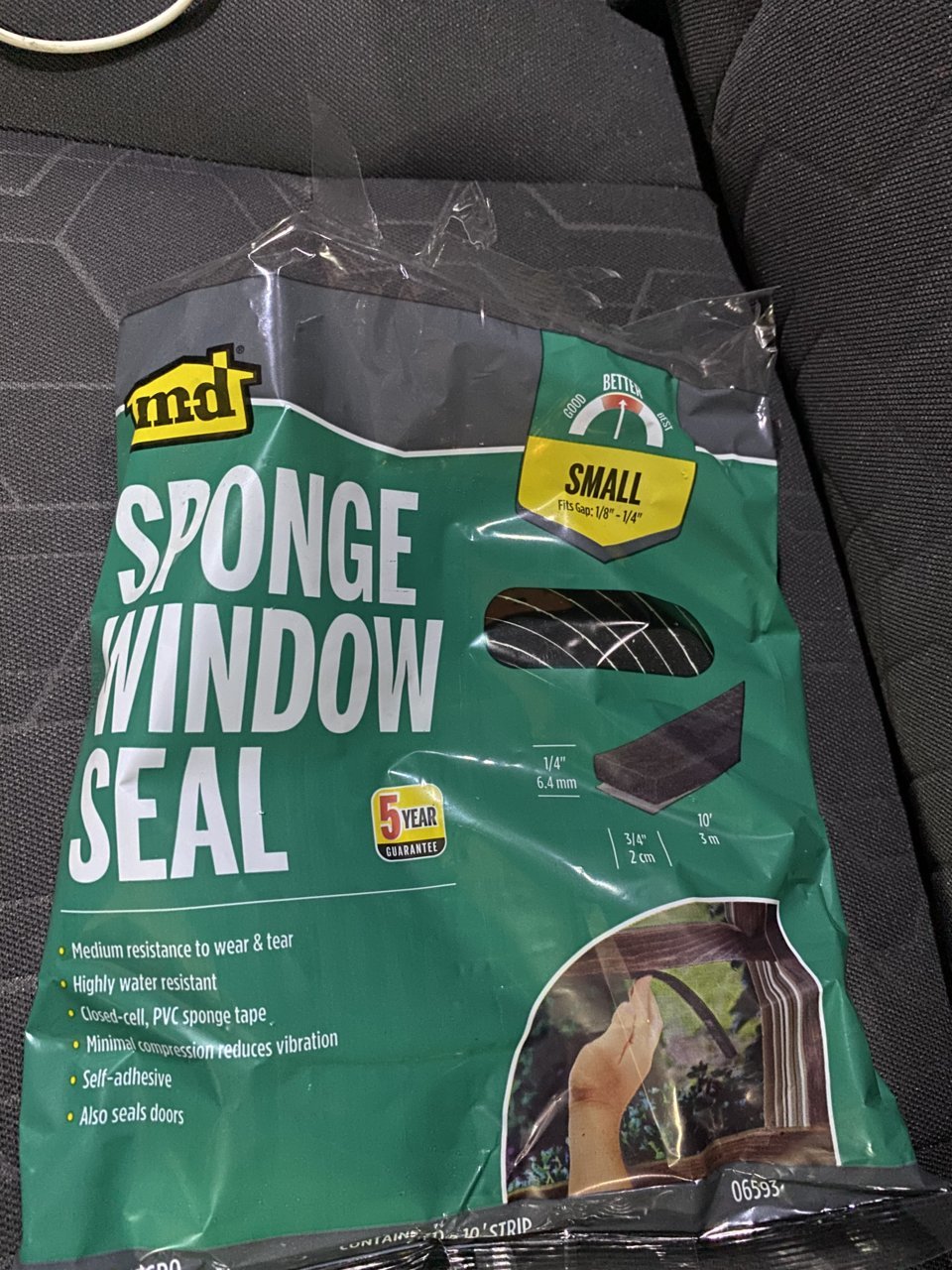

  18. Jun 25, 2020 at 8:53 PM
    #38
    AUTacoma18
    AUTacoma18 Well-Known Member
    Dec 28, 2017
    #239640
    100
    '19 TRD OR DCSB Barcelona Red
    Try this. Picked it up at Lowe’s and had worked wonders. 7D9914E4-24AA-4130-8D17-49B9F373A3F8.jpg
    AKGSD likes this.
