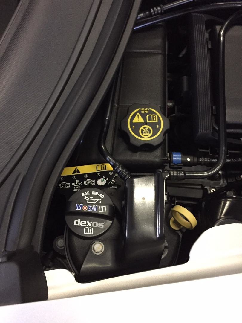

    That's a very good point. That happens A LOT with C7 dry-sump engines as the oil filler tube and coolant reservoir fill are right next to one another as shown below.
    Coolant in your crankcase can do quite a bit of damage.

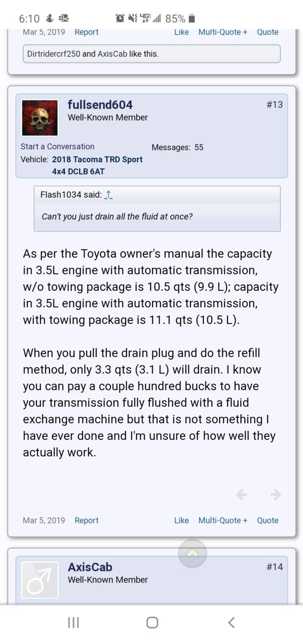

    Trans Oil capacity
    Edit: trans fluid
    clawj[OP] likes this.

    That's referring to trans fluid, though the wording is confusing and could give someone the distinct impression that it's referring to engine oil.

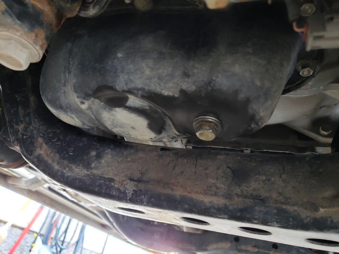

    Excellent question, since they are relatively close together but I did drain the oil not transmission fluid. I checked that again this morning to take sure. Also when I drained the oil initially and saw all the oil empty out I thought exactly that, maybe I drained the wrong thing. So I checked the oil dipstick and it was dry so I know it was in fact the oil. Them after filling the dipstick was at the correct level and with beautiful new oil on the stick.

    This is the oil right ?

    Besides, if you had drained the trans fluid you would only have gotten about 3 liters.

    Yup
