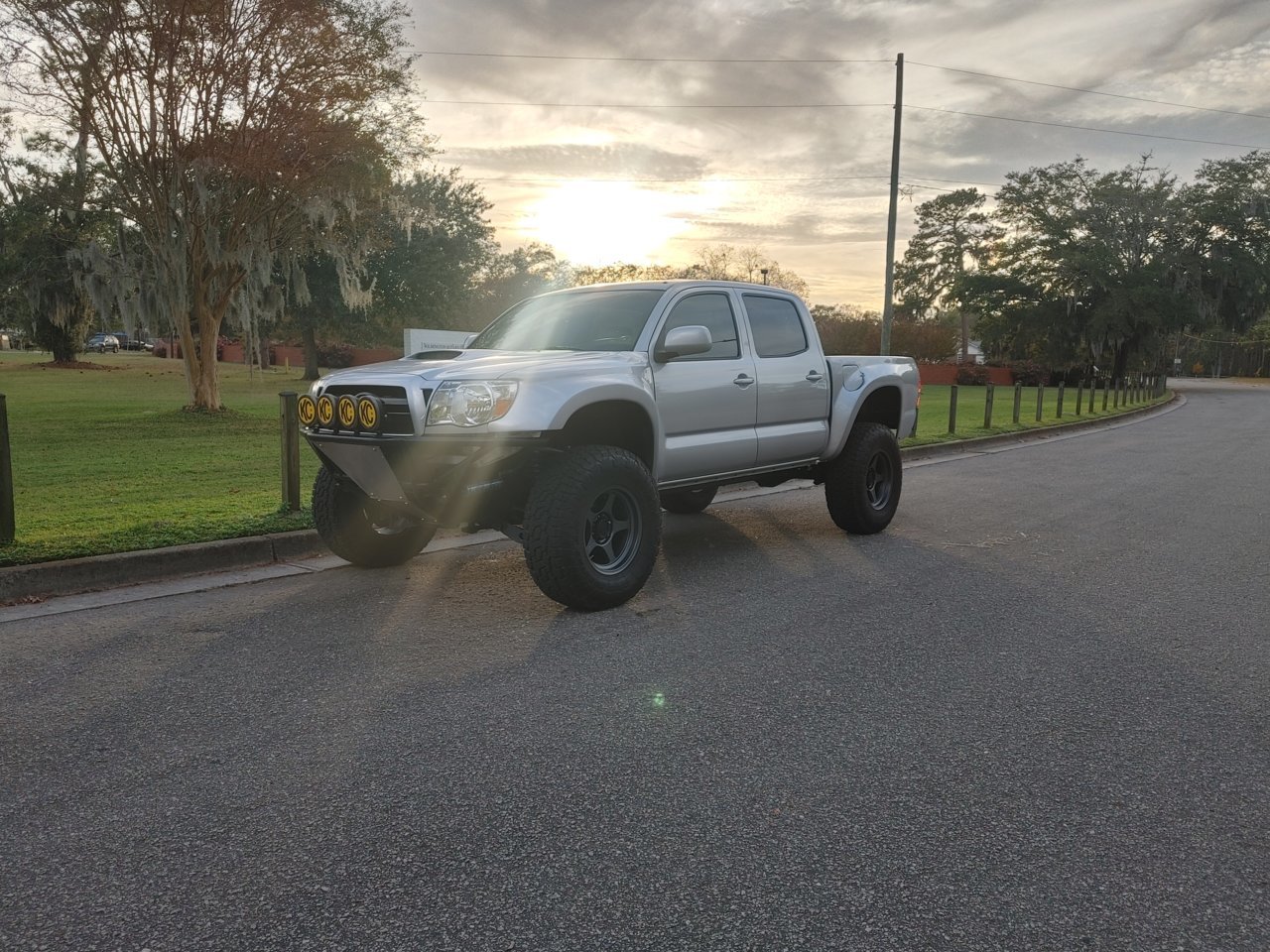

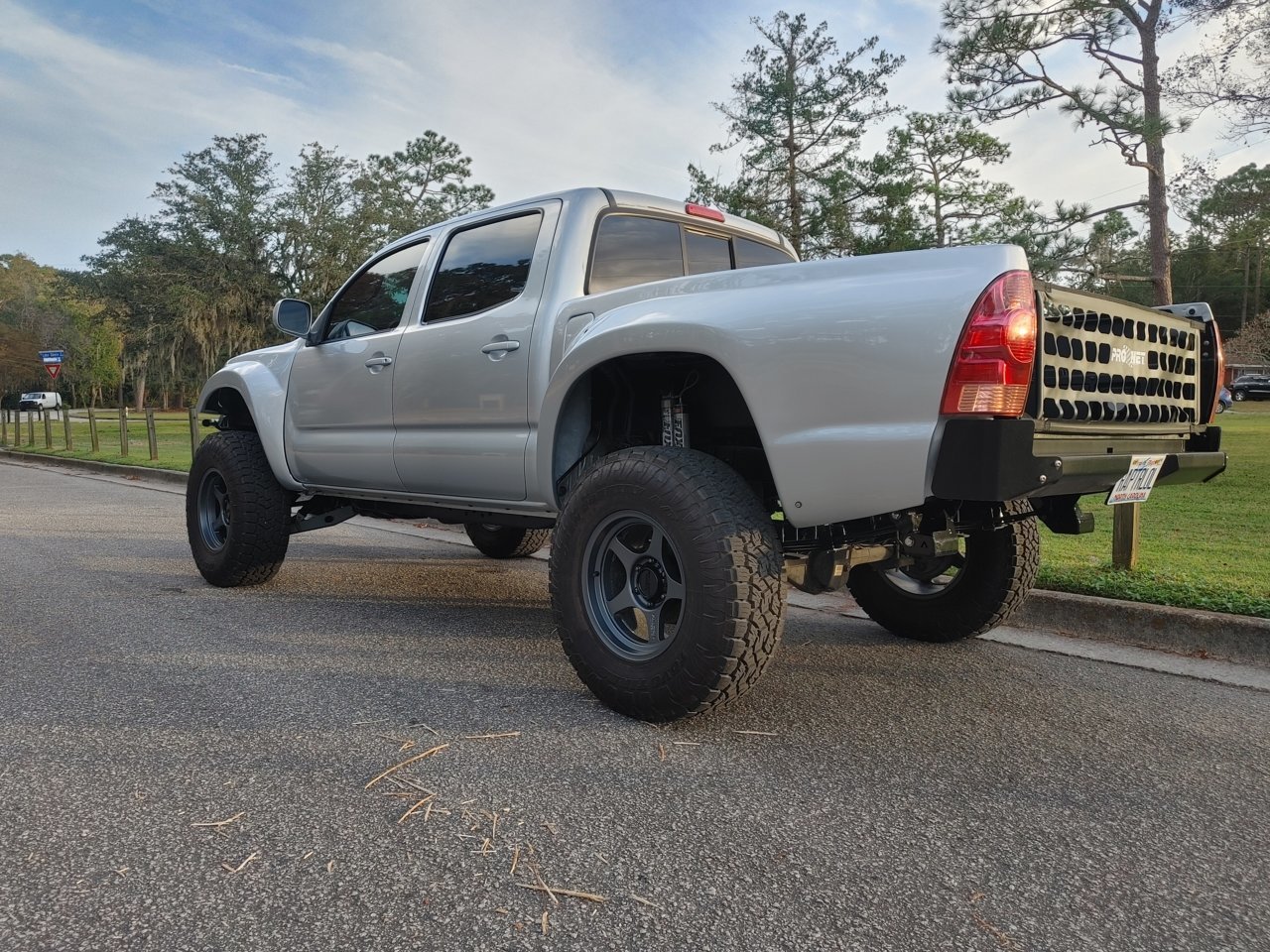

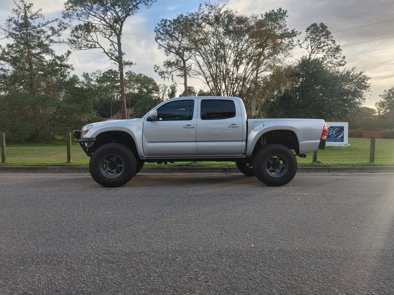

    Just looking for some personal experience on these leafs on OPTION 1. Giving me 3 inches of rear lift. Granted they are only a few weeks old. I put my 35inch spare along with 6 bags of river rocks from lowes in the bed and have been driving it more than usual trying to get them to settle.
    I am coming from dakar heavy pack that for the last 6 months I removed 2 leaves to get it down to 3 inches instead of the 4 over stock unloaded. They of course rode like ass without anything in the bed.
    I will say the icons are butter smooth and ride amazing even with a completely empty bed.
    I have fiberglass fenders so the drastic rise in the rear bedsides makes the rake look worse, but I am still 11 inches from axle to frame.
    I am debating just going to SUA just to get the ride height down in the rear.
    The truck performs really well but I hate the rear so high.
    Anyone run option 1 with no weight and get less than 3 inches of lift?

    Love the glass work on your truck. Looks sweet. Just my 2 cents but it doesn’t look like too much rake to me. Looks like it would sit you proper in the cab.

    Honestly your rake doesnt look that bad from the pics?

    I think that truck sits perfect.

    Agreed - Looks fantastic to me.
