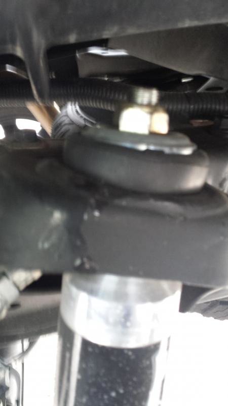

    Is this too much compression on my rear shock bushing?
    shock is Icon 2.0 w/ resi

    no.
    it's rubber it's supposed to be the cushion between those components, so you will see it compress and uncompress with the suspension.

    I think you overtightened it a little

    Mine looks like that :/

    Ya a little to much lol. I think the FSM says 15 ft/lbs. they really dont need to be very tight.

    i will loosen it then and re-torque it..

    You can't use those torque values cause the new nut is a lock nut. I just kept tightening till it stopped...and that's what it looked like.
