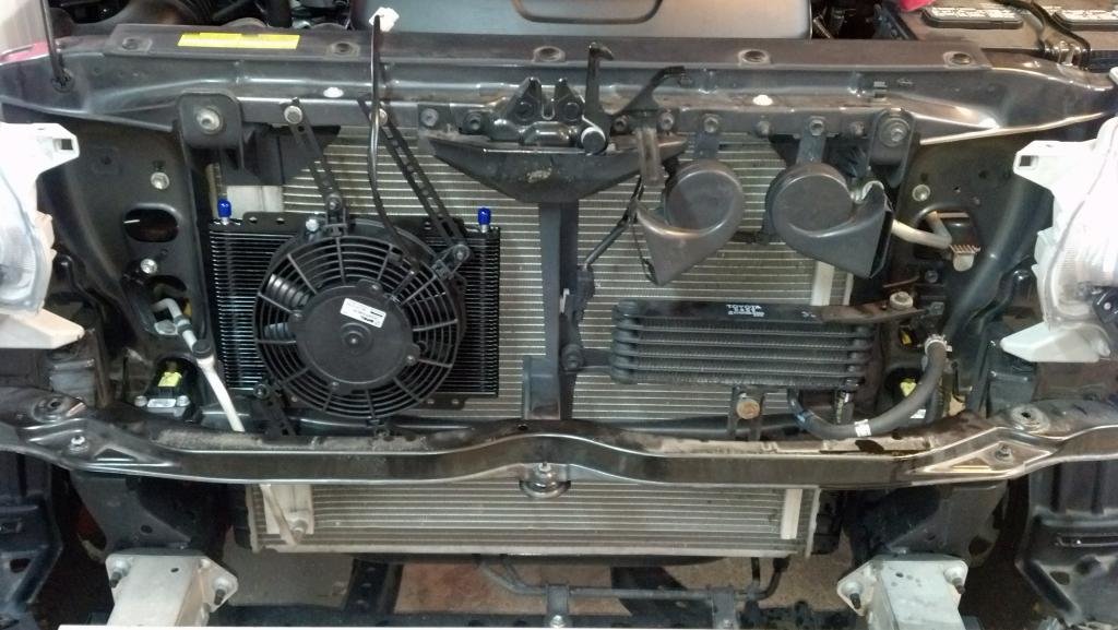

    bigcrab
    bigcrab Well-Known Member
    May 5, 2013
    #103588
    137
    2014 DCSB 4x4 TRD OR
    its in the front of rad. Here is a pic, its on the right, this person added extra trans cooler on the left
  12. Nov 12, 2015 at 11:10 AM
    #152
    btanchors
    btanchors Well-Known Member
    Jan 2, 2011
    #48592
    75
    Dennis
    Herndon, VA
    Actually, it's under the oil filter itself. Physically, on the outside, it's a lot different from the ones pictured above that are mounted in front of the radiator, but internally, the oil passes through copper tubes/fins which is where the oil picks up the copper from. I believe the cooler in the picture above on the right is for the Power Steering.

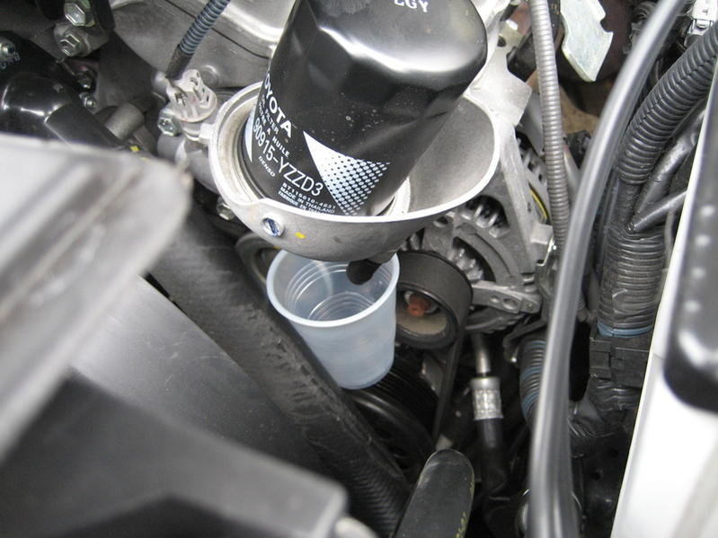

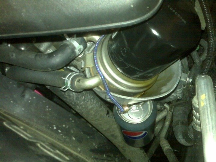

    bigcrab
    May 5, 2013
    #103588
    137
    wow you are right
    no tow package :
    tow package:
