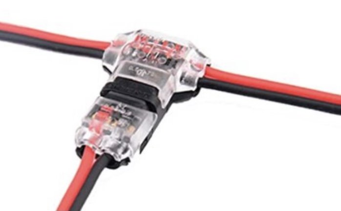

    I use a variety of below. Comes in all sorts of configurations.
    Single straight
    Dual straight
    Single T
    Dual T (shown)
    Super easy to use and have held up for years in my truck. Just note gauge wire when using them.
