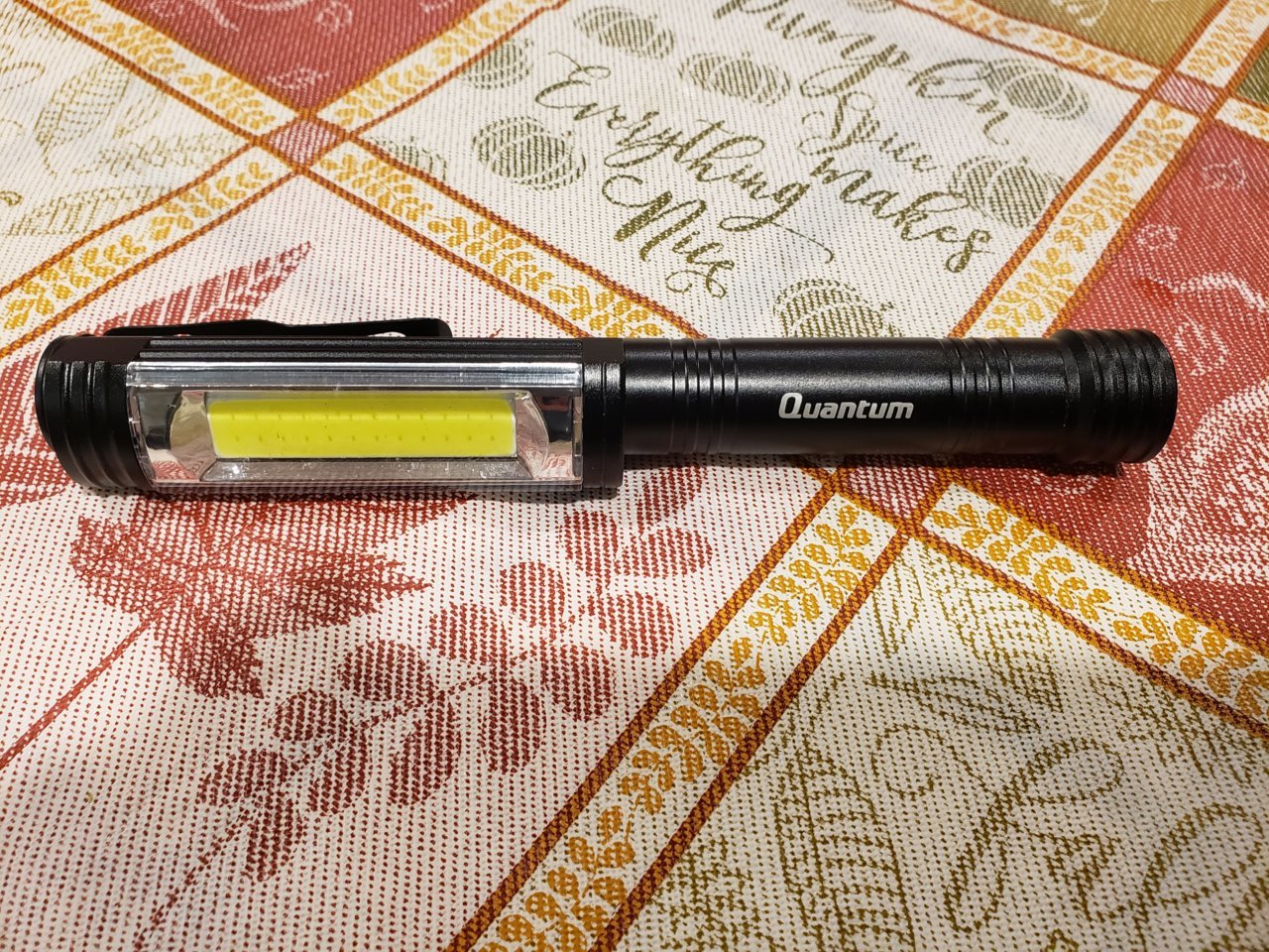

    For light I stash a led headlamp and magnetic work light which both use AAs. Headlamps are great for any night work. And keep some fresh batteries in the console.
    Magnetic base LED light from Harbor Freight for about $6, uses 3 AAs, sticks well and provides decent lighting. 2 are even better.
