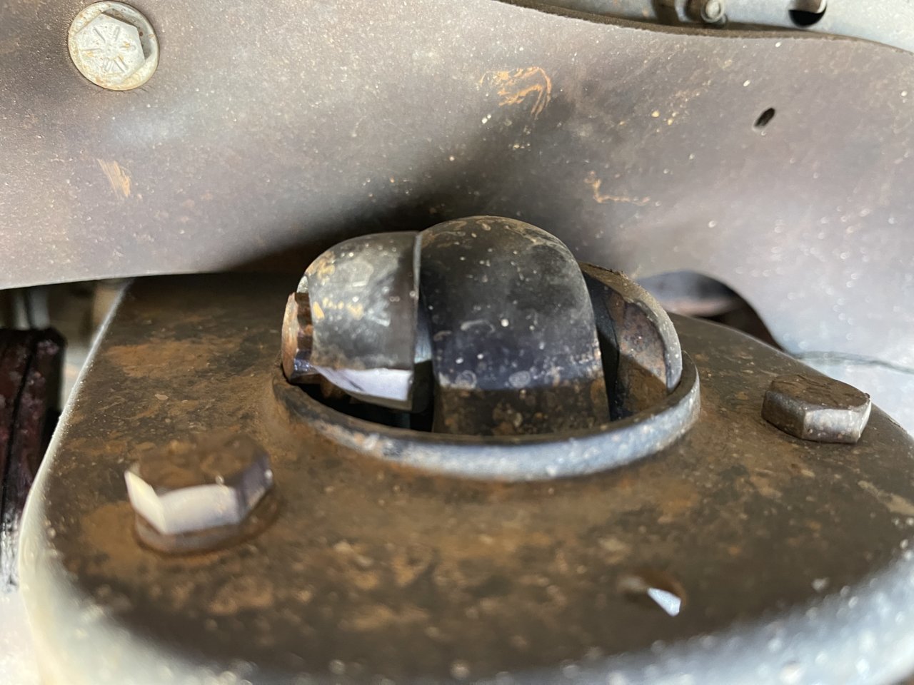

    Had my driver’s side top hat break while on a road trip. Made it home, but this was shitty to have happen on vacation.
    Has anyone else see this before?

    Yup...

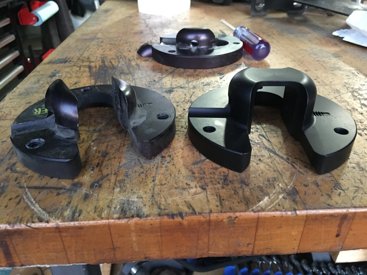

    It’s a known failure point with Icon that not a lot of people talk about. They changed the design and here’s the new version for comparison:

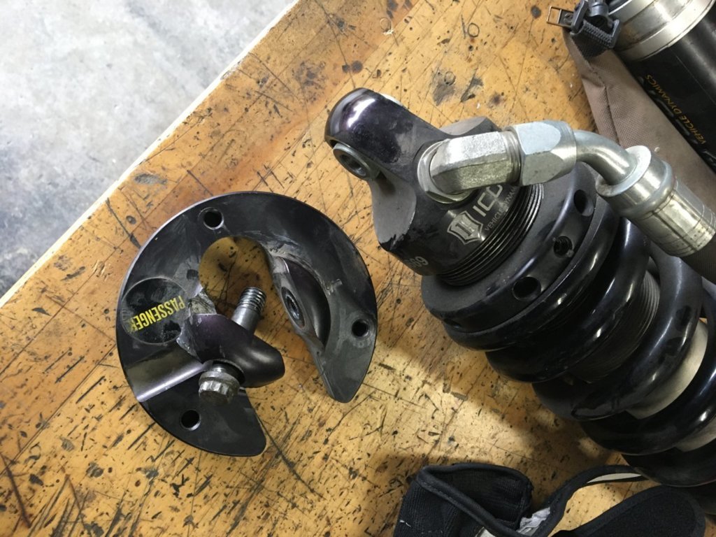

    Good luck- I just went through this last month:
    I was told over the phone that they “should” be covered under warranty even though I had explicitly told them I purchased my set in 2015. They requested that I email their sales dept with a copy of my receipt. After a lot of back and forth they said no and I was quoted about $200 for replacements parts (top hats, misalignment spacers, and shipping).

    Damnit! If they changed the design, they know it was a problem! That’s shitty.

    That's crazy. I've seen the shock tower break before the tophat before.
