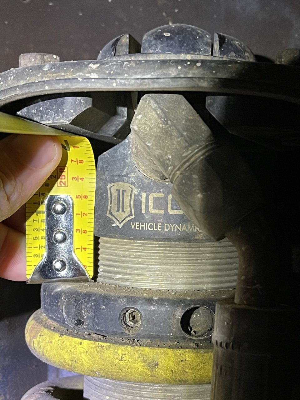

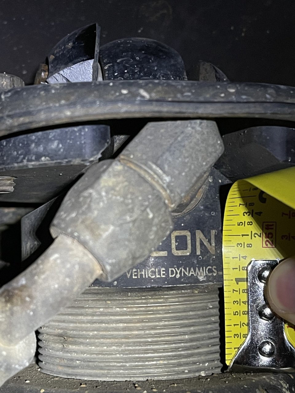

    I finally heard something from Icon!
    ...it was an email asking for a photo of the exposed threads.
    Y’all get to see them too.

    I’m curious what they’d say. Hopefully they take care of you. I’d read somewhere (in think in the thread linked above) that they said having over an inch of exposed threads would cause the top hat to be overstressed which would lead to the failure. You’re working their “safe” zone but I’ll see if i can find the quote either way.

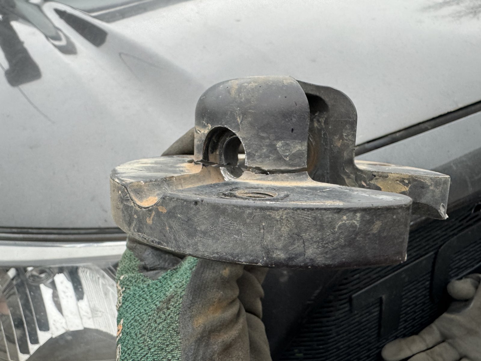

    It was not much of a response:

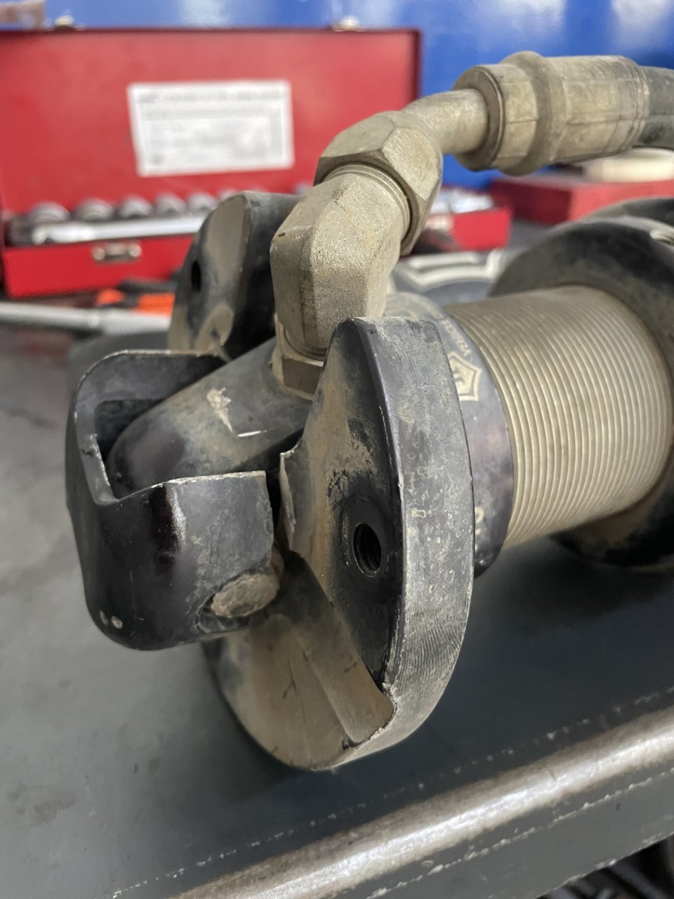

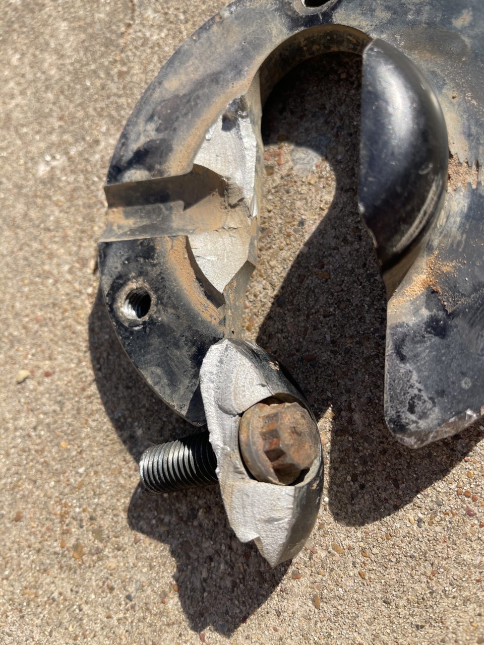

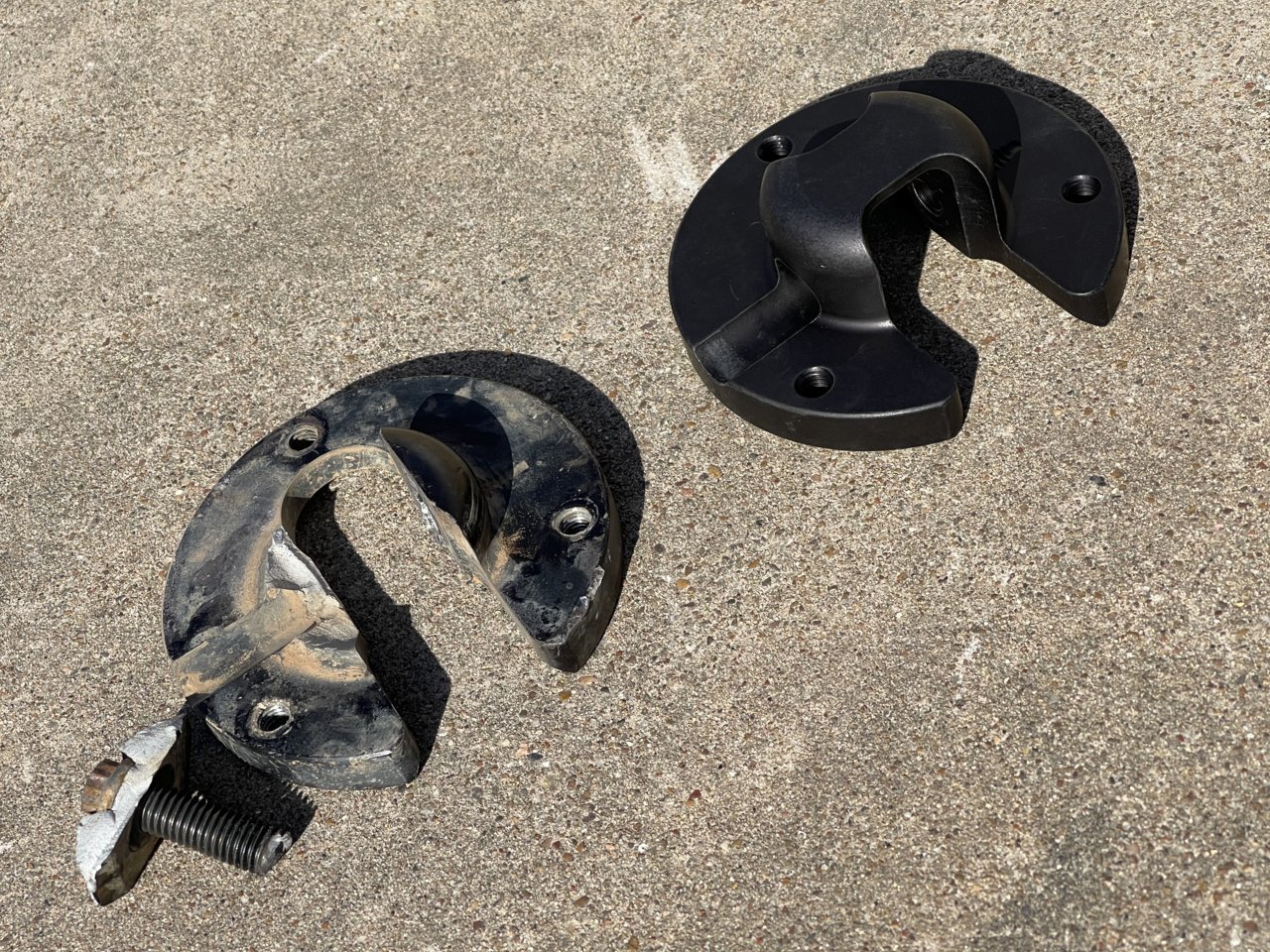

    My replacement parts showed up yesterday, so I installed them today.
    Broken one was a pain to remove given how they poke through the top of the tower, but it relented. Replacement was straightforward after that.
    Here’s the broken one before removal.
    And you can see the hat and bolt both broke.
    And old vs new.
    Also, it’s worth noting that Icon reached out to me again. They apologized for the delay and proposed a way to make it right. I’ll update if that happens.

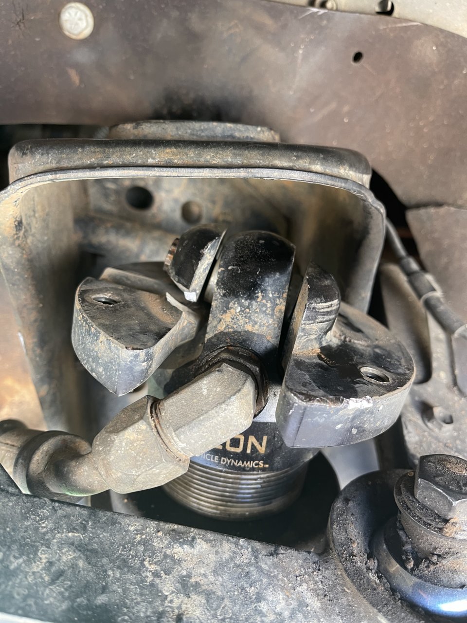

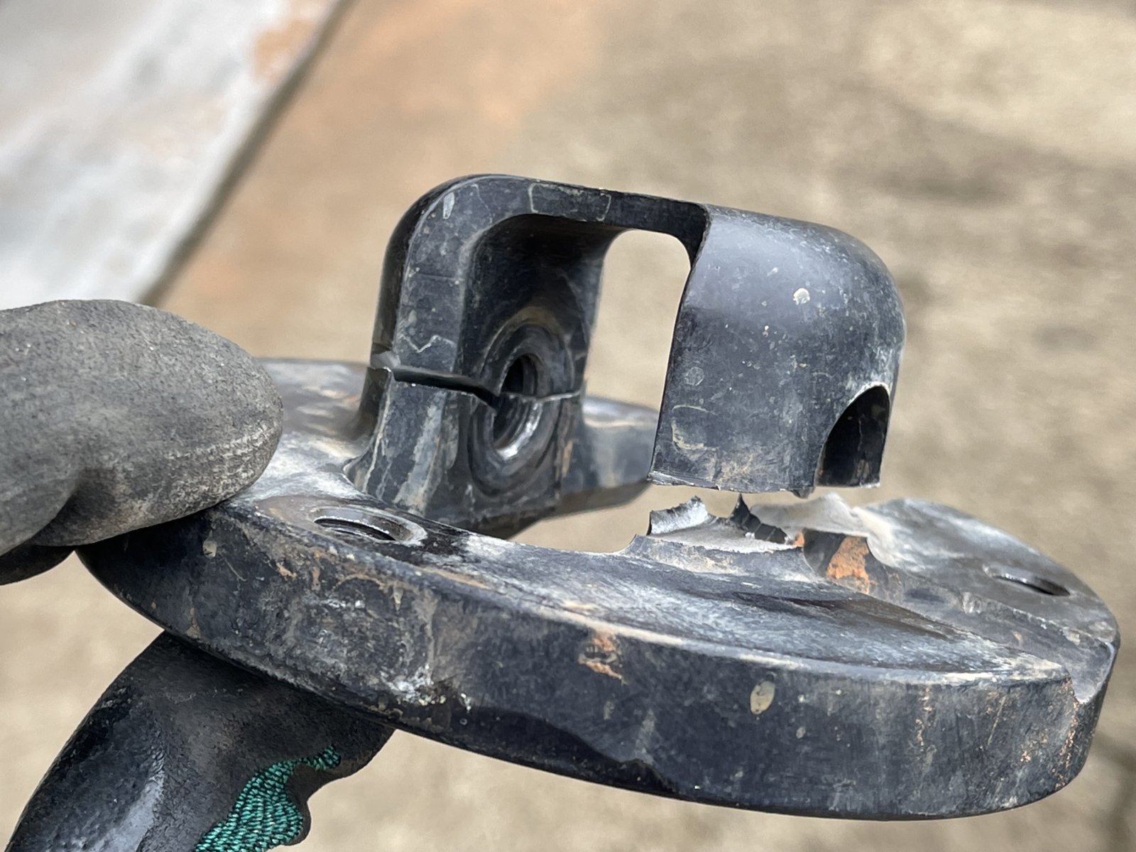

    Looks like I have a broken one too.
    edit: this was driver side.

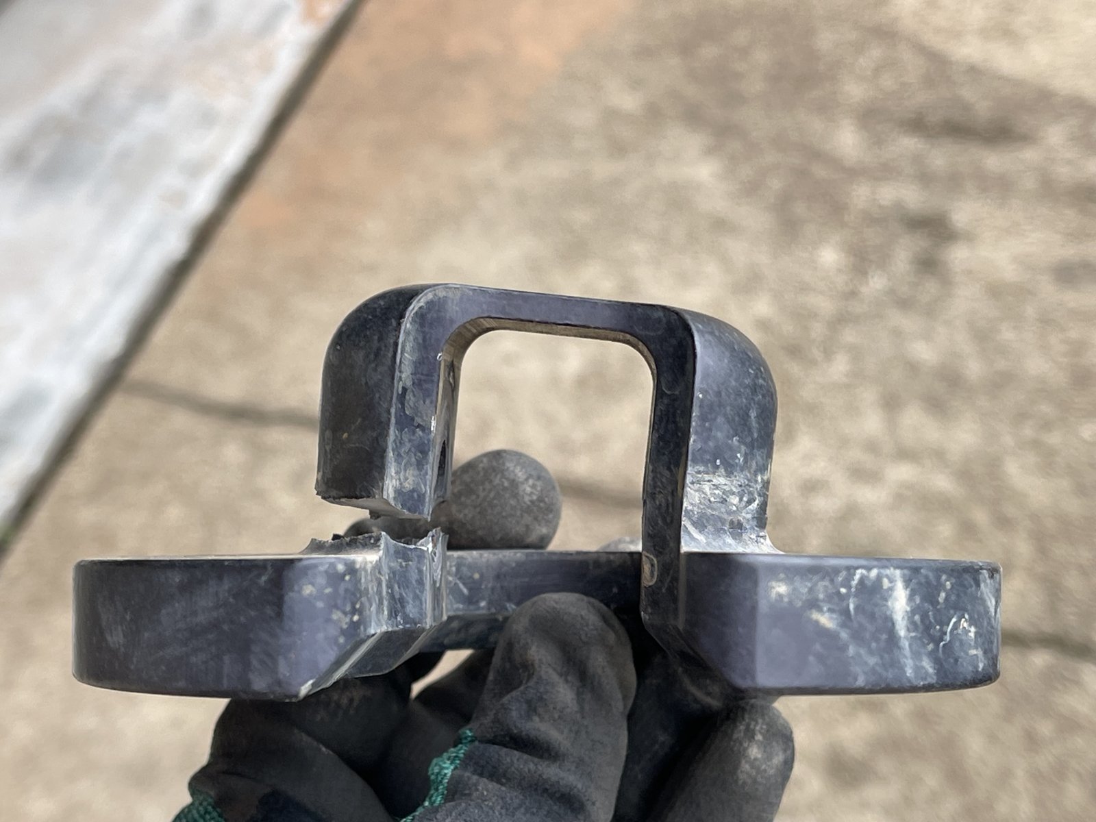

    Parts arrived late last week, was able to install this weekend and get a better photo of the damage.

    So you’ll never guess what happened.
    Passenger side this time.
