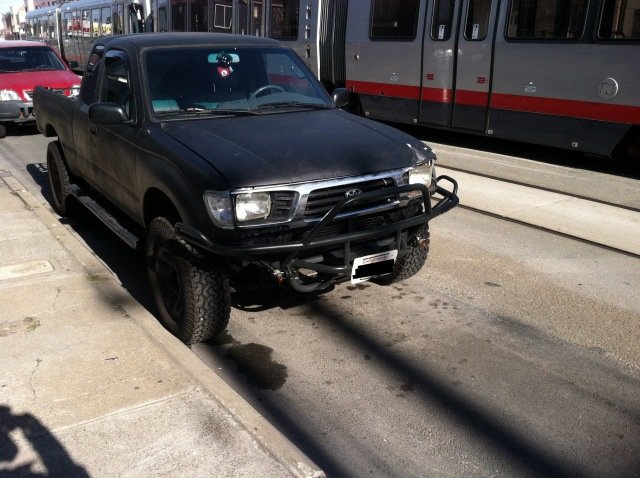

    I've had this truck for about 7 years now, don't have pics of what the truck looked like originally (used to be white).
    Its an auto (a340F) 2.7l 4cyl (8-tube 3rz) dlx 4wd 1997 ext cab with 181k. (Had stock 4.56's front & rear)
    HOW IT SAT BEFORE BEING PARTED OUT
    Progress pictures:
    Credit for this pic ^ goes to JohnboyTrd, thanks bro.
    this is where i started.
    ARMOR:
    -3/16" front skid (ISU)
    -CBI rear bumper outback 1.0
    -Allpro Baja front bumper
    -BAMF kick up sliders
    -Trail-Gear diff gaurd
    SUSPENSION/AXLES/DRIVETRAIN:
    REAR
    -OME Dakar leafs & shackles w/ BAMF shock relocation & King 2.0 10" RR shocks
    -Timbren rear bumps
    -5/8" carrier bearing drop
    -Relentless u bolt flip
    -Toytec axle shims
    -5.29 gears w/ ARB locker
    FRONT
    -Toytec boss coilovers w/600 lbs springs
    -Total chaos UCA's
    -Toytec diff drop
    -Sway bar delete
    -CVJ reman'd axles w/ silicone boots
    -5.29 gears w/ ECGS bushing
    BRAKES/WHEELS:
    -BAMF BPV
    -Bajatacos ebrake cable extenders
    -33x12.5x15 General grabbers
    -1.5" BORA wheel spacers
    -Extended SS brake lines
    BODY/EXTERIOR:
    -Bobbed 13 1/4" out of bed
    -Tailgate net
    -aftermarket taillights
    -debagged and antenna removed
    -linerextreeme DIY Bedliner
    ENGINE/EXHAUST:
    -borla muffler and Magna flow cat w/ bedside exhaust
    -removed a/c system
    -Reman'd 3rz engine
    -blue silicone vacuum lines
    -4" deck plate on air box w/ AFE filter
    -04 exhaust manifold
    ELECTRONICS:
    -Red top optima battery
    -Touch screen kenwood navi w/ type R alpines/JBL's
    -Under hood lights
    -bed lights (Led strips)
    -Led pods on bumper
    -Led pod on windshield
    -uniden pro 520xl CB radio w/ 3' firestik & fire-ring cable/coupler
    -ARB cksa12 compressor
    MISC:
    -cbi hood mounts x2
    -mag light w/ quick fist
    -relocated windshield washer resi
    -hilift jack
    -rear diff breather mod
    -new steering rack (rack dr)
    -new ITR/OTR/LBJ
    THINGS FOR SALE(PM me for pics):
    Use link in sig for part out vv

    just put it on sunday night.
    only bad thing is i didn't realize my skid plate won't work with this bumper.. so I'm thinking about cutting/bending the skid plate so it will work. i was able to cut up the stock skid plate and put that up temporarily.

    made my license plate holder a little better than just a shoe string..
    also painted the AP orange on the bumper and did some touch ups.
    took those nerf bars off today as well in hopes i will be getting my BAMF sliders soon.
