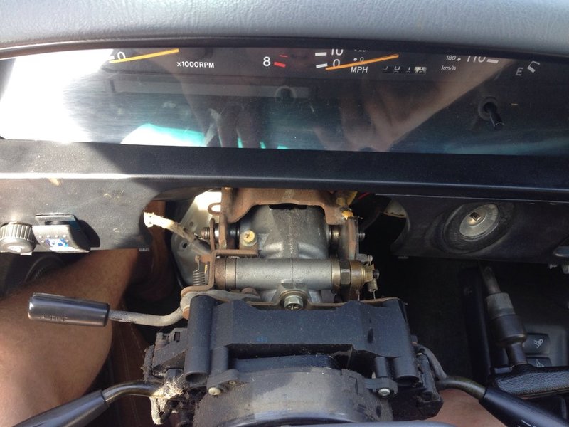

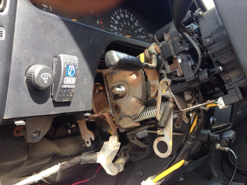

    Attempted steering column weld mod today and failed. Couldn't get the column out, it's much different on the 95-97 tacomas. Somehow you need to get that shiny bolt out of there. I'm not even sure how the hell they installed this thing..

    That looks like a nightmare. Can you take the assembly out then chip away at it from there? Probably more than you were planning for, but they had to get that sob in there somehow...

    That's what I was thinking too.. But I seriously have no idea how to take those bolt ends out, it looks like maybe they were pressed in there but I don't know how to pry them out/get them out. Without taking those out you can't get the outter wing plate off to get to the part that needs to be welded.
    BDN had the same problem

    Kinda but you can actually get that bolt out somehow. This thing I have no idea how to take apart, you'd have to see it in person. Maybe I'll show you, it's only 5 little Philips screws. My steering column is defintely completely different at that section compared to the later models.
