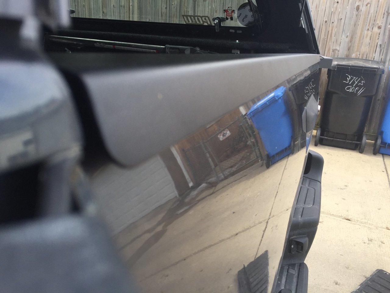

    This is how a Relentless Tailgate reinforcement plate affects a Leer 100XQ (manufactured in 2008). The 100XR also has a frameless door style, but uses a different bottom edge seal on the door.
    I am looking at different option to replace the small seal flap on this so it closes better. Even now, though, I have no leaks caused by this seal.
    Something else to consider is that the stock tailgate and cap have a gentle curve to them. The aftermarket shell do not; they have straight glass or aluminum frames. This means you should actually be able to get a better seal using a tailgate cap.
