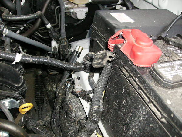

    The Leer dealer I purchased my topper from usually wires the dome light in the topper to the taillights. It's good in that you're less likely to walk away from the truck and leave the light on, but it's always annoyed me. I'd rather be able to use the dome light in the topper and not leave the truck lights on.
    Here's my solution/parts list: weather proof fuse holder, 15amp fuse, 16ga wire, wire loom, and some wire ties.
    I install the fuse by the battery:

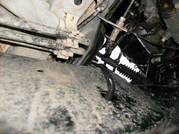

    Fed the wire into the frame:

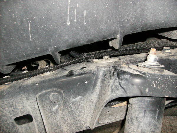

    Following the frame next to an existing wire harness:[​IMG]

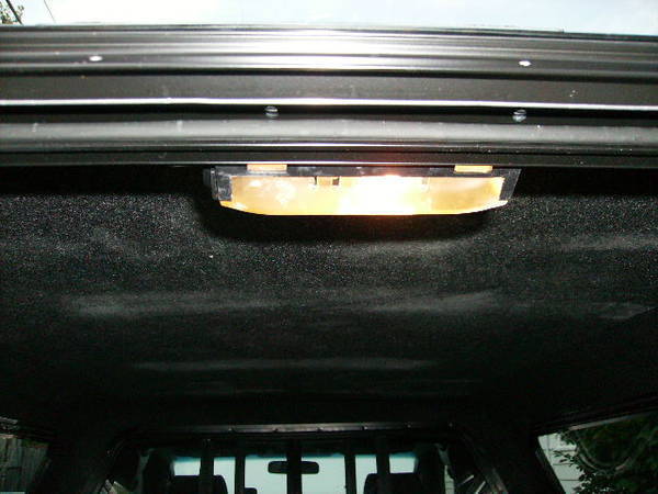

    The new power wire connects to the wire from the dome light, and now it works when I want it to without having the headlights on with the key in the ignition.

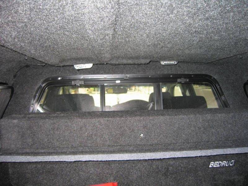

    Mike, this is Miguel... I did the same to mine, my setup implements prior to send power to the topper lights it goes via a sensor that can be controlled wirelessly... and by this I can activate or deactivate my three cap lights from my remote. Honestly sometimes I forgot to take the remote and it is not good... but takes time to get used to it.
    I think the best setup will be to use a pin switch (like the alarms) to activate the lights by opening the cap's main window.
    Here is a photo of lights 2 and three, number 1 is the same as yours.
