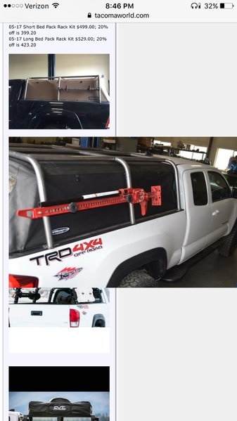

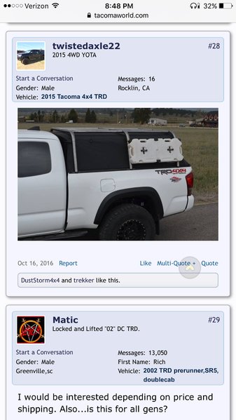

    Soft topper with all pro rack over it is what im doing. Currently run the soft topper ( waiting for shipment of the all pro rack :anonymous: ) and i love having dry out of sight storage. Easy to fold down is nice too. The rack over top will allow me to mount recovery gear and a rtt up top. Will update pictures when rack arrives heres a few of a truck with one though

    Excorcist and Addiction I appreciate the soft topper advice, I would like to hear about that all pro rack when you get it in. I was wondering if something like that was out there... Of course there is haha. Runtacorun I'd really be interested in seeing that topper as well, same one that I was looking into. You have a ball park price on it? And lastly Stun gun that habitat or a flip pac would be nice, but a little out of my price range at the moment.. trying to spread the funds throughout the truck. Appreciate all the feedback so far!
