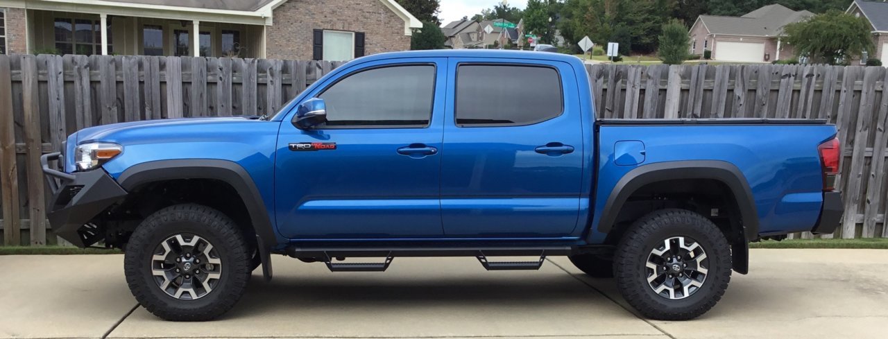

    @Jacked Burton, Thanks for the heads up and the pics. Installed mine last weekend and they are solid. Bilstein 5100’s on all four corners front on highest setting and torch AAL No change in ride quality as far as I can tell....it’s a truck, rides like a truck. Here’s mine. Thanks again

    Jdtaco12, No issues at all. Once settled I am at 1-1/2” increase in the rear. I have bilstein 5100 front and rear with the front on the highest setting. Rear is slightly higher than the front but very minimal after it settled. I have made several mid range trips (200-300 miles) and the ride quality hasn’t changed from stock as far as I can tell. Very pleased with them.
