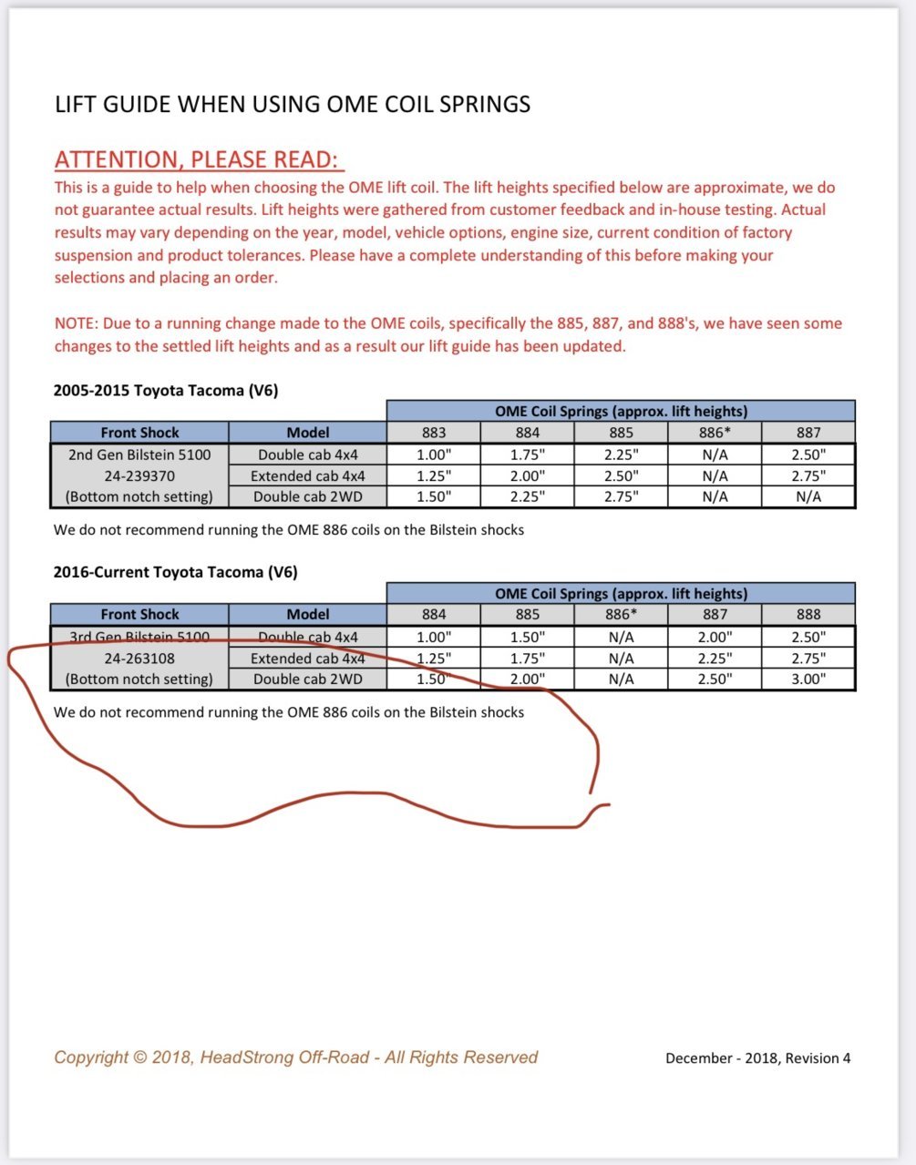

    they don’t work with stock shocks, who recommended the 5100s?

    Lot of confusion and misinfo on the OME coils. 5100s were made for stock coils.
    I was gonna go OME but heard stories of them sagging over time. There is debate as to the tension rate on the stock vs OME. Bilstein specifically designed the 5100s to be with stock shocks though, and the warranty only includes them being used with stock.

    You need to research more. Bilstein makes great products, yes, but it’s been known for years the 886 coils are not meant to be used with 5100s on the 3G. Harsh ride with premature shock failure, with or without bumper/winch.
    If you are going to run the 886 coils, just use the shocks they were designed to go with, the nitrochargers.

    5100s are not an impressive shock by any means, even with stock coils. The only misinformation out there regarding the OME coils sagging is from 3+ years ago. The newer coils with “x” on the part number do not sag when applied to proper weight needs/restrictions up front.

    I might love you a little bit, lol. Can you post the link to that page? You just saved me a bunch of time and money!

    I also might hate you a little bit. You basically just cost me $150 lol.
    AND YES YES, I know it saved me from having to spend more later. BUT I'm still going to cry right now.
