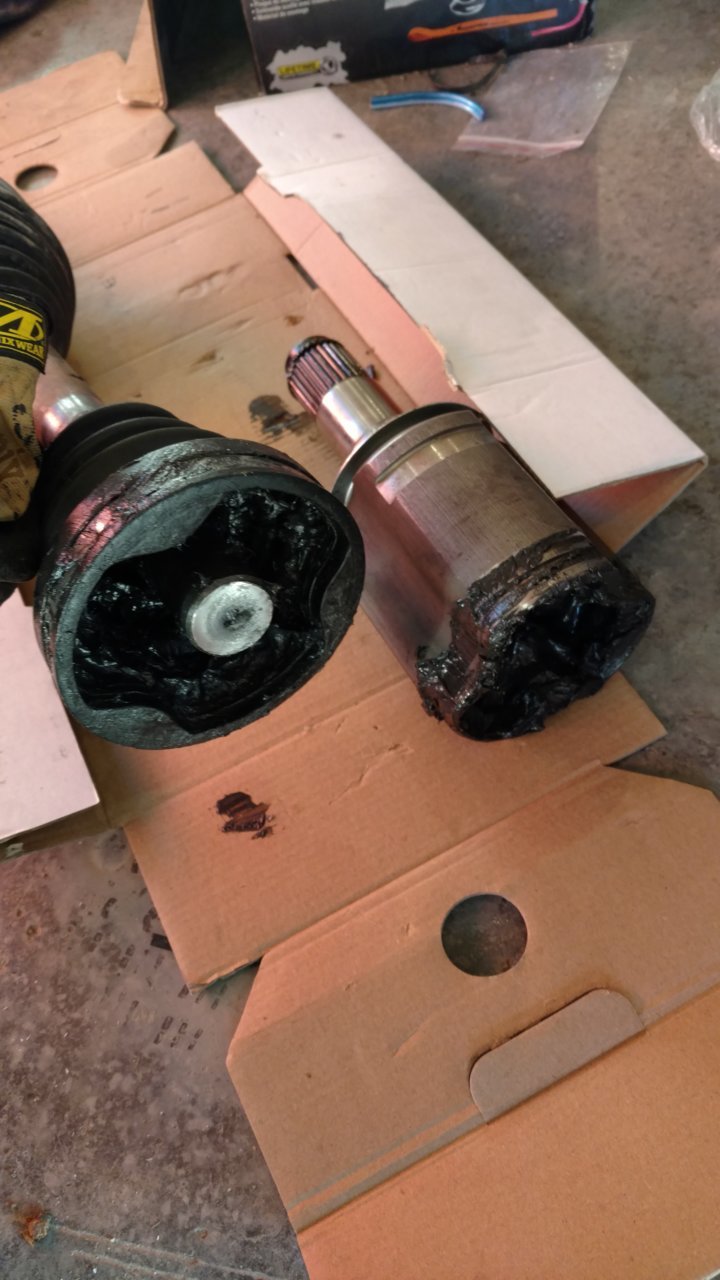

    Many years ago, rebuilt $69 half shafts were a good thing. Now days, with everything made in China for 10% of what a quality part should sell for, there's more profit for the suppliers to just sell new China junk. Many TW members have had fit and quality issues with box store half shafts. Leaking due to undersize seal surface, or inner CV joint falling apart because the shaft is too short.

    This is a cheap China shaft virtually new in a snow drift. I would pay the $57 for one boot and keep your Toyota shaft if you can. IMG_20190317_183506151.jpg
