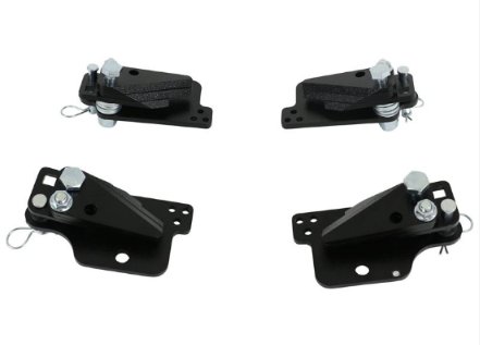

    Anyone on here installed these on a Tacoma and want to provide some feedback?
    I tow a fair amount (4K-5K lbs) but I want to avoid airbags on this truck since I also off-road any chance I get.
    Also I'm running the OME Dakar leaf springs
