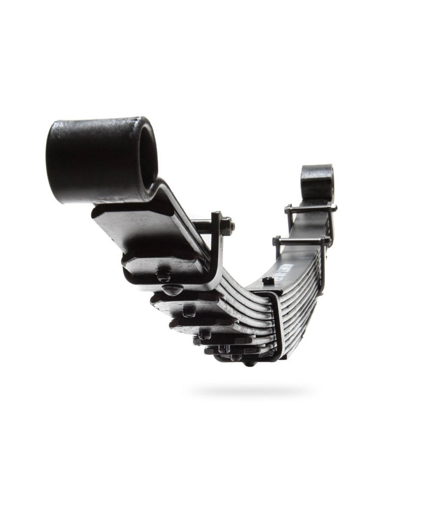

    deaver u402 leaf pack. you can look in my build thread for pictures.

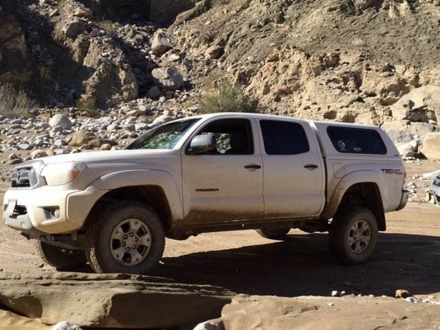

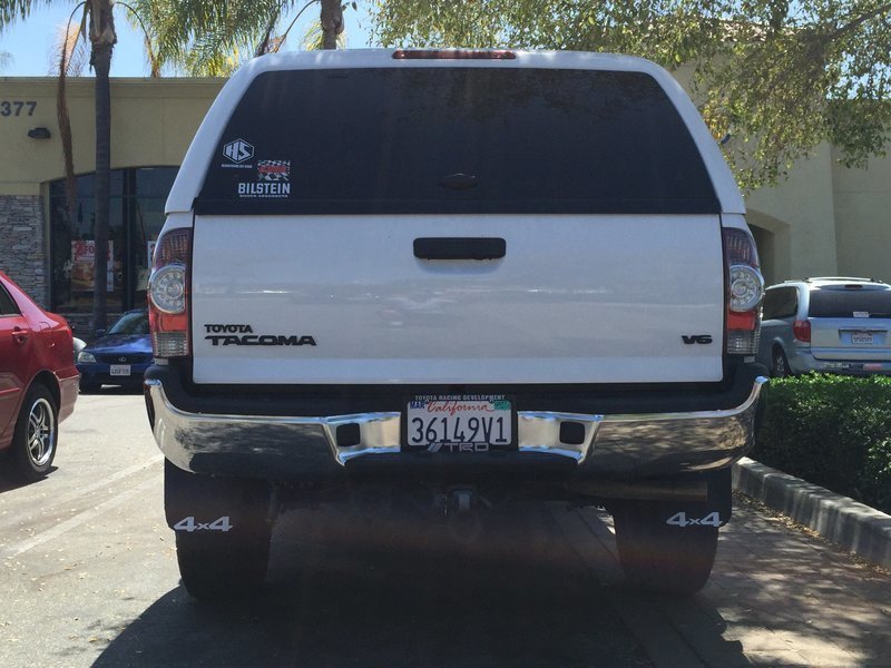

    I am so happy with my OME Daker CS047R leaf packs. I have a shell and load my bed up all the time. I also pull a trailer with no sagging at all.
