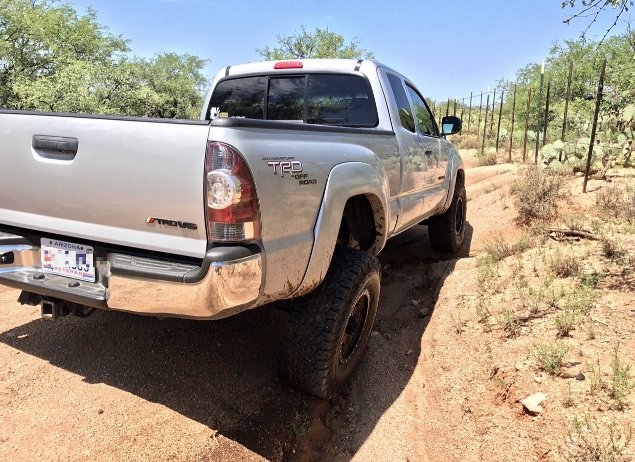

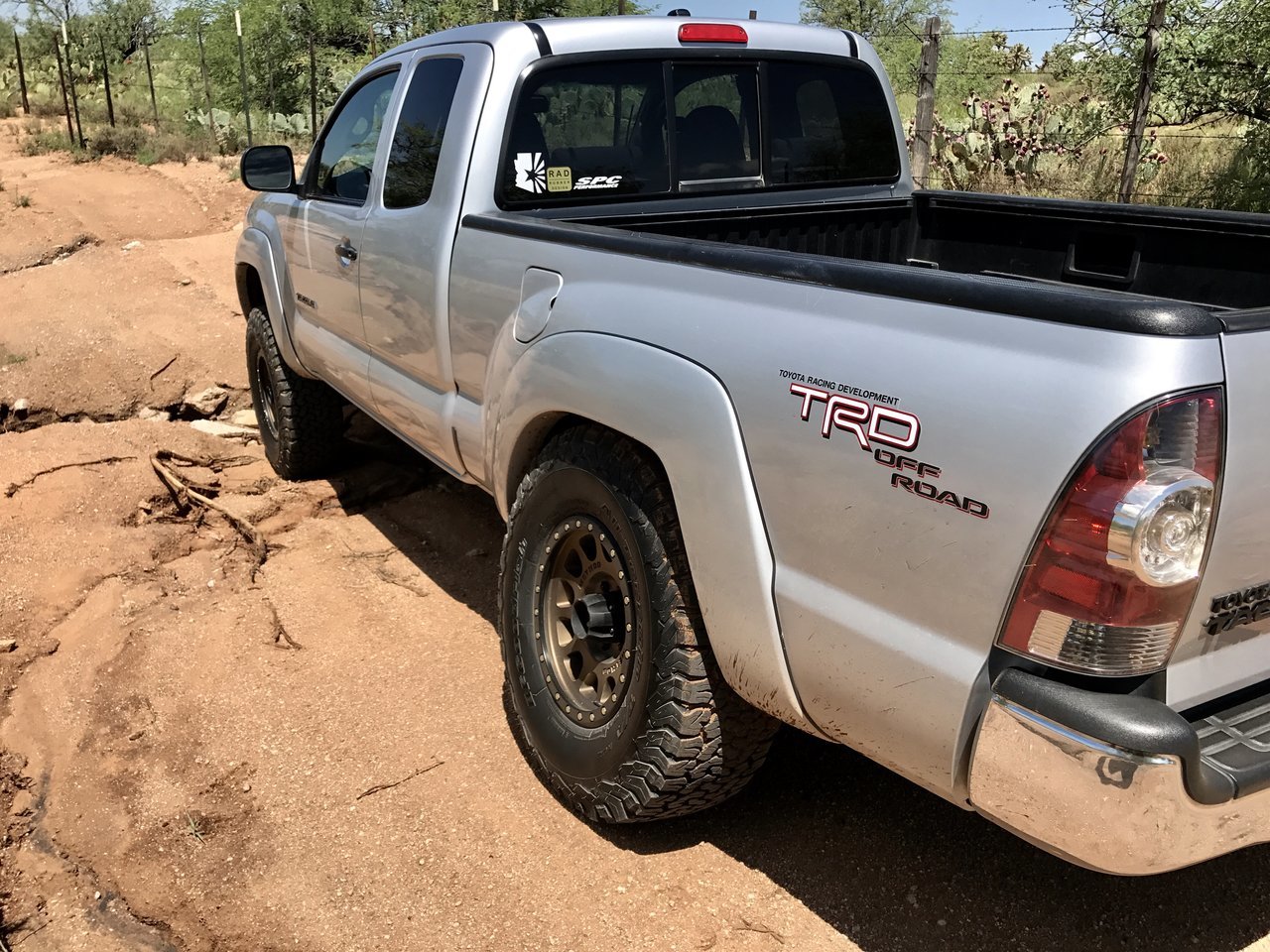

    For those wondering about the updated dakars with anti squeak pads, mine have them and I haven't heard a peep from back there. I drive off road moderately-heavily 3-5 times a week and I am nothing short of in love with them. Wether I'm crawling through rough shit, or doing 100 down fairly maintained dirt roads, these springs seem to take it and keep chuggin. Some up and down flex pics:

    Do you have the "clunk" issue using the fox shocks with the Dakar leafs? Idk if those are the same length than the OME shocks or if any length would work well with them
