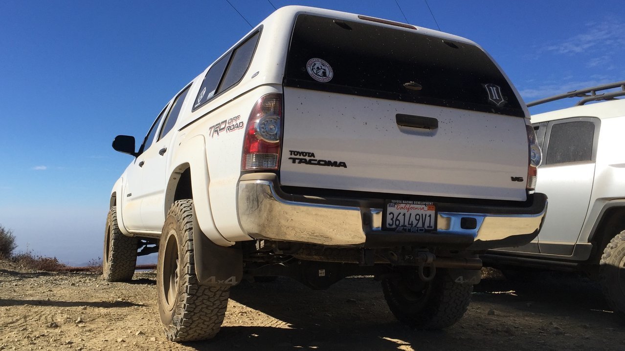

    Hi David,
    In my opinion I think the EL096R's will work for you. I have the CS047R's the preceding OME part number and I carry lots of gear and have the same shell and also pull a trailer.
    I got a 3" lift. I have no sagging when loaded up. Really... My 15 Tacoma rides great loaded up.
    You will not be disappointed.. I am stoked , I had AAL's and they sagged. The OME's leaf packs are awesome.
