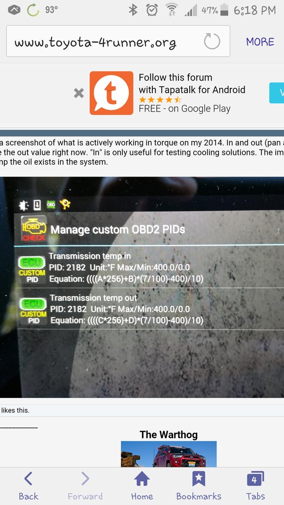

    I have a 2012 Tacoma, how do I get the transmission temp to show up on my app. I have just a Bluetooth scanner?

    Screenshot_2016-06-29-18-18-49.jpgThis is what I have for my 15.

    Torque Pro app.

    So the built-in transmission temp methods in Torque Pro don't work on the Tacoma then? You have to program in a custom solution?

    Custom PID.

    So using this PID, when I change the transmission fluid I no longer have to put the truck in Check Temp Mode?

    I have a Scangauge II, but yes same general idea. Note some give you 2 transmission temps, use the pan temp and not the converter temp.
