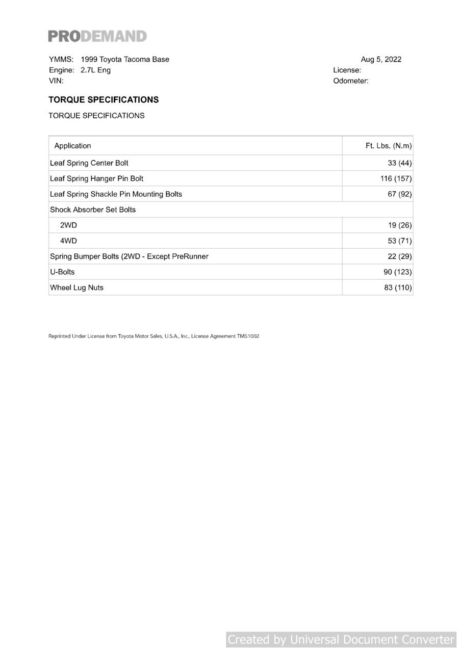

    Can anyone quick link me or do you have the Torque specs for the above listed truck it is extended cab. For the shocks, struts, leaf springs an sway bar links an bushings. Another stupid mistake on my part of getting ahead of myself an not doing them to spec. Thanks! I know they are on here somewhere. I downloaded a pdf maintenance manual but it has no glossary or index so its needle in a haystack.

    Is this what your looking for?
    In the future you may want to post in the 1st gen section as your truck isn't an X-Runner and not many people hang out in this section.
    Front
    Rear
