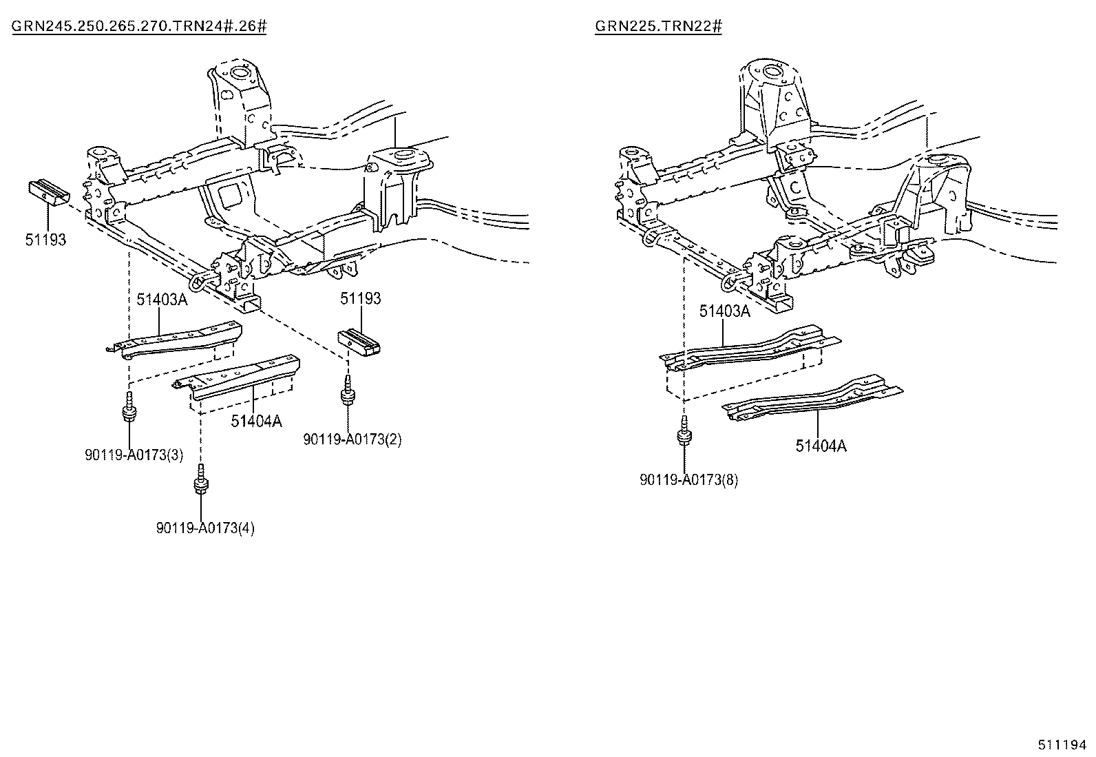

    and wanted to know if anybody might have the specific Torque Specs for the 7 or 8 bolts that secure this piece, 51404A and 51403A in the diagram below
    part# - 51404-04020
    part# - 51403-04020

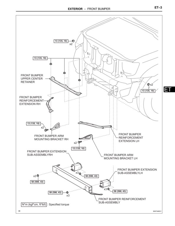

    i gave that long list a once-through and got close to the item of concern but did not quite find it or am i overlooking it
    it is in this general area, but its part of the frame, which i did not find the first time through
    is there a 'Body' section in that manual with the specs?

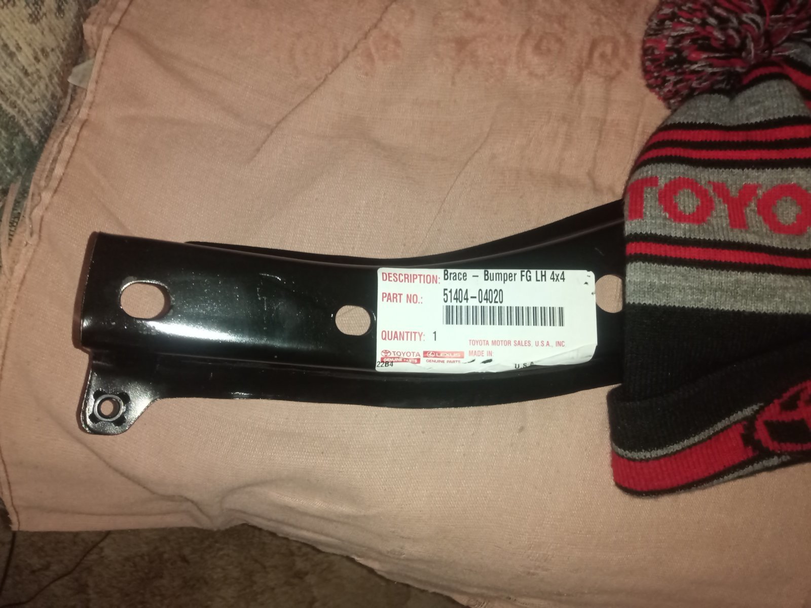

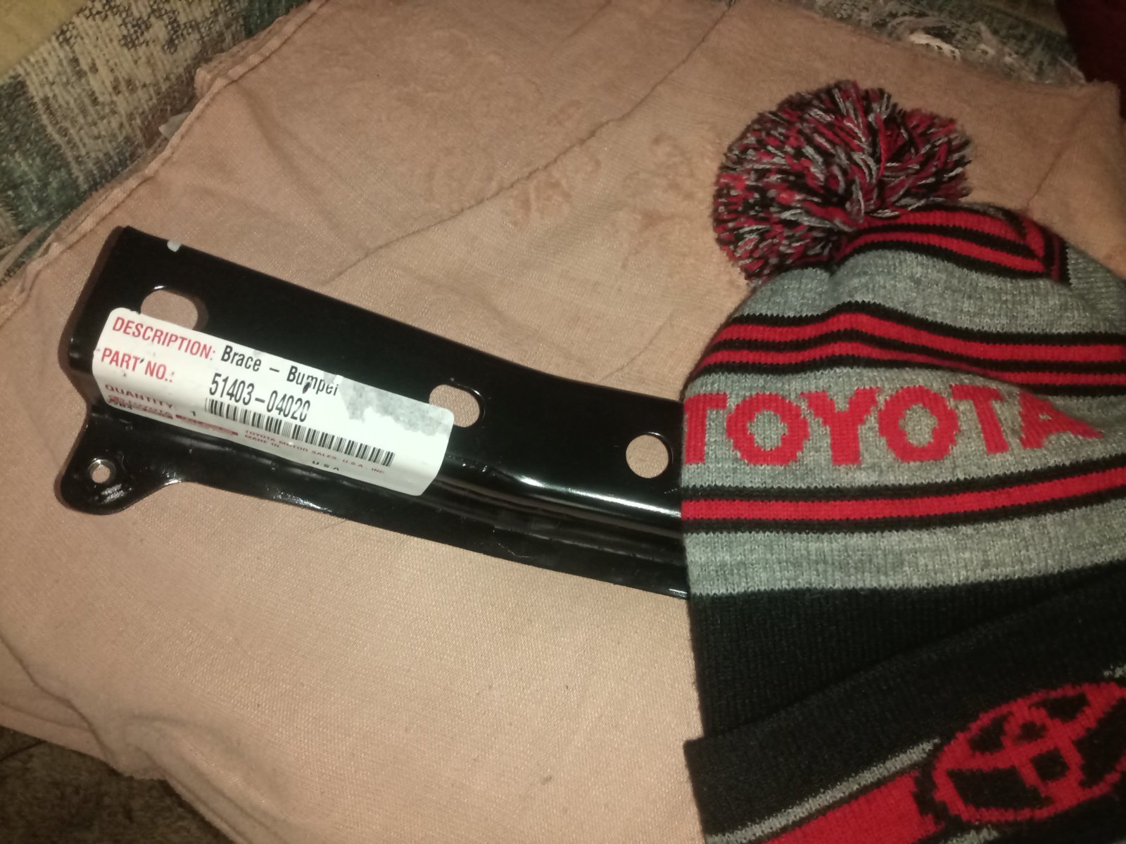

    For These braces
    7 bolts

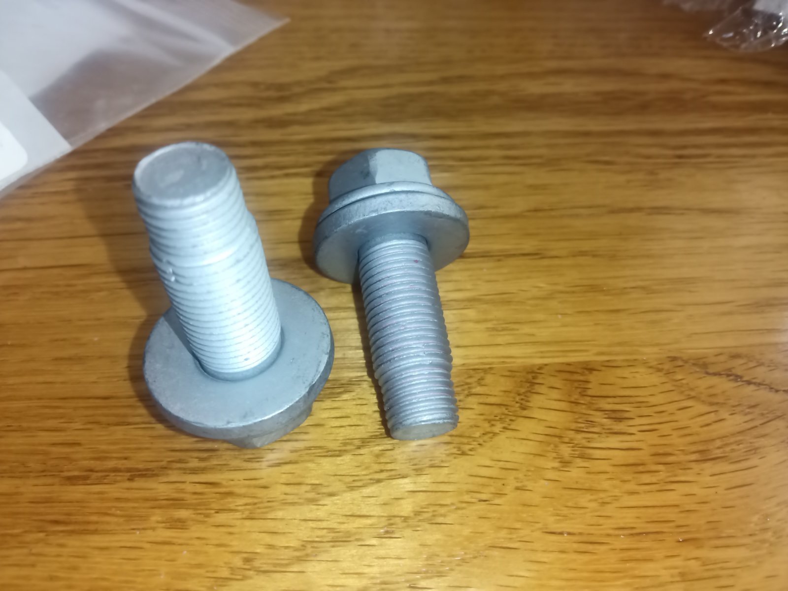

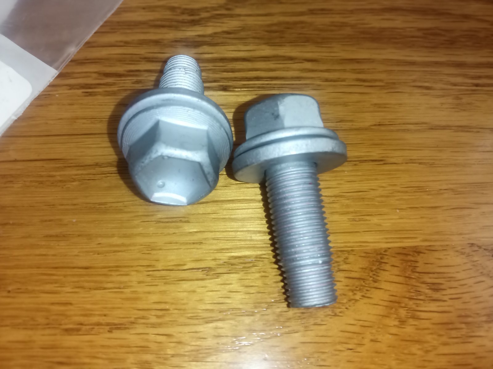

    The bolts...

    They are 17mm

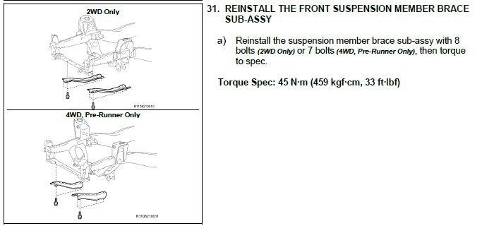

    At 45 Nm those should not be on too tight to break the old bolts free with a 1/2" breaker
    Will see how it all goes...

    no breaker bar was needed!
    just a 1/2 heavy-handle ratchet from tekTon + small extension with the 17mm
    successfully completed this fix in about 4 hours in the 90 degree heat on the driveway
    took my time did not force anything... bummed shoulder sucked that never wants to heal
    the 2 middle bolts (whose ends are exposed to the elements) gave the most struggle to remove as the whole thread lengths were crusted from the decade+ of winter salt exposure
    new bolts went in LIKE melted BUTTER
    coated them + the welded nuts on the new braces very well with the WoolWax HV sheepfat so no roadsalts will EVER touch them again and rott those nuts off or screw up the threads
    45 to 50 Nm is Fairly close to a German Torque Spec LMAO
