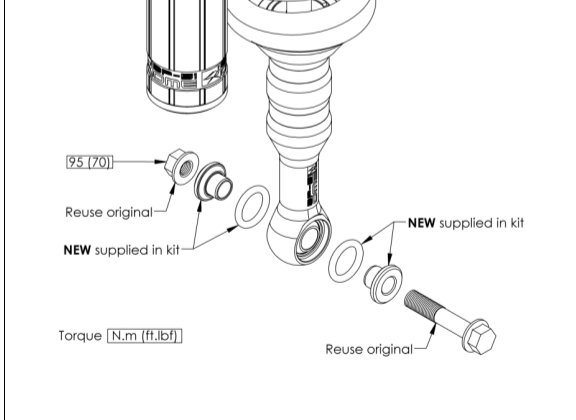

    Interesting, so no bushing=no need to reload the suspension? There are no bushings in the eye...just an o-ring and reducers.

    FWIW I torqued mine while resting on the weight of the truck, but it shouldn't matter since that rule mostly applies to parts with bushings as mentioned above. You can torque it from either the bolt or the nut as long as the other end is held in place (so you're not just spinning the bolt).
    If your new coilovers are like those in the diagram, are you sure you put the misalignment spacers in correctly? Most or at least some are directional (one spacer is bigger/longer than the other) so each has to be put in on the correct side. Hopefully that makes sense...

    Interesting...the instructions do not mention them to be directional but it's certainly worth investigation.

    I am not familiar with them personally, but on my Icons there were two different sized spacers for front and rear (same with my fox coilovers). They are solid bushings so no need to torque with weight on the vehicle. Did you loosen anything else like the sway bar links or LCA's that could be making the noise? I would assume that being new the bearings in the BP51's are still good and should make any noise.
