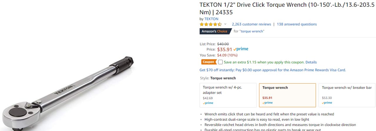

    I bought this one about 3 weeks ago but haven't used it yet. 18" long and seems to be a good range (10-150) for what I plan on doing. I'm sure eventually I'll need less than 10 and more than 150 but for right now this one will torque everything I need. Hope it works well and lasts. Surely 2200+ reviews can't be wrong can they?? Just noticed the price...it was 28.50 less than 3 weeks ago.

    Nice thanks! Same one that the original reply recommended, appreciate it.

    Sure enough... and I didn't even look. :)
