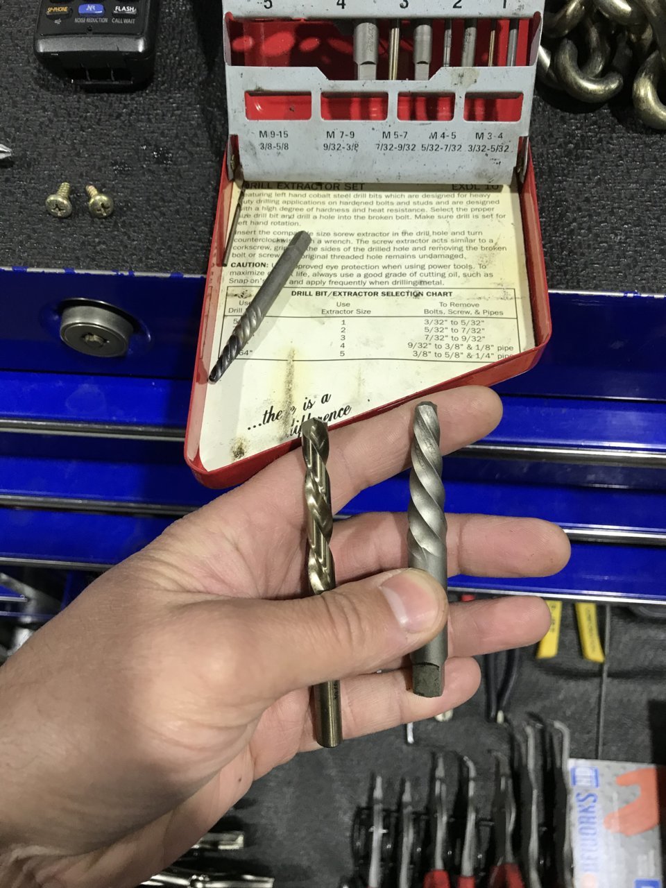

    Do that.
    After center punching a dot start by drilling a small hole and keep going bigger. Get an extractor set and use the fattest one possible. I can post a bunch of pictures when I get to work tomorrow. If I remember...
    Just what ever you do avoid breaking any drill bits or extractors in there, they’re hardened steel and good luck drilling or getting out a broken implement in there. Work slowly and be patient!

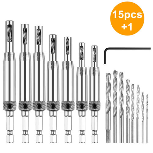

    Handy tool... Self centering !

    Those self centering bits are awesome!
    Any extractor bolt or opposite threaded drill bit tends to work only when centered in the hole, otherwise it's not trying to rotate the stuck bolt and usually chews it up or breaks. The above bits can work, but if the bolt is flush a drill guide and bushing can be used to get it as close to center as possible. Not sure the hole size but if it's 3/16 I'd try a 1/8, #30, or 5/32 extractor first. Other option is to just drill it up to next size and retap, but I'd try to pull it first. Also drill a pilot hole into the bolt before using the extractor, makes it much easier.
    Source--spent years doing aviation rework, I've drilled hundreds of these out. Gets real fun when you have to use a right angle reverse zephyr while jammed inside a confined space.
