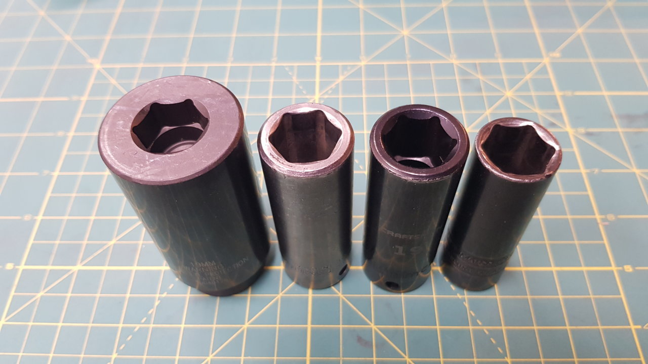

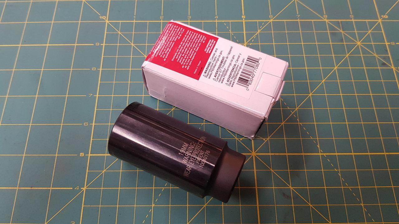

    BTW...Honda requires a high mass socket that helps taking it off.
    They're cheap at O'Reilly's
