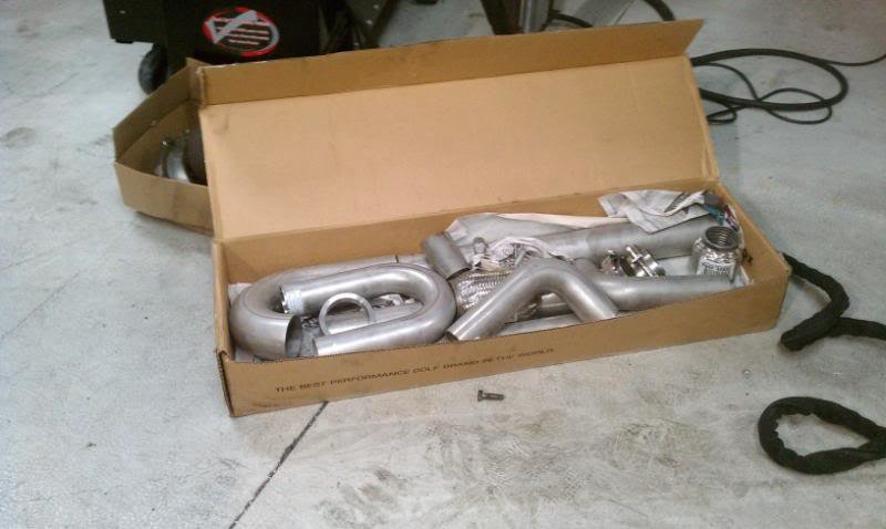

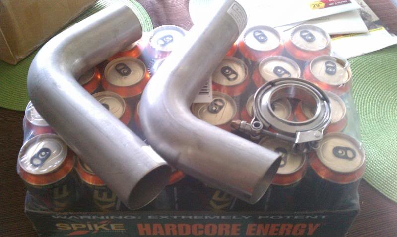

    Moving forward with the build, on the 23rd of April '11, I went back in to do some more fab time.
    I had to order a couple more tight radius 90 degree bends, in after the last bit of work we had done. In order to make a specific U-turn, the bend was too tight for what one could purchase. The mandrel bender couldn't make a bend on a 180 degree tube, with that tight of a center line radius. So, thus the reason that two 90 degree bends were necessary. The Centerline Radius which was necessary was 2.25". The 180 degree bends only came in a 2.5" centerline radius.
    ^^^ and by the way, one of my favorite energy drinks.
    So once those parts were in, and PowerFab's and my schedules worked out, it was time to get back to work.

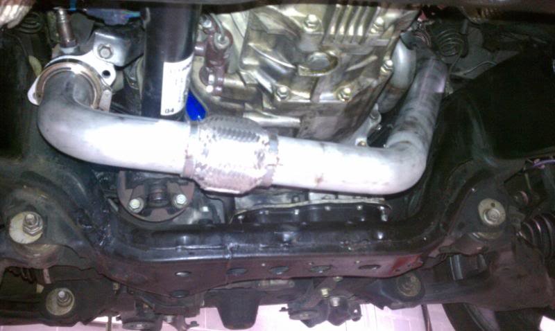

    The left side being portion of the cross-over.
    The cross-over all tacked up, and ready to be fully welded.

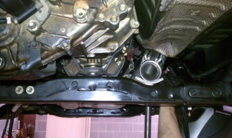

    In the pic below, if you look at the cross-member, you can just make out the welds where the piece was re-installed, after it had been cut out for the ProComp lift.
    Here is a really good pic to show how low the cross-over tubing sits. Even at this angle you can see that it is tucked up plenty high for clearance. Made sure to leave room beneath the drive shaft also. In preparation for the new AWD T56 in the future.

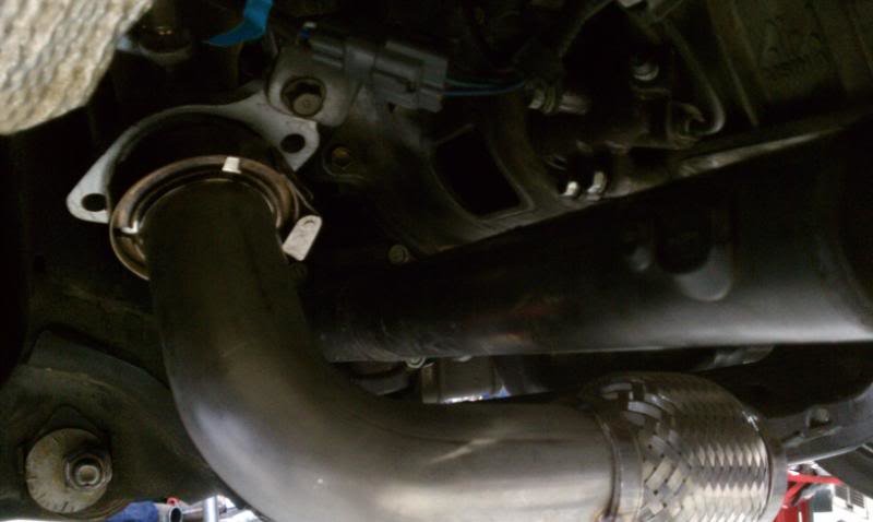

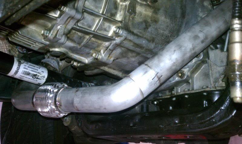

    Here are the the cross-over, and down pipe, all finished up.
    The flex coupling in the cross-over is a "turbo lined" stainless flex coupling. Meant to hold boost pressures. It wasn't really necessary, but it helps line things up during install.
    The one in the down pipe is extremely necessary. Helps let the exhaust flex when the engine torques. Keeps crack at bay. It is also a Vibrant Performance turbo lined coupling.

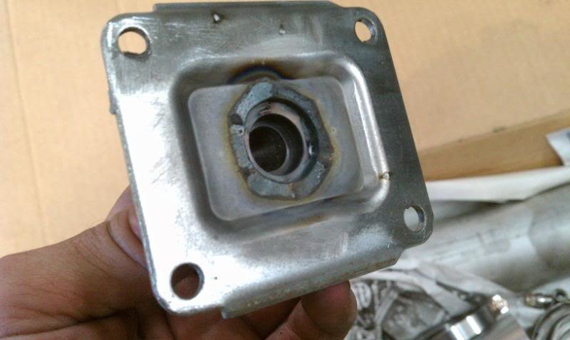

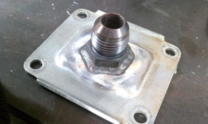

    This is the return port for the turbo drain. Nifty little idea from another member named Rexrunner.
    It is actually the timing chain tensioner inspection cover, on the passenger side of the timing cover. Best features of this, is that the piece can be removed to drill it. So no metal shavings in the oil pan. As well, it is very easy to install/remove.
