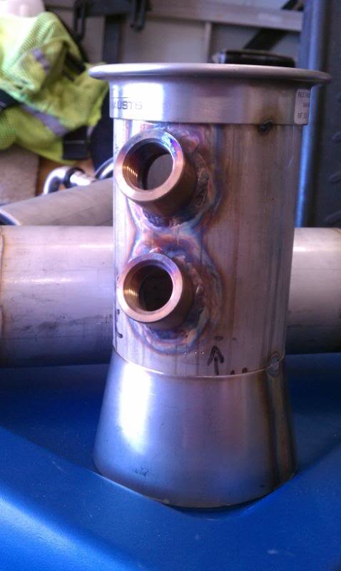

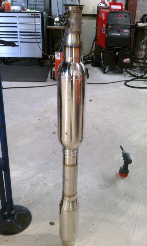

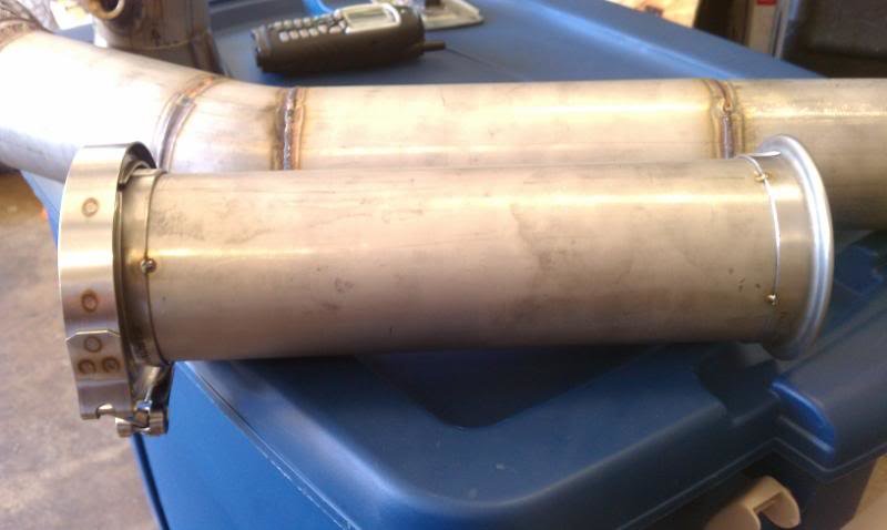

    The following week I had some more parts finished up. This piece was the "test pipe". So that I could swap out a catalytic converter for emissions time, and test pipe for all of the "off public road" times.
    Here is the tubing that goes directly after the test pipe. This will hold the two O2 sensors. Also at the bottom, you can see a reducer. It transitions from the 3" tubing that the down pipe is, to 3.5" tubing that are the sizes of the muffler and resonator.
    Had I had the chance to go back and do this piece again, I would have had a 12 degree reducer installed that goes from 3" to 3.5", instead of such a short reducer.

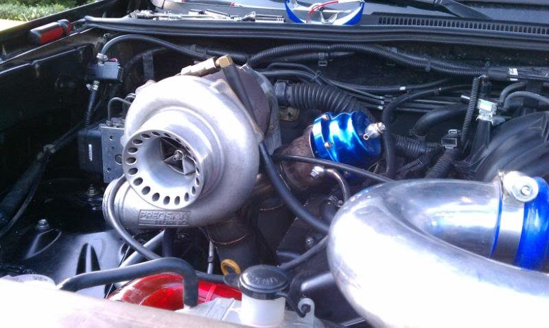

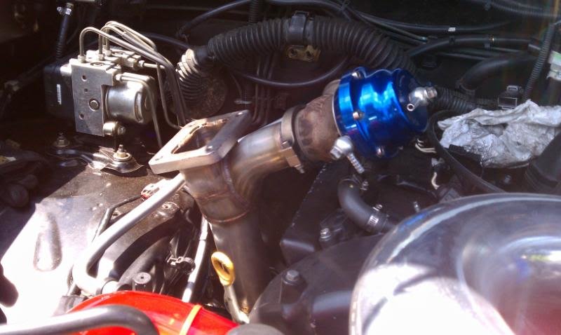

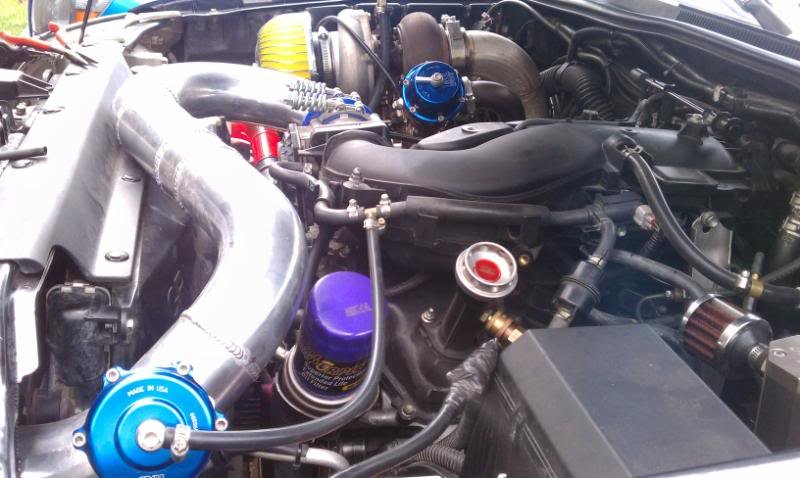

    At this point, I was back at the house, and got the itch to install everything, prior to having the full exhaust finished. Like a kid in a candy store, with no one there to say "don't do that".
    Also, I really wanted to test it out and see what other things I might need to get it finished up properly.
    In all honesty, I don't quite like the placement of the wastegate. I think in the future, I will have the tubing it is on shortened up a tad, to bring it in closer to the turbo.
    Here was a video that we took, just to hear was it sounded like. Purely in the name of science. ;)
    http://www.youtube.com/watch?v=-McD3T3_97E
    Then the turbo installed.
    Here is what the turbo is again, incase anyone is curious.
    Precision Turbo Billet Journal 6265. Ported shroud with 4" inlet and 2.5" outlet. On the turbine side, T4 inlet with a .68 A/R and 3" V-band outlet. Rated for 700 hp.
    Here is the link of where I purchased it. http://www.extremepsi.com/

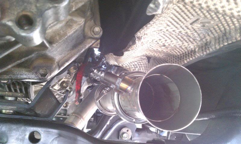

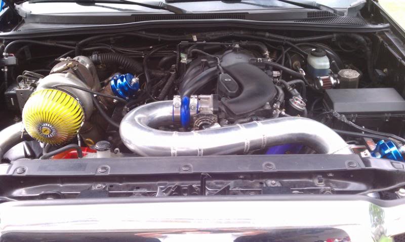

    This made me happy. Didn't have to buy a wire extension for the driver side O2 sensor. Woot.
    This is also a better look with it together.
    Was able to just swing it over the transmission and it fit perfectly.
    And two pics of the very early unrefined turbo kit all together.

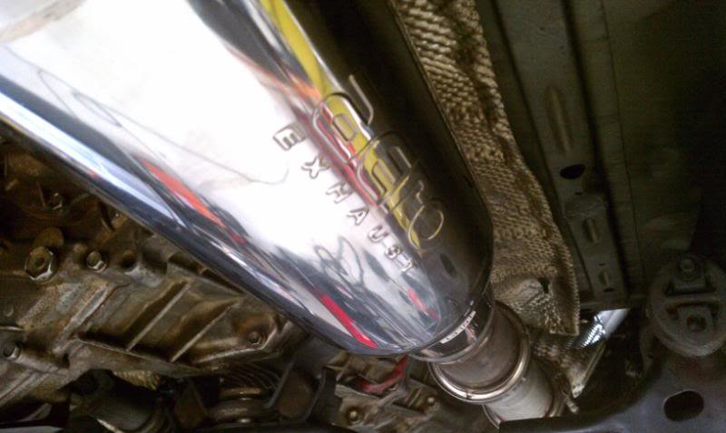

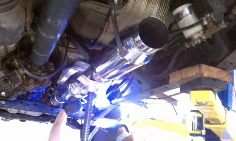

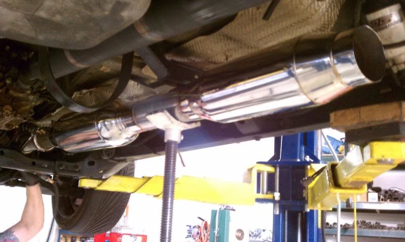

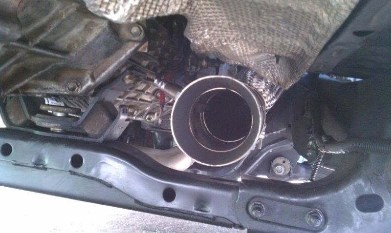

    The following week of 5-10-11, I had the exhaust 90% completed.
    Aero Turbine 3535XL (resonated), followed by a 3.5" Vibrant Performance resonator.
    Sounded beautiful, even in its unfinished form.
    Here are some new pics of the exhaust. You just have to get the right combo of resonator and muffler. This combo to me sounds similar to a 350 Z with an aftermarket exhaust. Very nice.
