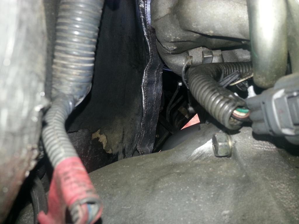

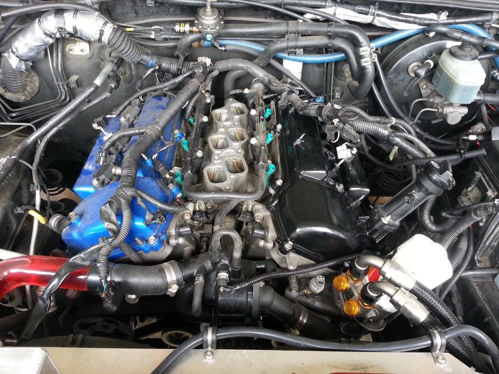

    Been sick pretty bad the last two days. So I've been taking my time with everything. Getting all sorts of nitpick stuff completed, whivh will help with the engine install and improve things from their current status. Any way, basically, I have the radiator removed and block drained. Whereas before, I could do the swap without removing the radiator. This sucker is just massive and too close to the engine.

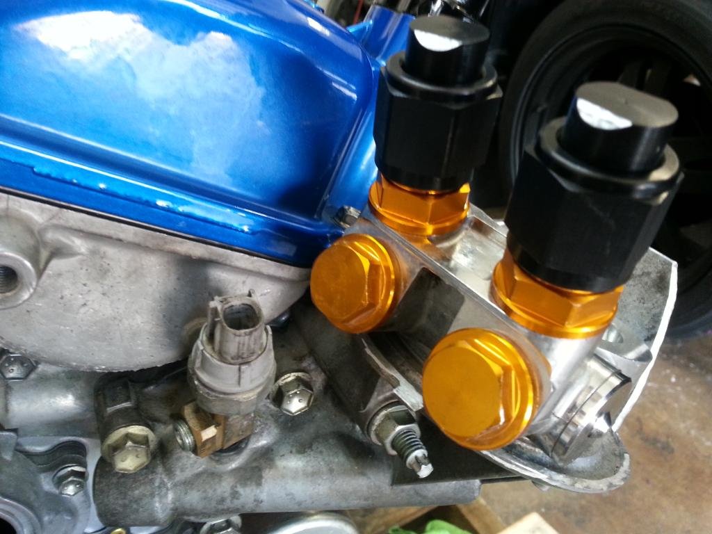

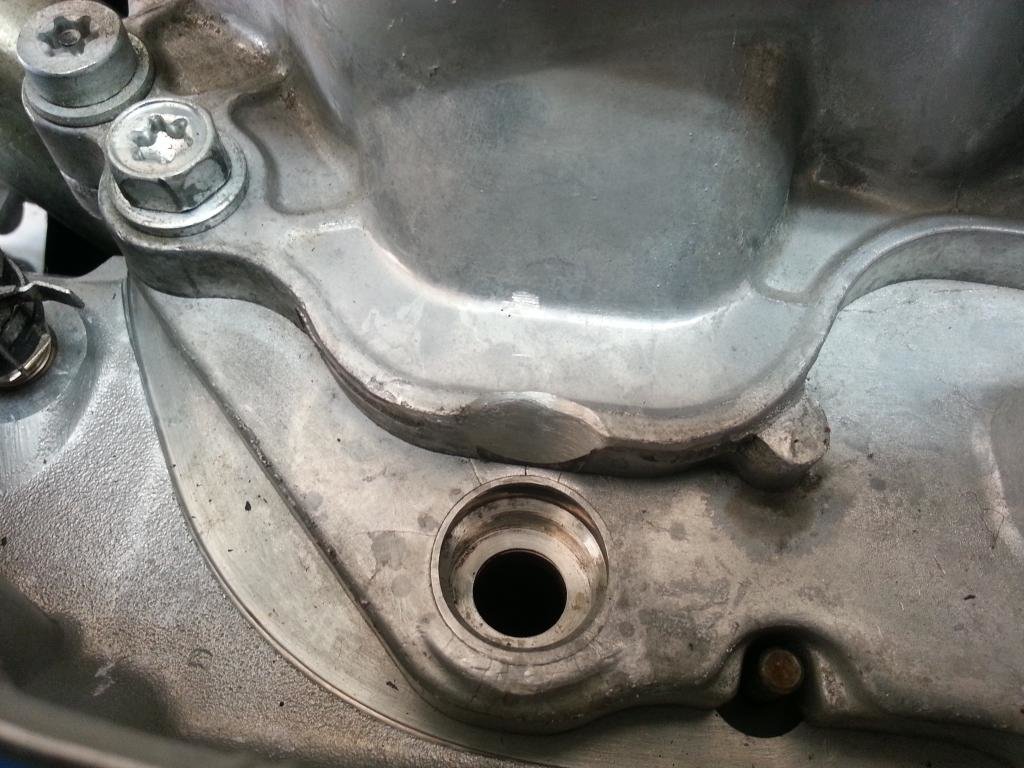

    Forgot about this mod. When I was running the RC Engineering injectors, their fat asses wouldn't fit properly, and I had to remove that material for them to fit. This is on the built engine.

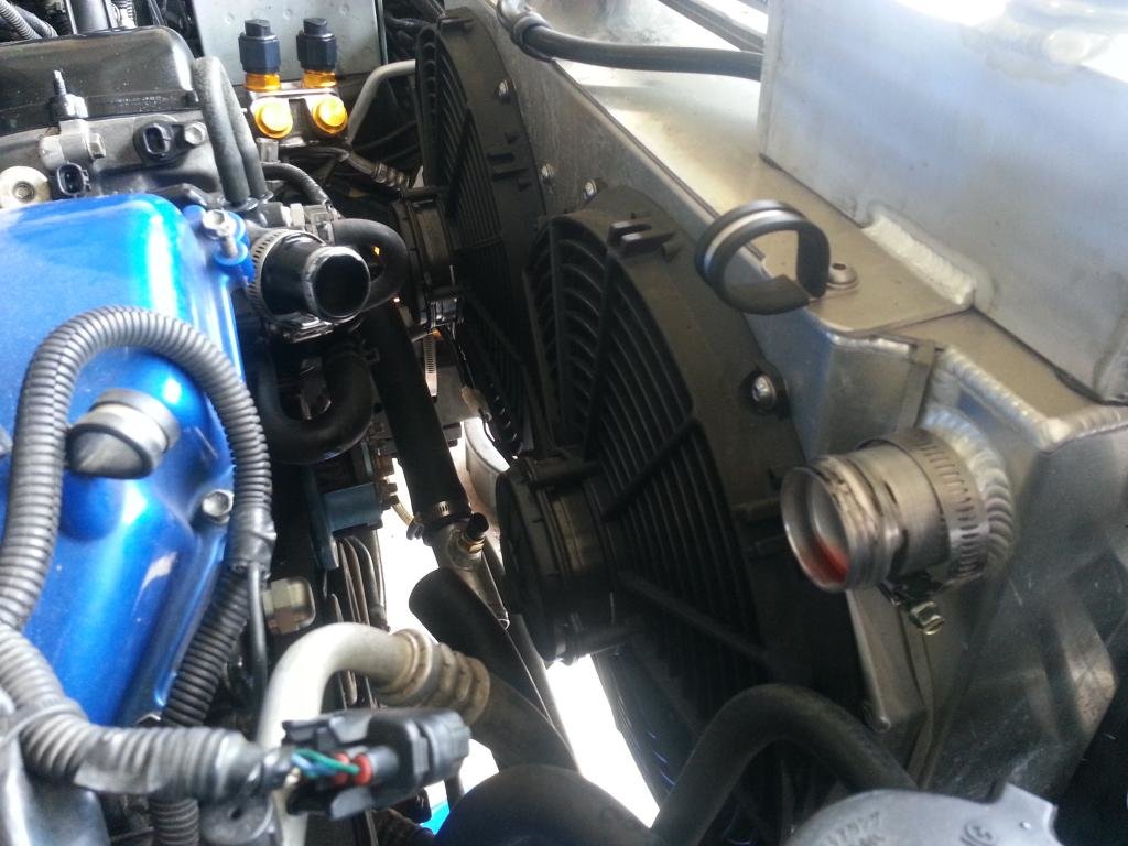

    Radiator mostly drained. If look just above the two gold plugs, in the back of the picture, you'll notice two black caps directly above them. Those are there to cap off the lines going to the oil cooler. As I don't want to break in the engine with it attached. Ruling out the possibility of particals getting in there.
    And then, the radiator removed.
    A lot of other things not shown, but basically now I just need to pull the exhaust and transmission.

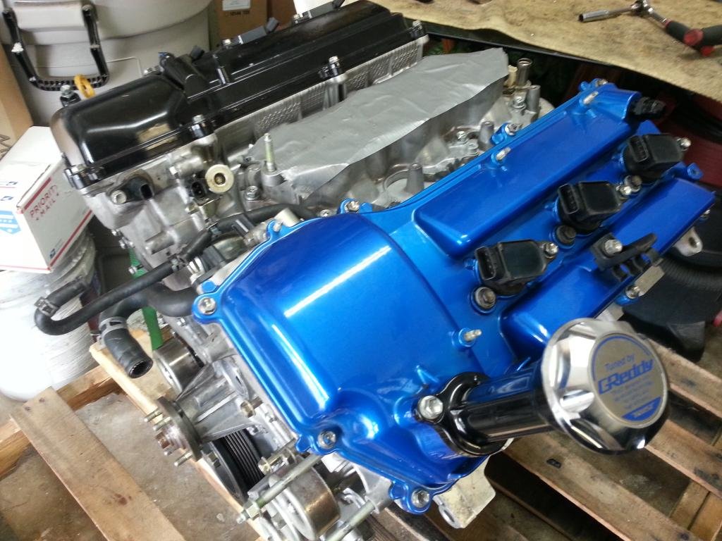

    Oh yeah. Also saw this at Coffee and Cars on Saturday.

    green tea mf'er........
  11. Jul 6, 2014 at 9:27 PM
    #2231
    AR15xAR10
    Apr 13, 2013
    #102024
    56,956
    2013 TRD Sport 4x4 V6 ACLBFTMFW
    Good God. :drool: its so ridiculous!! I love it. :D
    Love the Greddy oil cap too lol
    The fact that you and i both run K&N oil filters has now instantly made me feel as if my truck has more power already. LOL

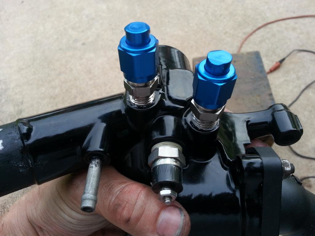

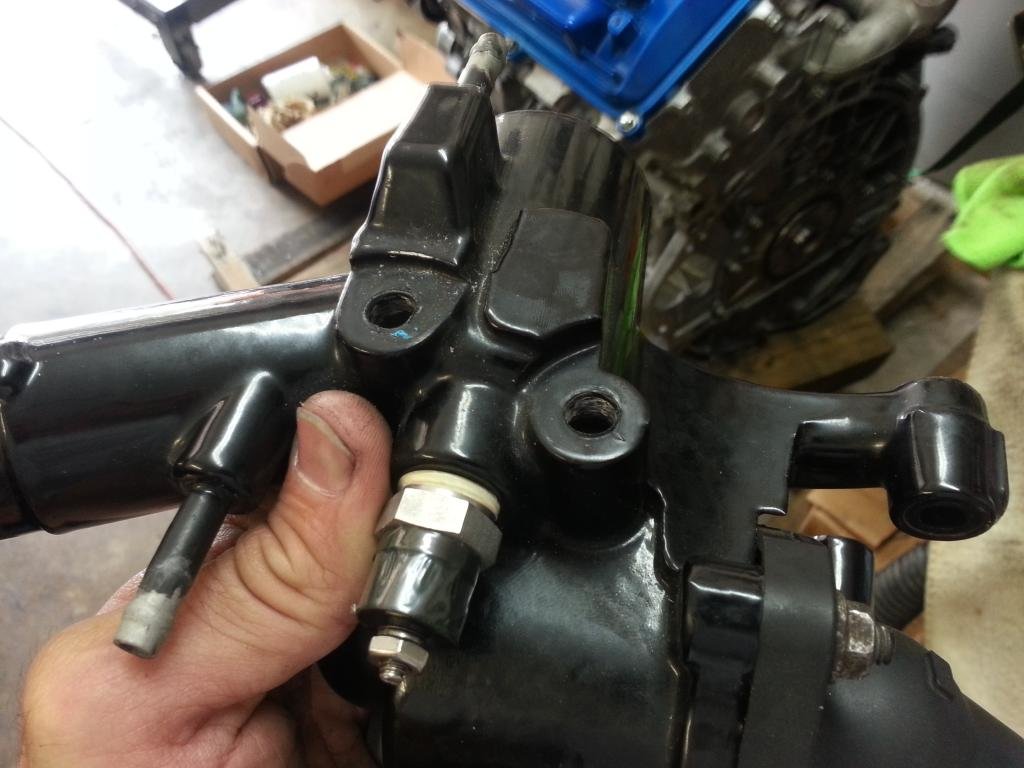

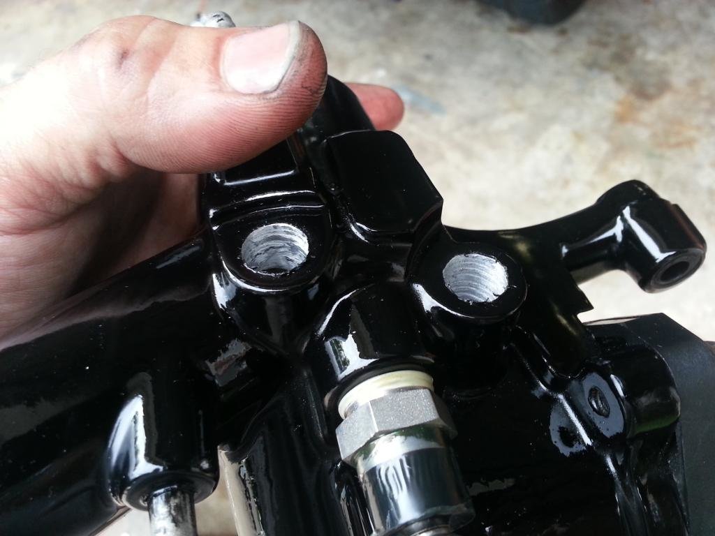

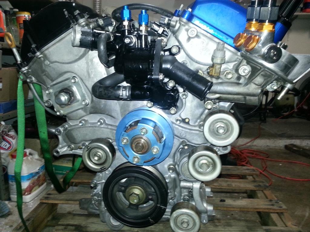

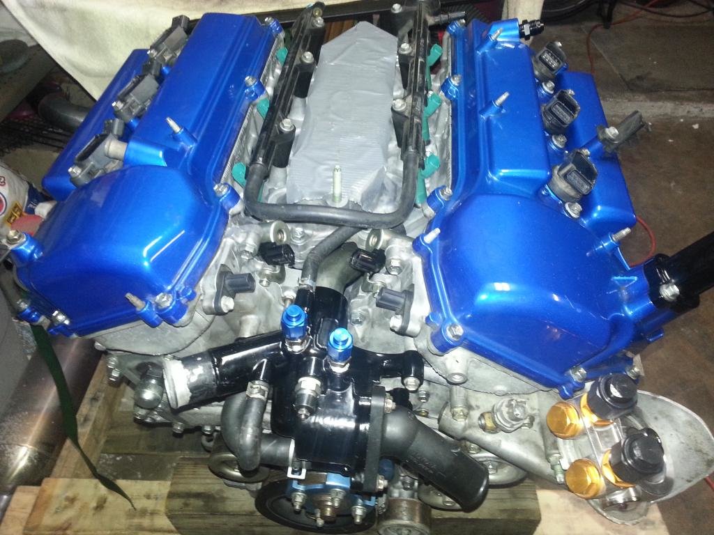

    This little project took some time yesterday. These two ports, which normally feed coolant to the throttle body, are what I use for coolant to my turbo.
    Well the OEM ports were just too narrow for the -6 AN push lock hose. The plan, was to pull them out and replace them with 1/4" NPT - 6AN fittings. Here you can see where they are pulled out.
    Drilled them out with the next size up from a 7/16" bit. Then tapped them with the 1/4" NPT bit.
    The finished piece.
    What took so long, was trying to remove the powder coated over spray. Which I had never done earlier.

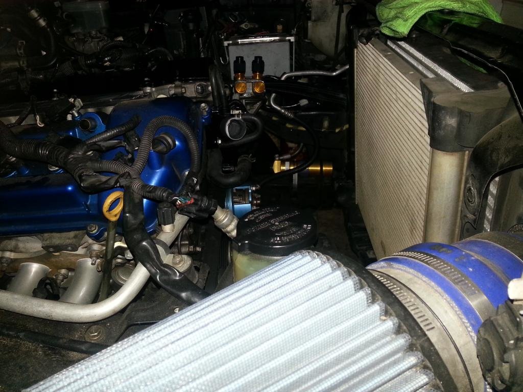

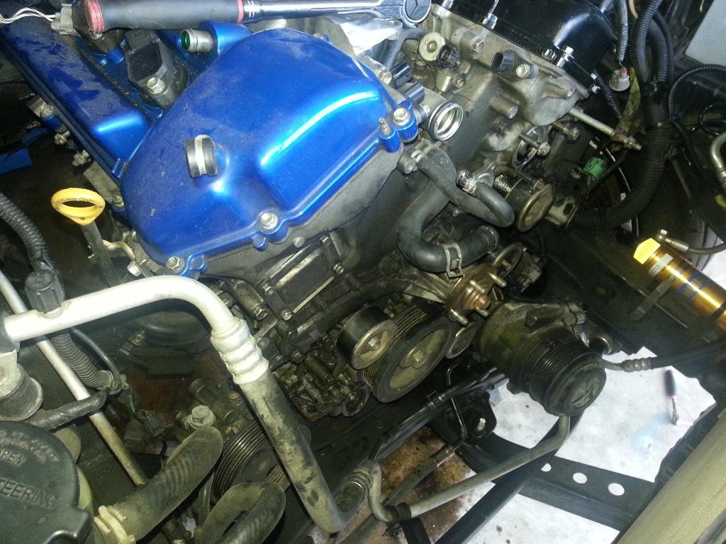

    More updates. Dropped off the second wheel to S.A.B.S to have the tiny ding repaired. The truck is ready to drop the transmission, and pull the engine tonight. :woot:
    I also took this coolant passage to Kozmic Motorsports, to have them weld in a bung, so that I can have the ProEFI's coolant sensor, in nearly the same exact spot as the OEM sensor.
    Originally when it was tuned, the ProEFI used the OEM sensor for it's coolant readings. Well when I more recently had the throttle body mapped out, by D3, so that the ProEFI could control the TB, the wires which were used for the OEM sensor, where needed for the TB and the gas pedal. Sooo, with that development a new sensor was needed, but I never settled on where to put it until yesterday afternoon. Here is where it is going.
    It will be in the bottom center of that coolant passage.

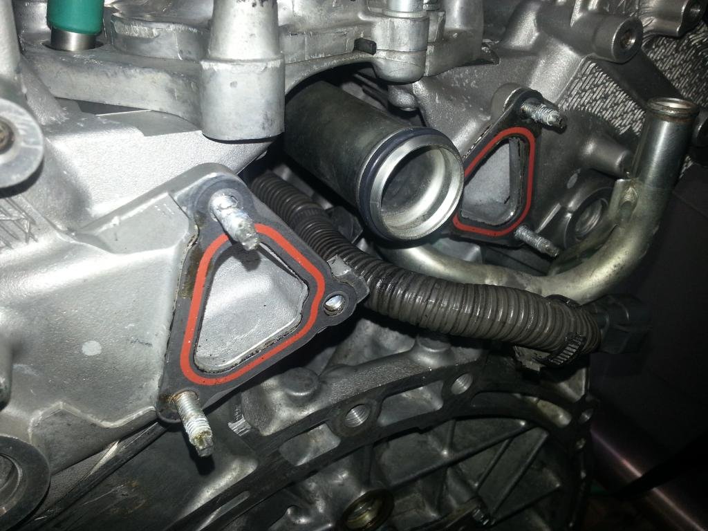

    Here it is over the bell housing.
    Accessories and exhaust all removed.
    Engine almost ready to go.
