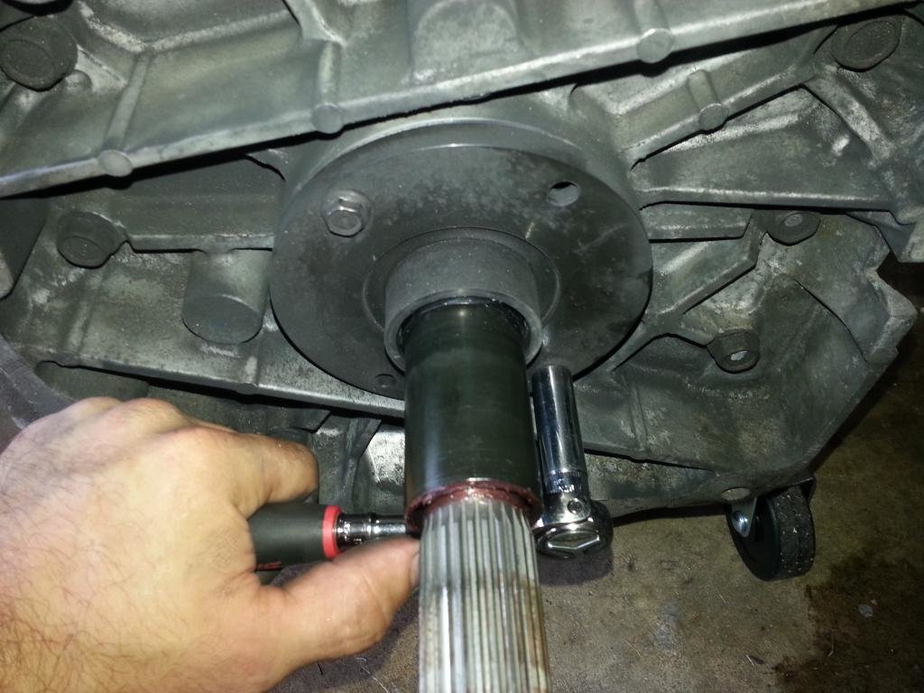

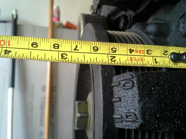

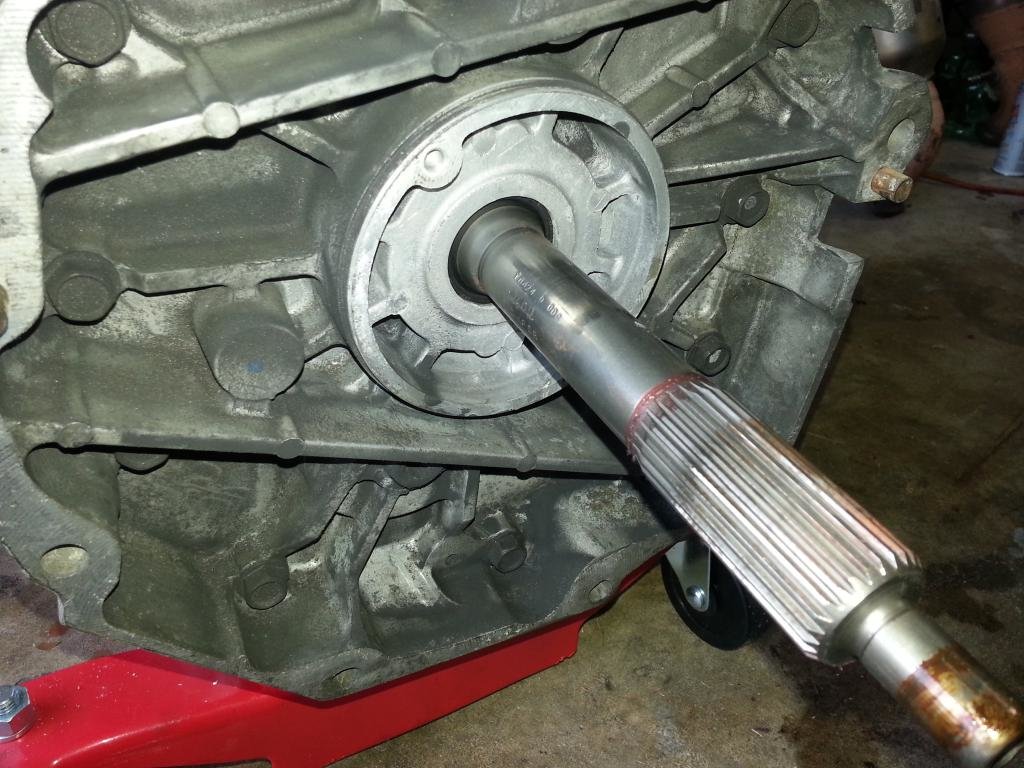

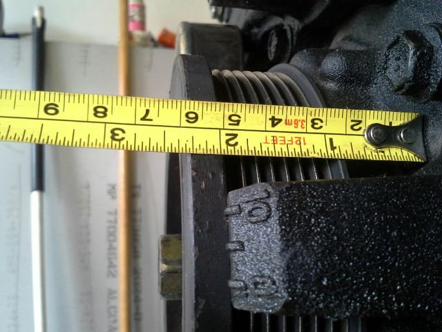

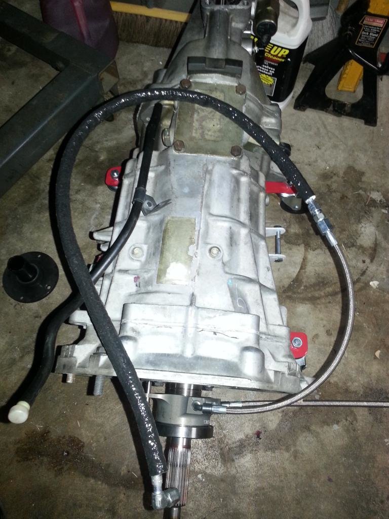

    So yesterday, before we hung things up for some brewskis, we also re-measured the engine to clutch and transmission to clutch, so that we could properly gap the new Tilton TOB.
    One interesting issue we came across some time ago, was that the crank shaft had A LOT of front to rear travel. A LOT. Which basically means that the thrust washers are extremely worn down.So much so, that the flywheel was actually eating away at the back of the engine. If you look closely underneath the rear main seal, a shiny smile is visible. :)
    The only thing that I can think of which caused that, is when I was racing, before I found out that my fuel pressure was too rich. It was so rich in fact, that the oil no longer felt like oil. Rather a gasoline mixture without any oil film lubricity. I even had an loss of power that day. A massive loss of power, likely caused by a loss of compression. I would say, that there is about a little more than an 1/8" of front to rear travel. Surprising that the engine still ran so well, and had two other races under its belt, as well as countless miles of city driving in between. After the fuel pressure was corrected of course.
    Quality 10w-40 Redline Oil and their Engine Break-in oil ZDDP additive is what prevented catastrophic failure.
    (I'll get some closer pictures. )

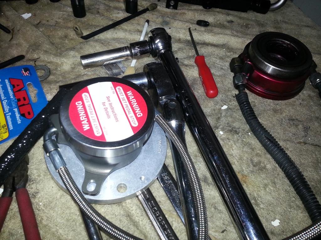

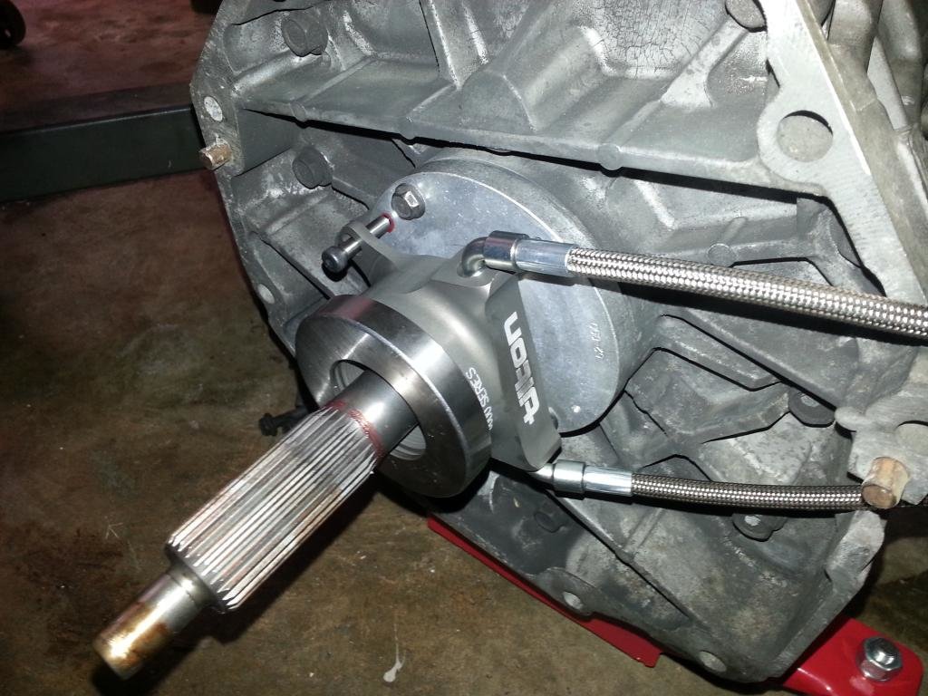

    Removing the McLeod adapter and "custom" spacer.

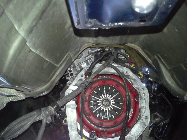

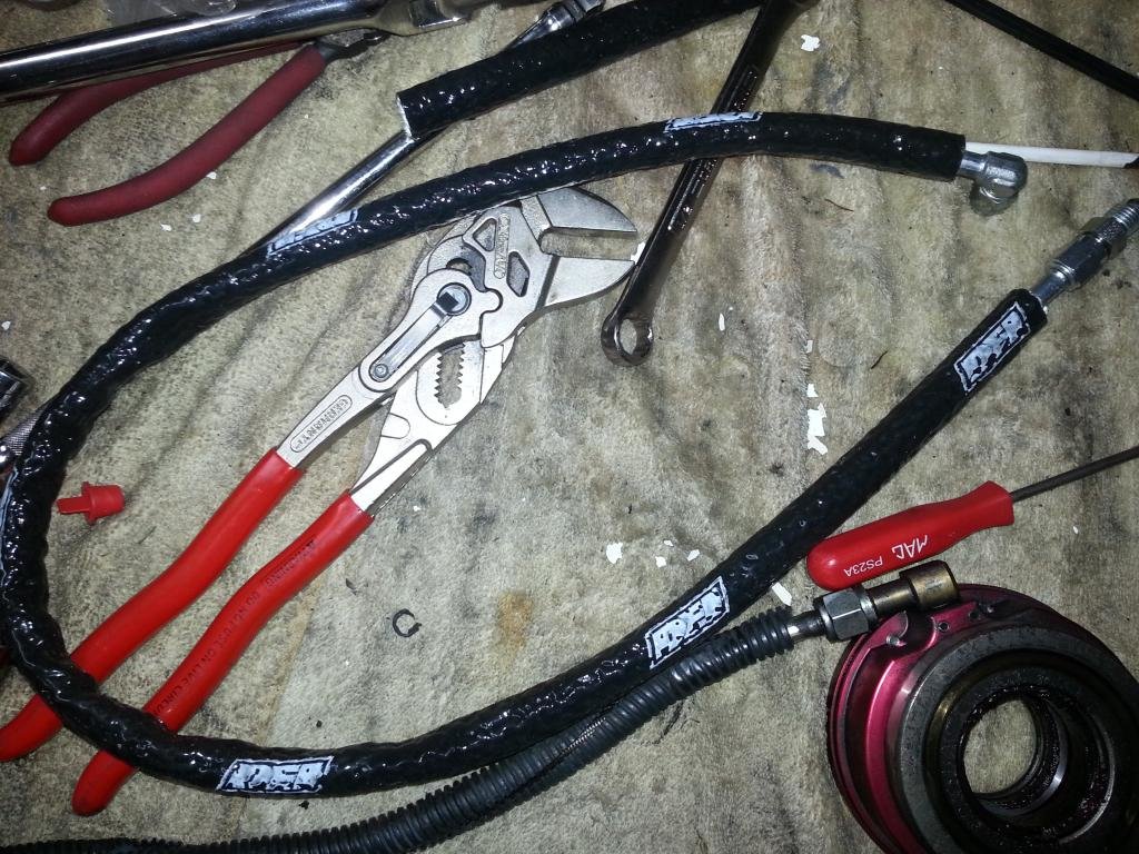

    DEI fire sleeve added to protect the clutch line from exhaust heat.
    And installed and gapped between the minimum and maximum clearances.

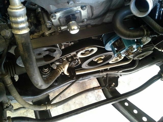

    Speak in of Redline, here is a good perspective of the in&out travel.
    Top quality lubricants are what kept that engine from catastrophic demise.

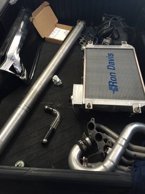

    I had to take this picture on saturday, to show that at any given time, there is more high end aluminum sitting in your bed, than most of us ever have on our entire truck.

    Ha. Never even thought about that Colin. What can I say...I am a quality materials whore. Lol.

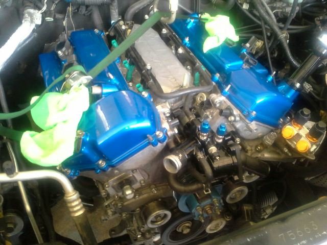

    Here are some other pictures which I had to transfer.
    Prior to start-up.

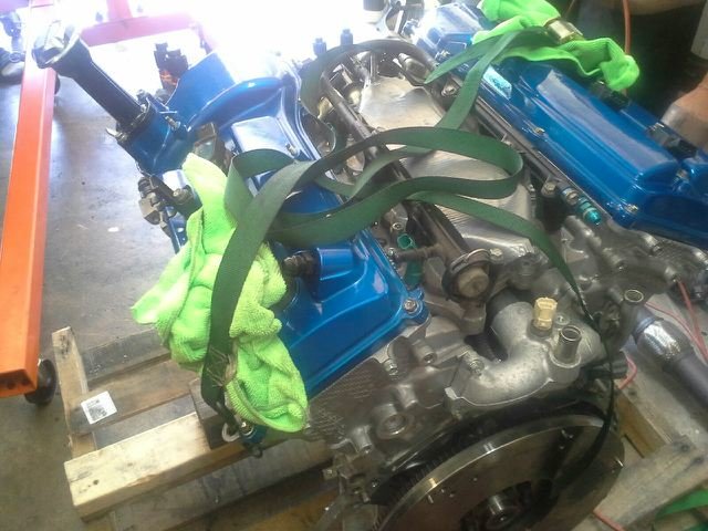

    It was a bit of some work to position that engine on the pallet, to be able to be properly hoisted.
    From that point, the following steps flowed fluidly.

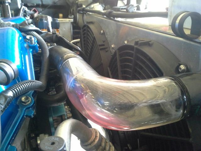

    The greatest feature of this Killer Glass tube. You can simply visualize how full your coolant system is.
    Robert installing the clutch.
