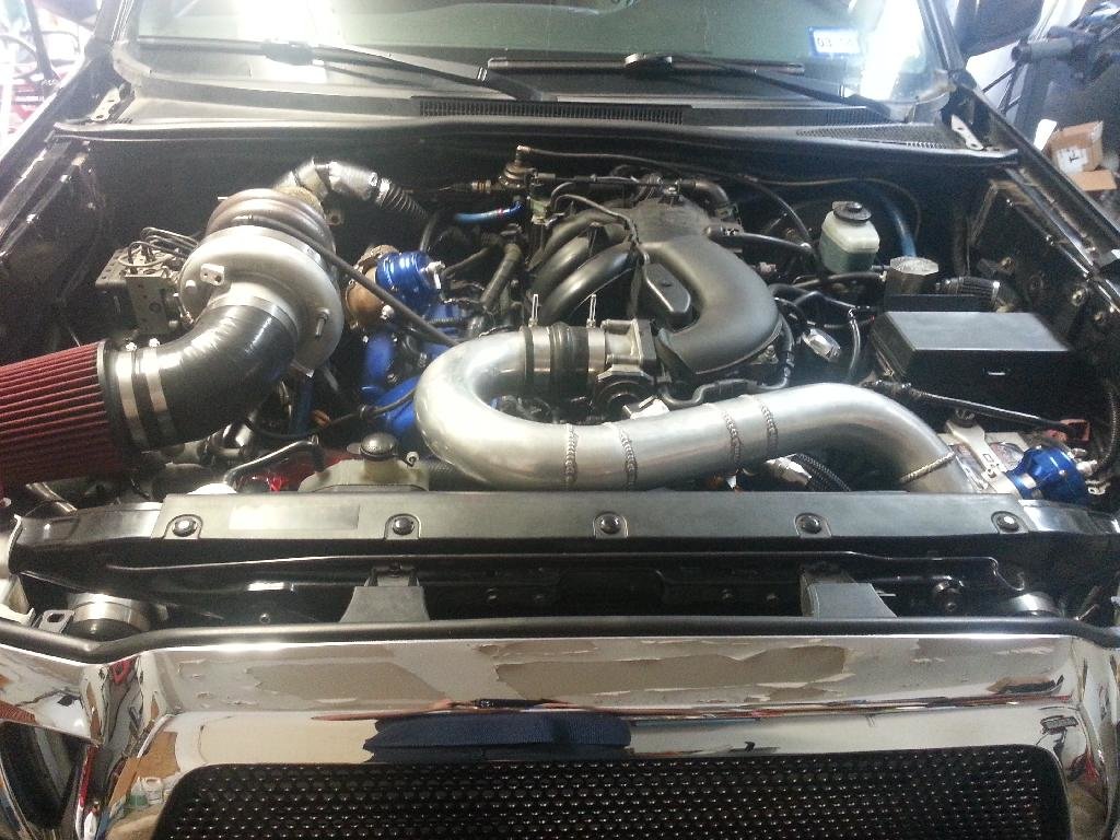

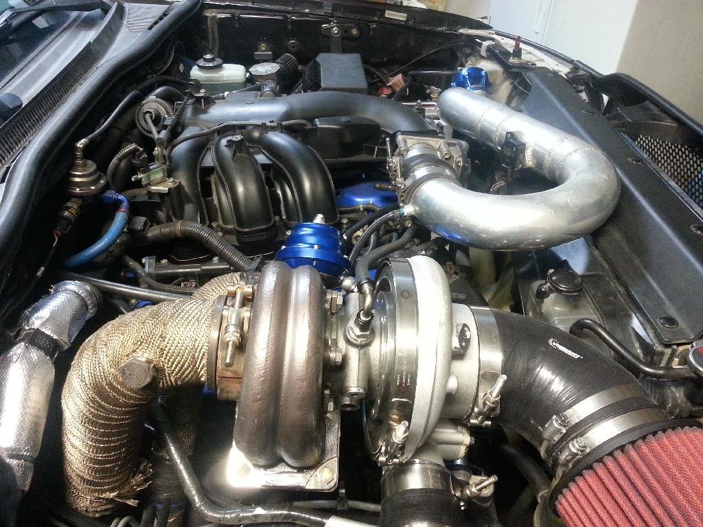

    You've got the vibrant tube from the turbo going where? To some aluminum pipe then into the intercooler intake? Or straight to the intercooler with the vibrant?
    Plan on keeping it that way, or go with something smoother like a solid aluminum pipe?
    On second look, I think I can see aluminum into a vibrant connector then into the intercooler.

    Filter - Vibrant silicone coupling - turbo inlet - Vibrant 2.5" to 3" silicone reducer - 3" aluminum tubing - Extreme PSI 90* 3" silicone coupling - intercooler - Extreme PSI 3" 90* silicone coupling - 3" aluminum tubing - throttle body.

    It will be better soon enough. I have some tubing which needs to be re-worked. It will look better, but more importantly, perform better.
    Not yet. That won't be until later. After tuning, and possible race. Not yet sure if all is well with the engine. Need to test drive it today.

    Bw s256 turbo with 3 in glass pack dumped pre axle raptor liner bed and top rails and fenderflares and rocker panels. Hunter side steps. Plasti-dipped upper fenders and emblems. satin black spray paint here and there inside and out. 5100's set to 1.75" up front . C channel front bumper. Maxxis bighorn 255/85/16
    Would a same side intercooler not eliminate that? I was also curious
