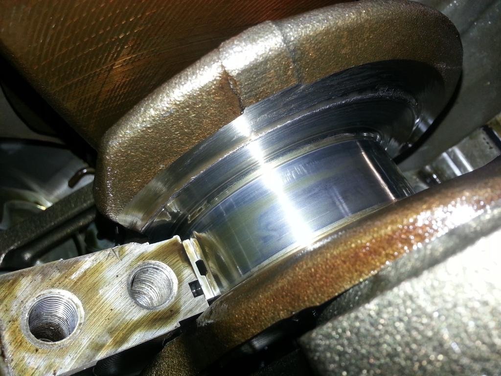

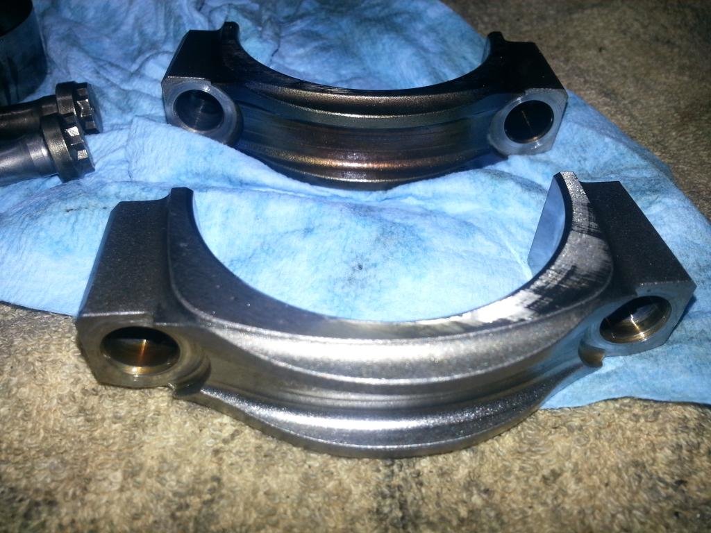

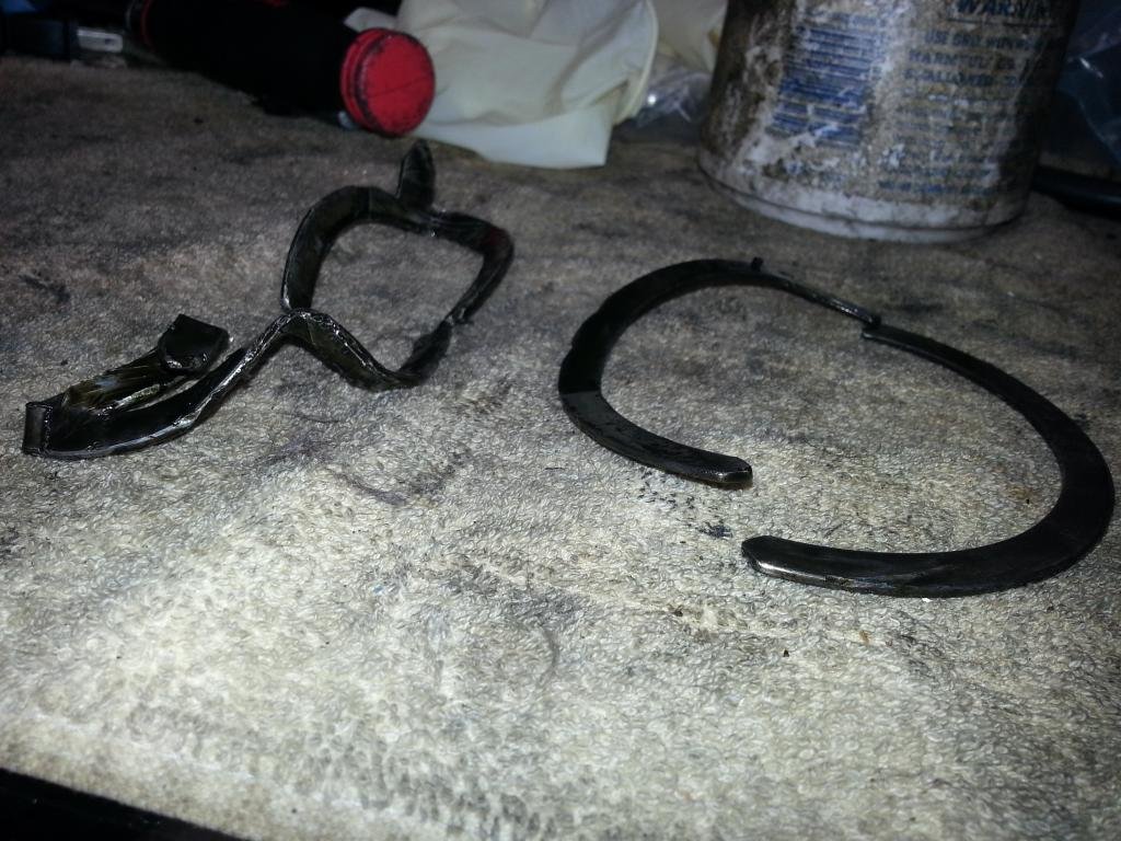

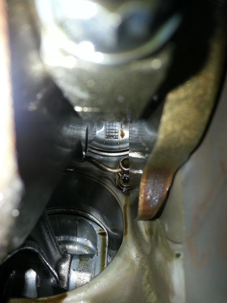

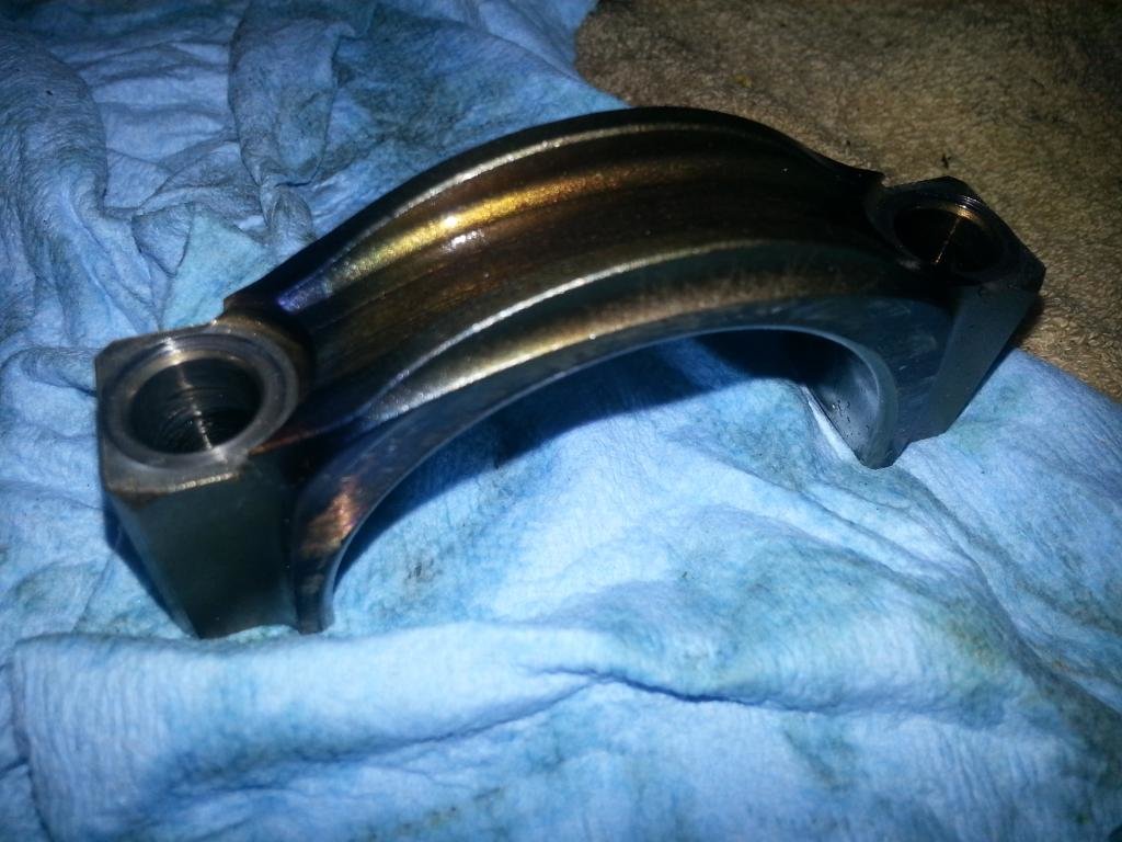

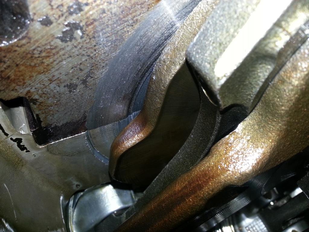

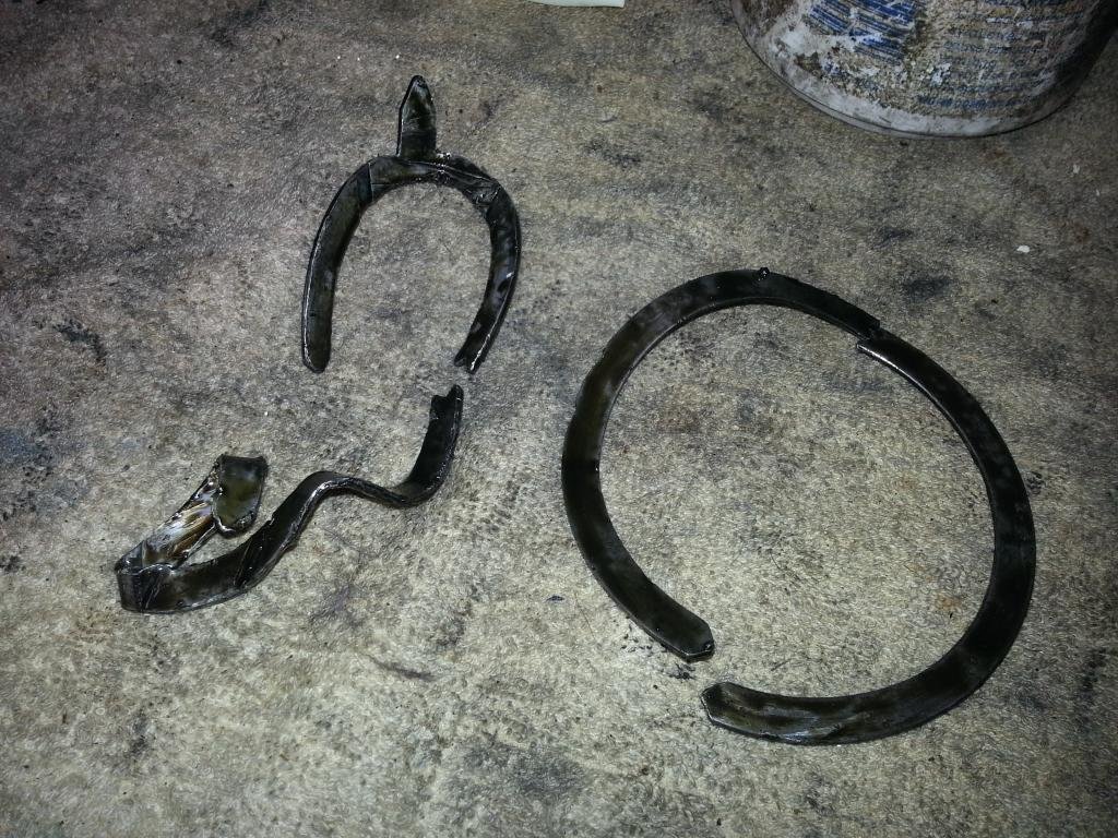

    With my spare engine on the engine stand, we were curious to see what exactly was allowing the crank to walk an unbelievable 1/8". Well when I turned the engine over, to evacuate the remaining coolant in the passage between the heads, there was a metal clinking sound. Turned the engine back over, to make sure what ever was in there, would be in the lower pan. Told Robert that I bet it was something with the thrust washer. Here is what we found.
    Damn thing puked itself out, to our amazement. First time I noticed it, was when I installed the sprung hub twin disk, after having it swapped from the solid hub. We were taking measurements for the clutch, to adjust the throw out bearing. Probably should ha e taken it apart then, but it was working fine. Lol.
    So drove a countless amount of miles on it as well as raced on it without any catastrophic damage. It should have ripped itself apart, in all actuality. Simply amazing! All of the cylinders were fine, but you could see where the bottom of a few pistons had dings.
    Bent oil squirter. ^^^
    Main cap which was used as thrust bearings.
    Even pulled the #2 main cap to inspect the bearing for abnormal wear. The only abnormality on the bearing, is my finger print.
    The crank has clearly visible wear though.
    Two things to take note of hear. Quality thick oil. Redline 40 weight with their Engine Break-in oil, and a magnetic drain plug. Those are what kept that engine going when it should have destroyed itself. Also also due to the amount of allowable travel between the rod end and piston. Which unfortunately isn't shown in the pictures.

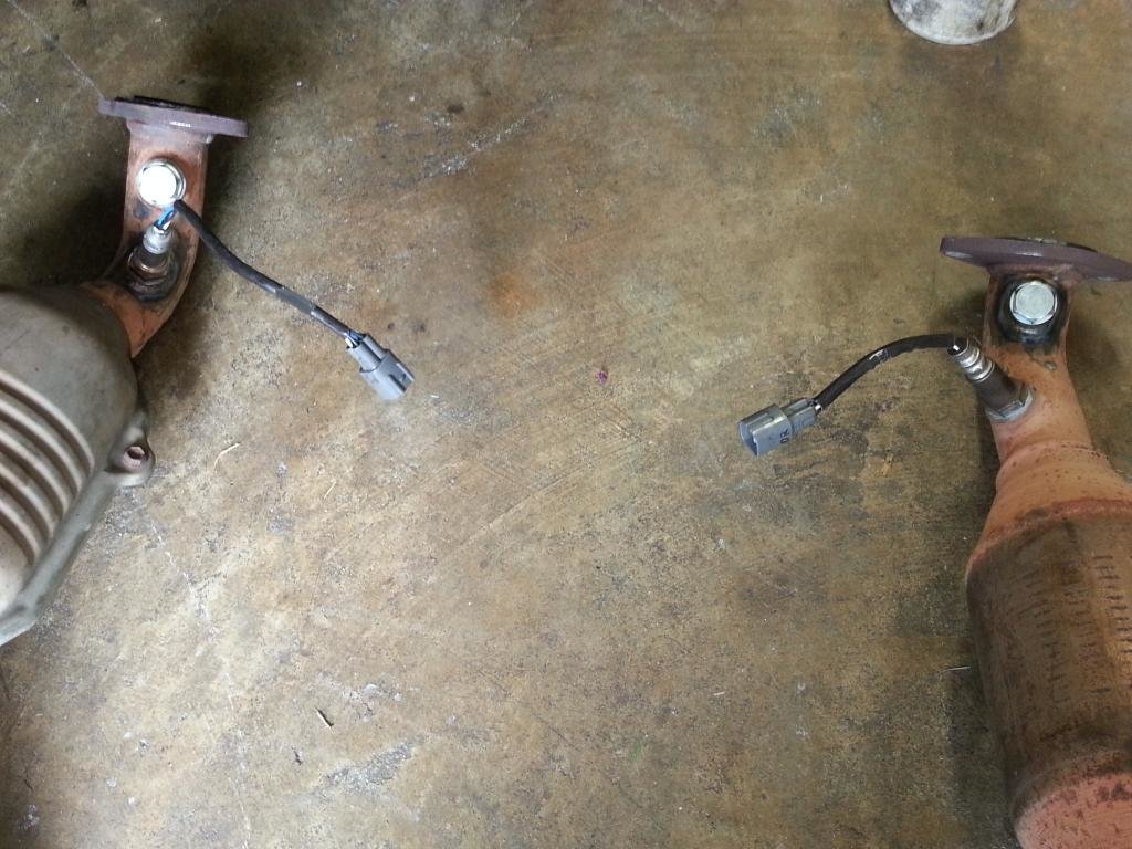

    I'll show you some heat........
    Definitely no quiter.

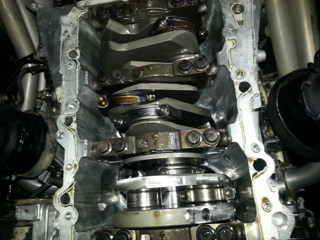

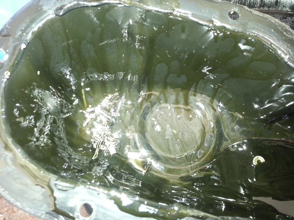

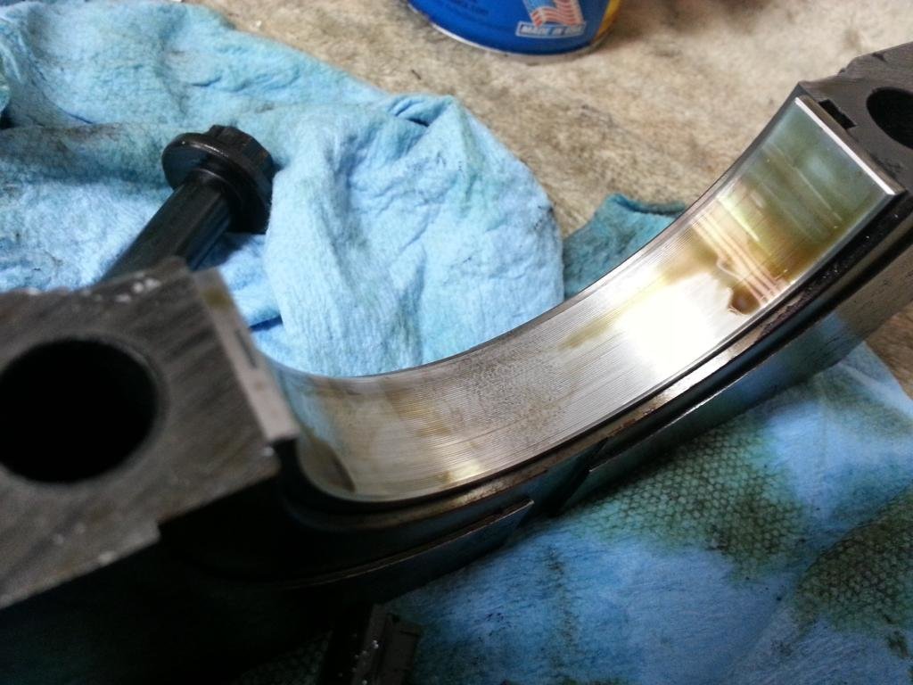

    Those rod ends, are both from the built engine. Rod #'s 1 & 2. # 1 is the discolored one. Three rods have discoloration, which also means bad bearings.
    New rods and bearings have already been ordered. Here is the engine still in the bay, oil pan removed.
