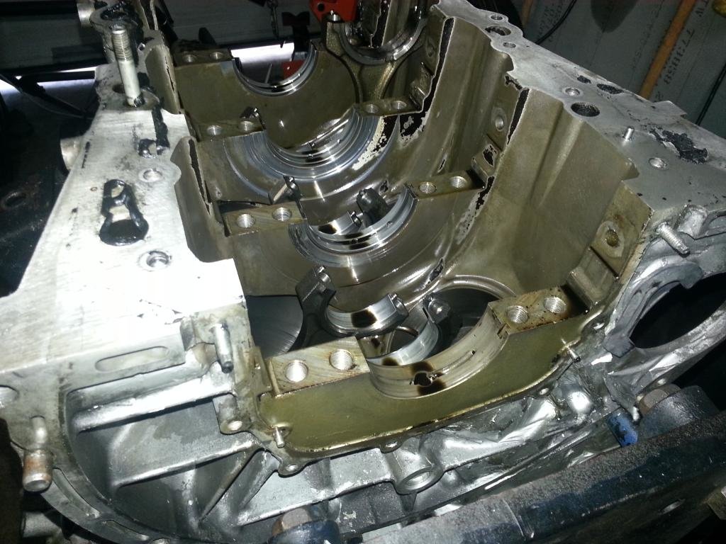

    Also was referred a machine shop which can repair the crank, by a veteran gear head. Ends up that the shop is just a few miles from my house. :woot:

    After three weeks of straight wrenching, I am taking a little rest. Then I'll pull the engine again, and get it all fixed back up. Hopefully it won't take more than a month to get it all back together.

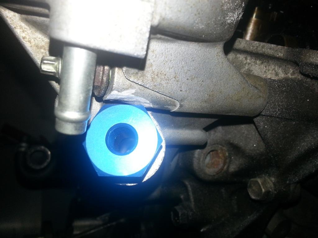

    Figured out a way to get the spare engine back up and running. Reconstruction of that one is under way as we speak. Pulled the crank last night, ordered a new bearings for #2 rod, which coincidentally is a #2 rod as well. Lol. Ordered a replacement oil squirter for the damaged one, and all new rod bolts. As they are torque to yield throwaways. Those parts will be here today, as well as the 2JZ-GTE head studs.
    The 2JZ-GTE head studs are nearly a perfect match for the 2005+ 1GR main studs. They are just ~.4" longer. The only issue with those, is that there are 14 in a kit, whereas there are 16 main studs needed.
    This was also done, so that I can have an oil pressure sensor, regardless of the ProEFI being used.
    There is a plug underneath the oil filter. A perfect place for a sensor. Remove the plug and install an adapter. 1/2"NPT to 1/8"NPT.
    There is also another plug lower and on the timing cover itself. A little harder to see, but it has some rust on it. It could possibly be used as well. That plug is post filter, so if something is going on at the filter, it would be realized on the gauge

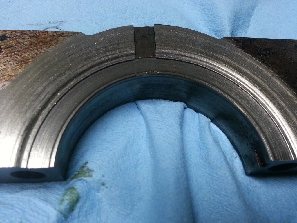

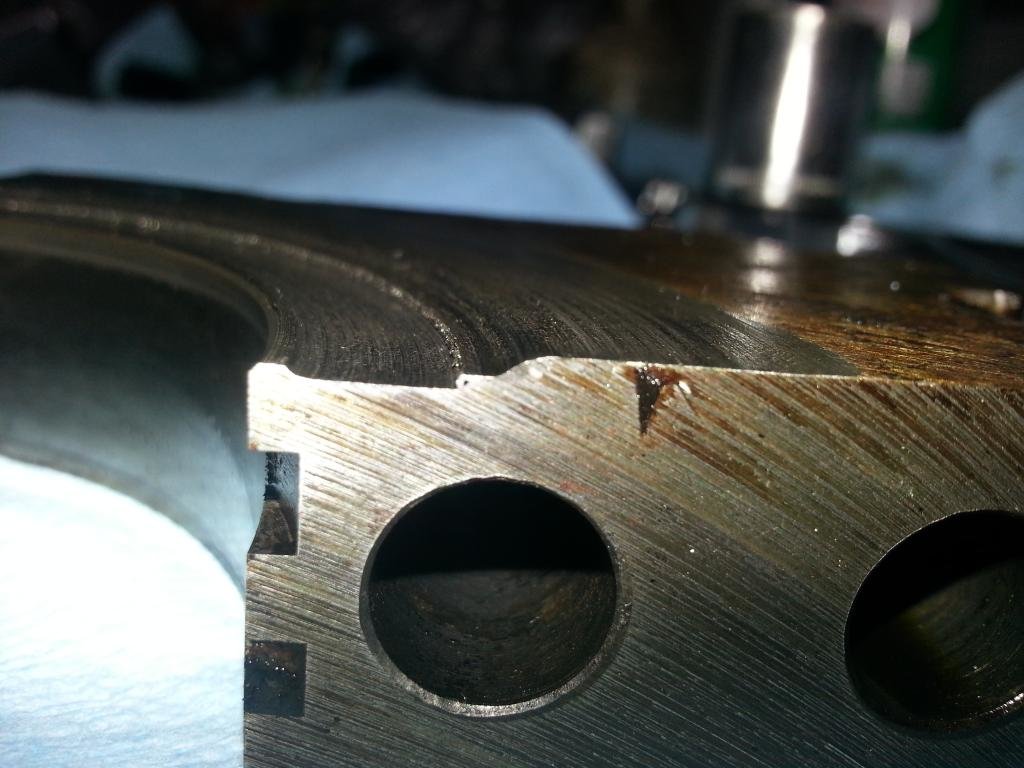

    Here is the latest from yesterday. Prepping for some more unorthodox repairs. :devil:
    Take a keen look and you'll see a rolled lip, compliments of the crank using that main cap as a thrust bearing. Got that all removed so the block's portion is left.
    Should be close to finished by this week's end. Then I can swap it back in and at least be able to drive andenjoy my new TOB. Sigh. It felt so good for that short while. Smooth like it hhasn't been since the twin disk upgrade.
