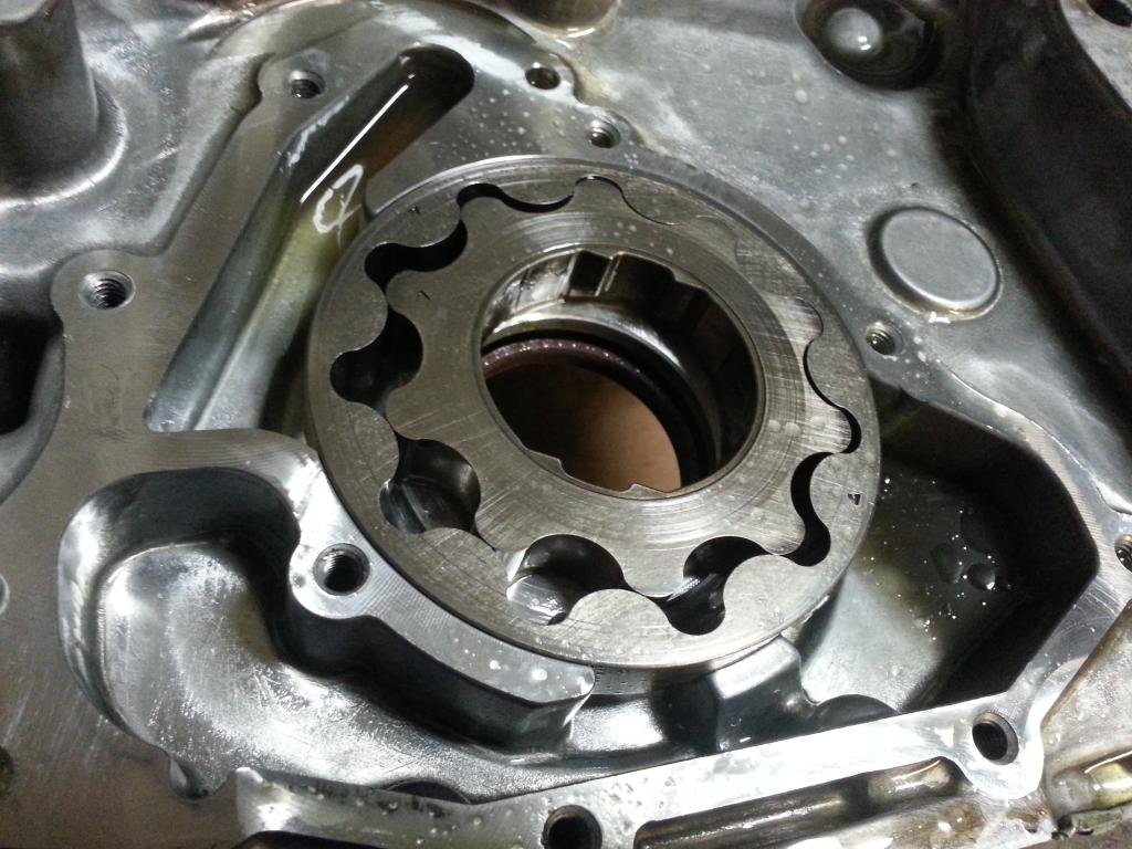

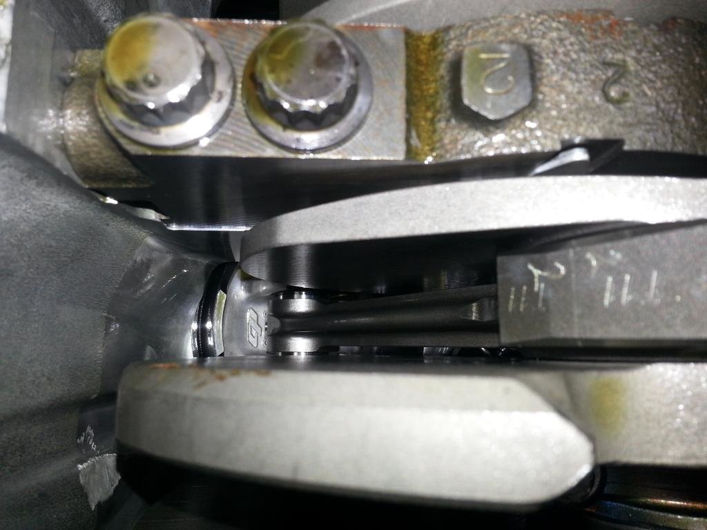

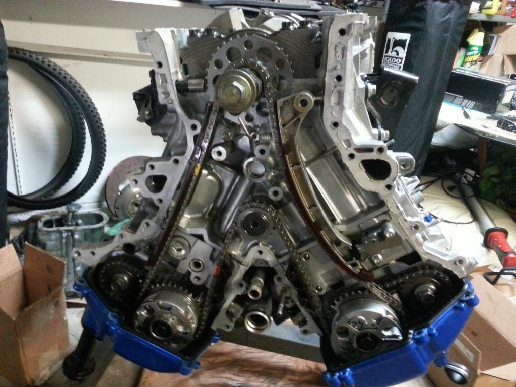

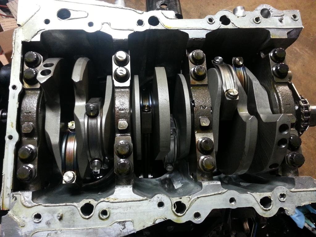

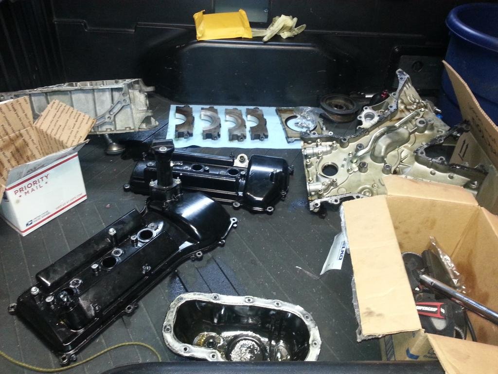

    Pulled some of the components apart to inspect the built engine. Trying to find where these aluminum shavings all came from. Which are visible in the lower oil pan here.
    I still haven't yet removed the two rod end caps from the other two rods which show massive heat saturation. Those bearings could still be the culprits. I had thought there might be some damage to the oil pump. I was surprised that it looked perfectly fine when I removed it and inspected it closely.
    More to do soon, as this is where it is currently.
