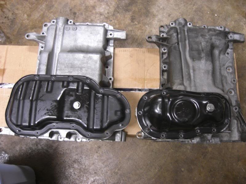

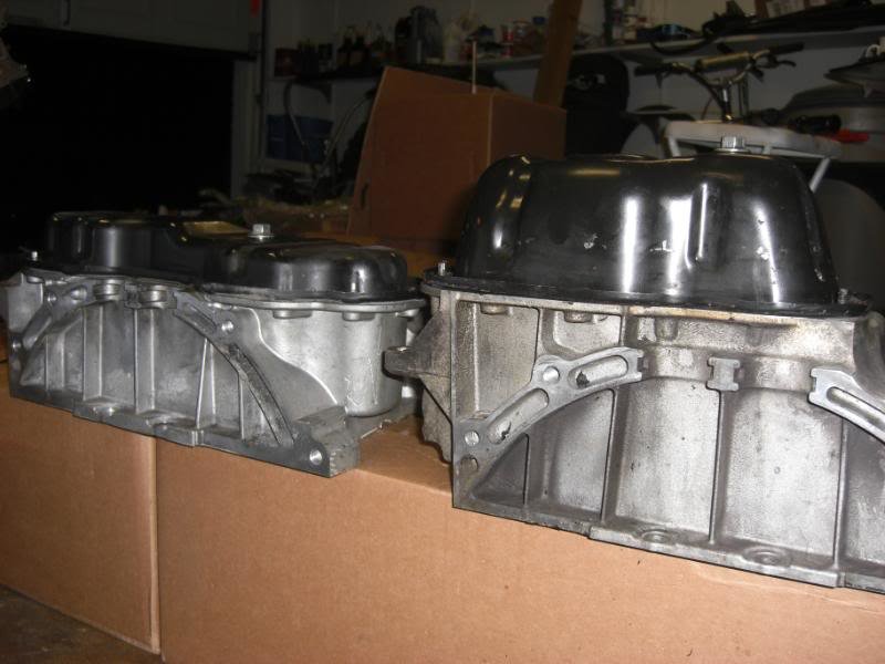

    I remember reading some information you posted that there were a couple different oil pans for the 1GR... What were they? It's easier to ask then to dig through all the info in your build. :eek:
    Thx!

    4x4 / PreRunner and the shallow, which is primarily on Xrunners, but also some base model V6's.

    What year T4R has the 1GR? I think my donor pan came from one.

    03+ runners have 1gr. Not sure when they stopped

    ^^^^ Correct.

    Here is a side by side.

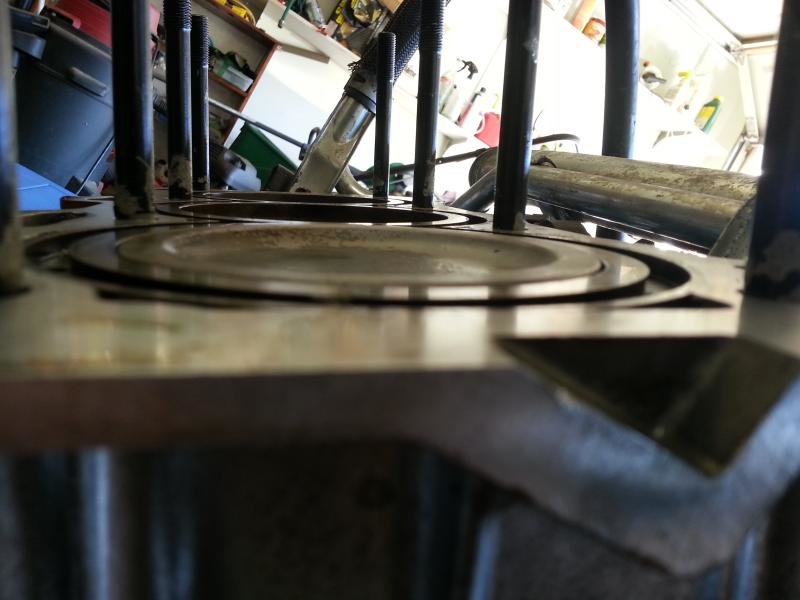

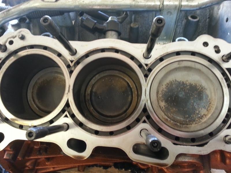

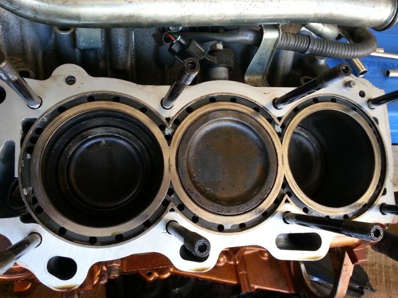

    Finally took some time to pull the heads off of the engine which I purchased from DoubllD. Dan, respectfully, we see why you had problems. Even the problems which you overcame, still left more to deal with, which would have sooner or later revealed themselves.
    I'll start with the pistons first, although that was the second issue we found.
    It isn't very much, but they protrude above the deck. More than likely due to the machining of the deck. That fact alone, if not accounted for by increasing the thickness of the head gasket, would have raised the compression ratio from the 9.5:1 that those pistons were machined to be, to something higher. Timing could have then been too high, if it was thought that the compression was one ratio, but actually another.
    Then, comes the next issue.
    Whoever machined the decks, did a pitiful job. Painfully. It is no wonder you had head gasket issues. I only found one spot where I could feel no difference between the deck of the block and the edge of the sleeves, where they meet. Everywhere else, the sleeves were on a higher plane than the block. Thus there is a sealing issue that could not be avoided. I don't know if it was APR or another machine shop who did that, but any Joe could have felt that and known how bad a job was done by the machinist.
    Then, there was either something going on with the tune, or a combination of trying to tune with a possible head gasket issue. As the driver side piston crowns are clearly darker than the passenger side. Let it be noted that the driver side deck had a lot worse machining than the passenger deck.
    Still have further to check into the engine, but there is a good sign. The heads are in good shape. This engine will have the decks re-machined, likely one head which has a couple of tiny marks on it, and if all else is right, be back together stronger and correctly.
