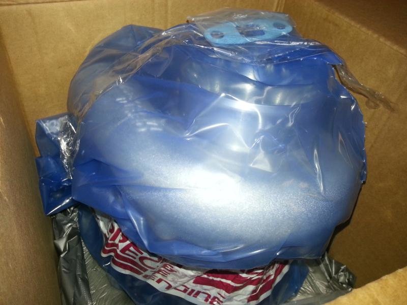

    All I've got for now.

    Nice snail in a box :cool:
    Matches my turtle in a box. :eek:

    A different turbo? I thought you already had the turbo you were going to use for the build:confused:
    I'm seeming to recall you sending it in to have some work done or something, but I can't quite remember... haha

    This is my "get me by" turbo. Basically the same as the last Precision. The whole exhaust setup doesn't have to be re-fabricated for this to fit under the hood. Whereas with the BW, it does. This will get me by until that time comes.

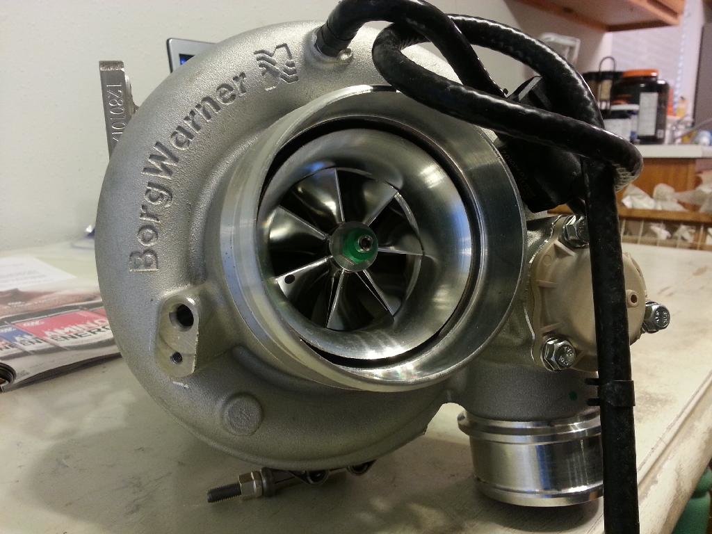

    what efr you going to run?

    Which BW EFR? The 9180. It is just to tall to fit under the hood. So the whole of the exhaust will have to be re-fabricated.
    Then this kit will be for sale. :cool:

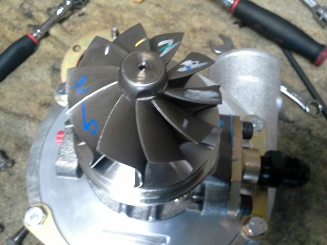

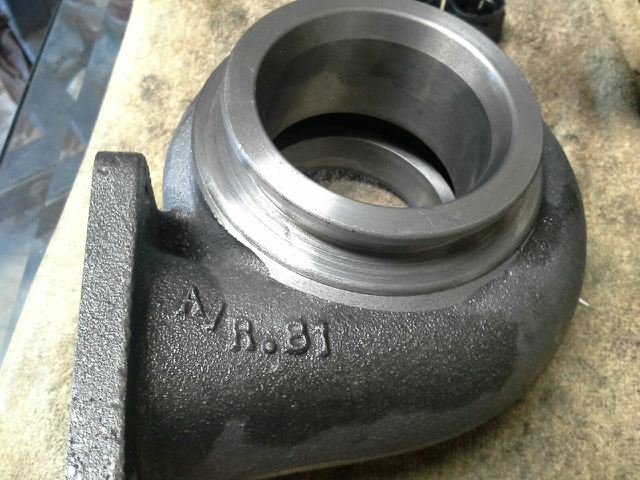

    Torspd Custom Turbo kit [] Borg Warner 9180EFR Turbo [] Haltech Elite 2500 [] TiAL Q BOV [] TiAL V44 Wastegate @ 15psi [] CP Pistons [] CP Carrillo Rods [] ARP Head studs [] ARP Main Studs [] ARP Header - Head Studs [] Ported Heads w/ 1mm oversized valves intake/exhaust [] Brian Crower Forged Stroker Crank [] Darton M.I.D. Sleeved Block [] Kelford Camshafts [] Torspd 160* T-stat mod [] APR Large Fuel Rail [] Walbro 460 LPH E85 Fuel Pump [] FueLab FPR [] APR T56 Conversion Kit [] KP RACING Built T56 [] McLeod Racing Custom Twin Disk Clutch [] One Piece Aluminum Driveshaft [] MGW Shifter [] Custom lowering kit [] Ohlins Front Coilovers [] QA1rear shocks [] Custom Ron Davis Radiator [] Dual SPAL Electric Fans []

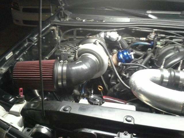

    New 6266 with 4" ported shroud inlet, 2.5" outlet, T4 tangential inlet, 3 5/8" v-band outlet, .81 A/R.
    Versus the .68 A/R on the older version. Keeps the heat down just a little.

    Awesome mate. Makes me look forward to the cam swap this weekend....

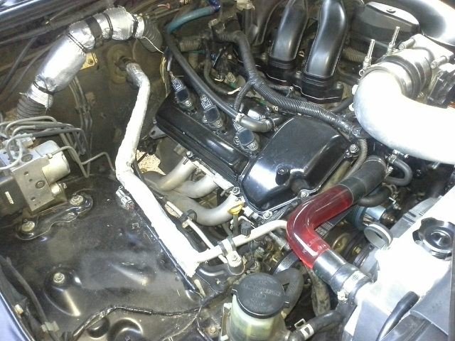

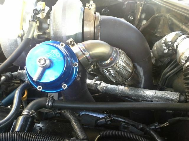

    The work is done. I cannot express how truly strong and tuned the exhaust sounds now...... A combustion symphony!
    Now I need to pull it apart and heat wrap everything.
